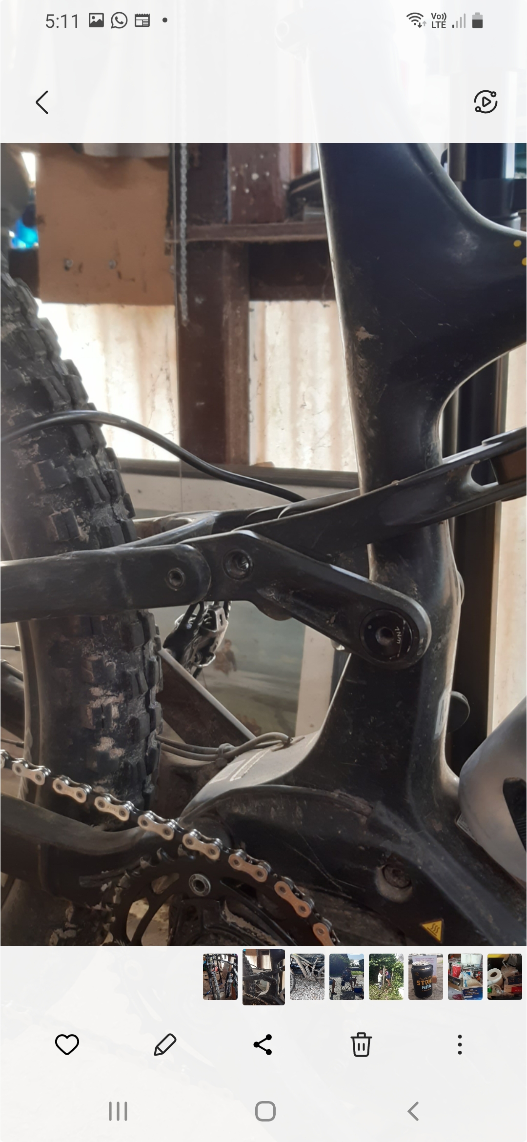

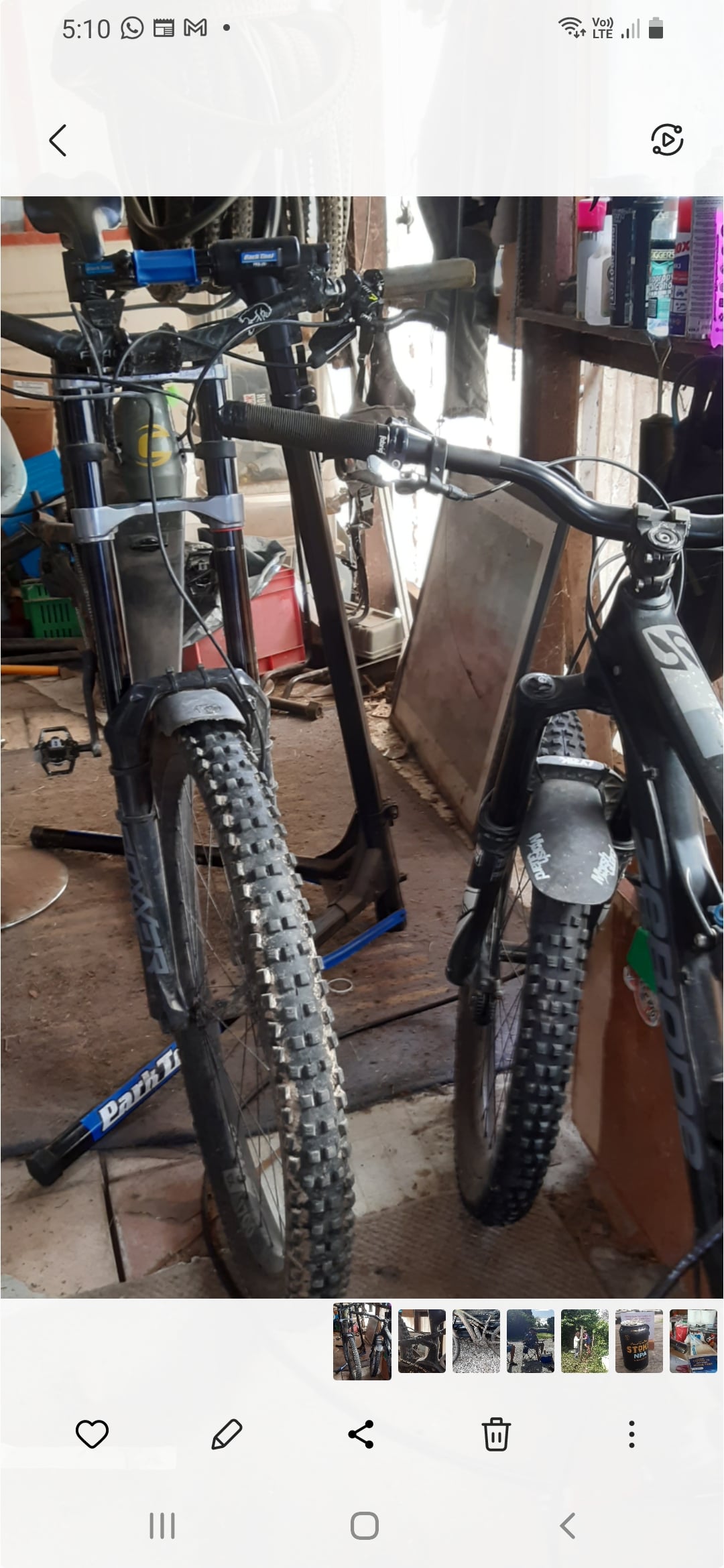

The lt looks great but I think I am happy to stick with my 2020 moterra . Mulleted with a boxxer fitted. Rides great but looking for a way to get more rear travel just to help balance it out a bit. Currently 200 front 160 rear. It's pretty bloody good but reckon It could be made even better

Found a way to get 185mm on rear. It's a magic carpet ride now. All that was required was a pickup link from a acoustic habit and voila. I can't imagine a better riding bike. Bottom bracket height is at 160 which I think is a sweet spot. Head angle somewhere between 63.5 and 64

Can you put up a photo?

First shot shows the pick up link from an acoustic habit which increases travel from 160 to 185mm 2nd shot shows boxxers at 200mm
