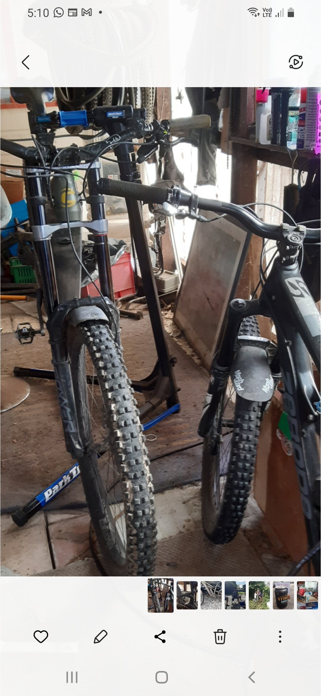

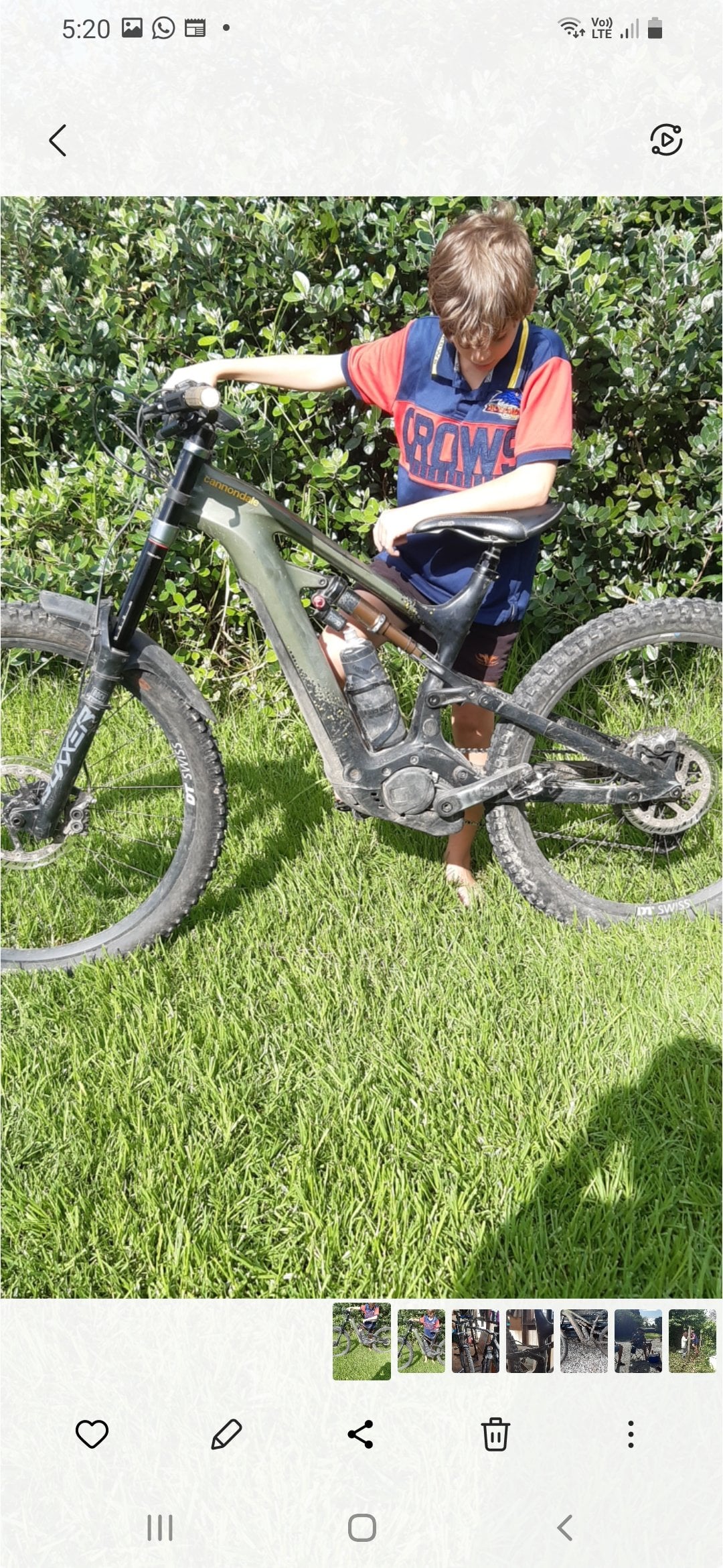

The lt looks great but I think I am happy to stick with my 2020 moterra . Mulleted with a boxxer fitted. Rides great but looking for a way to get more rear travel just to help balance it out a bit. Currently 200 front 160 rear. It's pretty bloody good but reckon It could be made even better

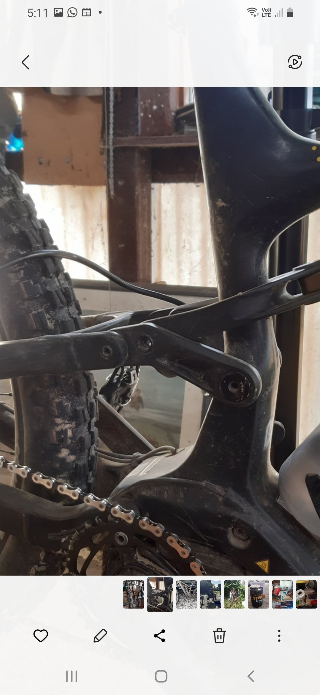

Found a way to get 185mm on rear. It's a magic carpet ride now. All that was required was a pickup link from a acoustic habit and voila. I can't imagine a better riding bike. Bottom bracket height is at 160 which I think is a sweet spot. Head angle somewhere between 63.5 and 64
Found a way to get 185mm on rear. It's a magic carpet ride now. All that was required was a pickup link from an acoustic habit and voila. I can't imagine a better riding bike. Bottom bracket height is at 160 which I think is a sweet spot. Head angle somewhere between 63.5 and 64
Can you put up a photo?
Can't remember how. I will sort it out later and post photo. Senility sucks
First shot shows the pick up link from an acoustic habit which increases travel from 160 to 185mm 2nd shot shows boxxers at 200mm
