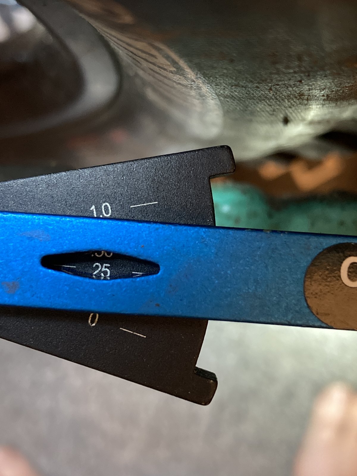

Interesting experiment with chain life
1,500 miles
Only using GT-85 on the chain

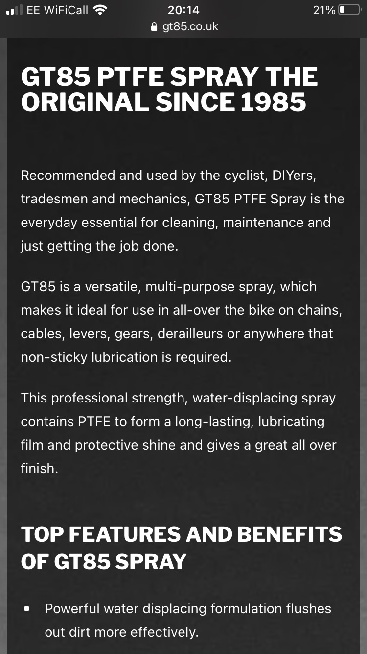

l am sure other spray lubricants would work, l bought a similar one from my LBS. l guess it just needs to be a PTFE based spray
Is it actually lubricating the chain do you think? I assumed it was adding a thin layer on the surface to stop rust and stop dirt from sticking?
l spray it liberally on the chain from close range, so it will be getting into the link bearings
lt's sold as being suitable as a chain lubricant

l've never had a rusty chain using GT-85 and l've ridden in torrential rain. l am getting towards 0.5 on my chain now, and will keep on with the test to see what happens.
l bang through the gears without getting off the gas, tbh when accelerating on the road it's difficult not to because the E8000 runs on for a second after you back off pedalling
Hi @lightning , What chain model are you using? Did you de-grease the chain before it's first use? I've been using squirt wax lube on my recent ebike chains and have got a maximum of 1500 miles before passing 0.5% wear. Keep posting your updates!
Hi there no l didn't de grease the chain when l fitted it.
lt looks like l am going to get around 1500 miles from the chain, around the same as you.
