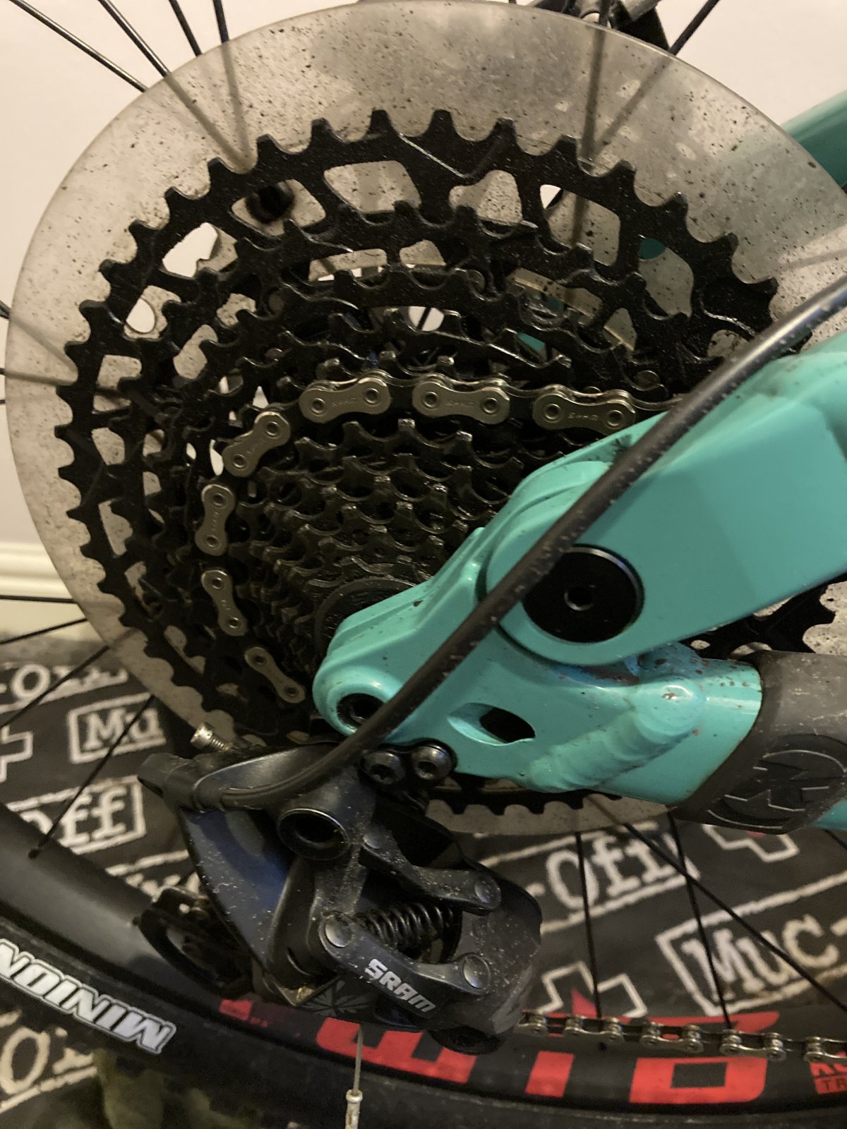

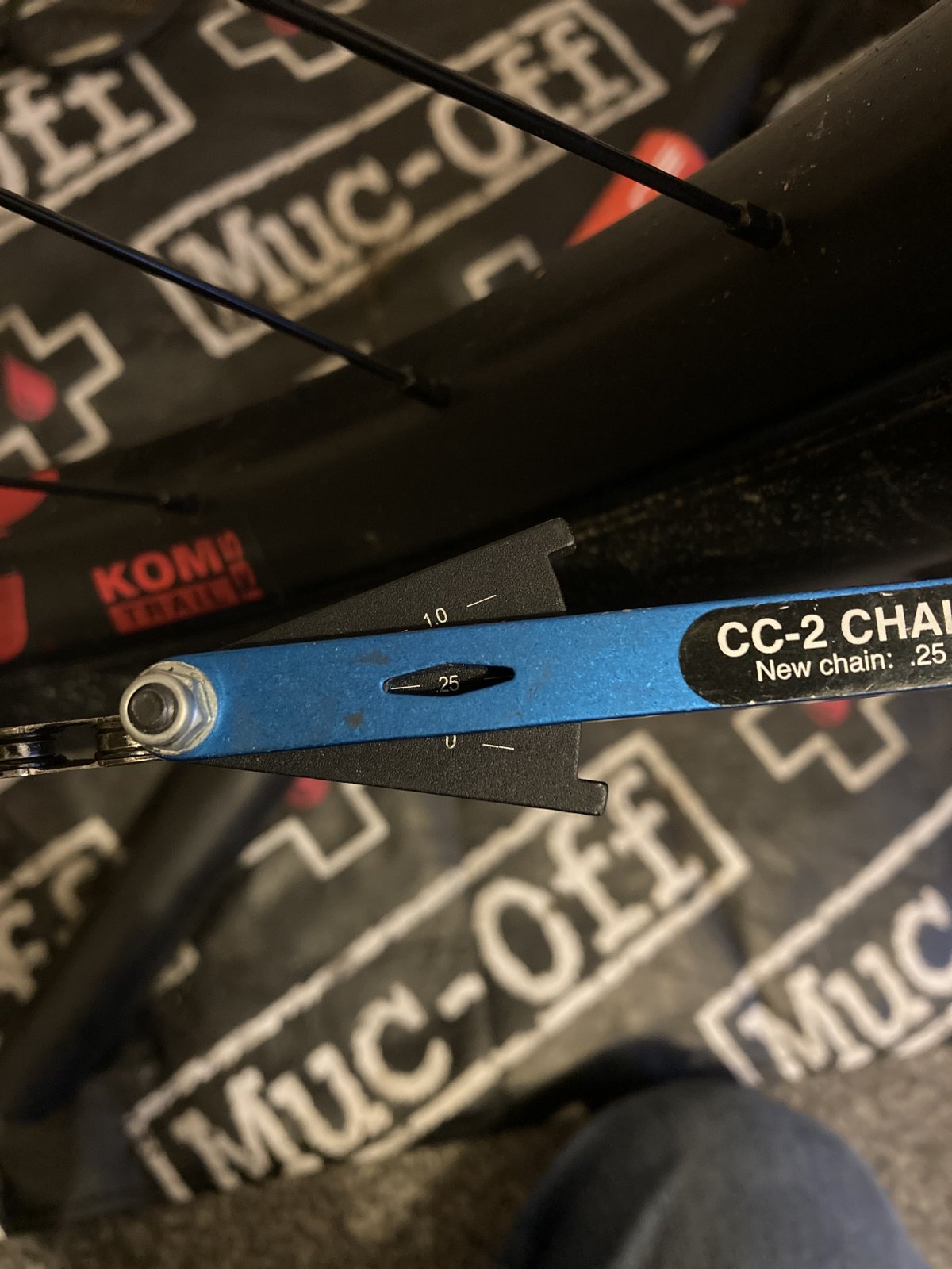

Okay, the bike is now on 2,400 miles
which is 1,000 miles on the new chain, lubricated only with GT-85 every other ride.
Chain checker says 0.25 so there's no measurable wear after 1,000 miles.
ln addition the drive train and chain are still clean, and not covered in black gunge from oil.
The experiment continues
l remember back in the 1990's when l was on a MTB weekend with a friend, he was using GT-85 on his chain and l thought "all that will do is stop it from rusting"
Maybe my friend was on to something all those years ago.

Well, nobody is picking up on the fact that l've now done 1,000 miles on a single chain and there's no measurable wear.
Also the cassette is still fine, l tried a new chain on it yesterday just to check if it jumped in the high gears....it didn't.
I am using the cheapest SRAM chains l can get, they are around £30

Now 1200 miles of only using GT-85 on the chain
Weather here is pretty bad at this time of year, so most rides are muddy/wet.
Last nights was no different.
Drive train has remained clean because there's no sticky oil being used, although l would have been looking at a new cassette by now probably and a third new chain.
After every ride in this weather, followed by wiping off the excess while turning the cranks (bike on a workstand)
l spray it onto the chain from about an inch away while it's going round the cassette, so any excess just ends up on the cassette
