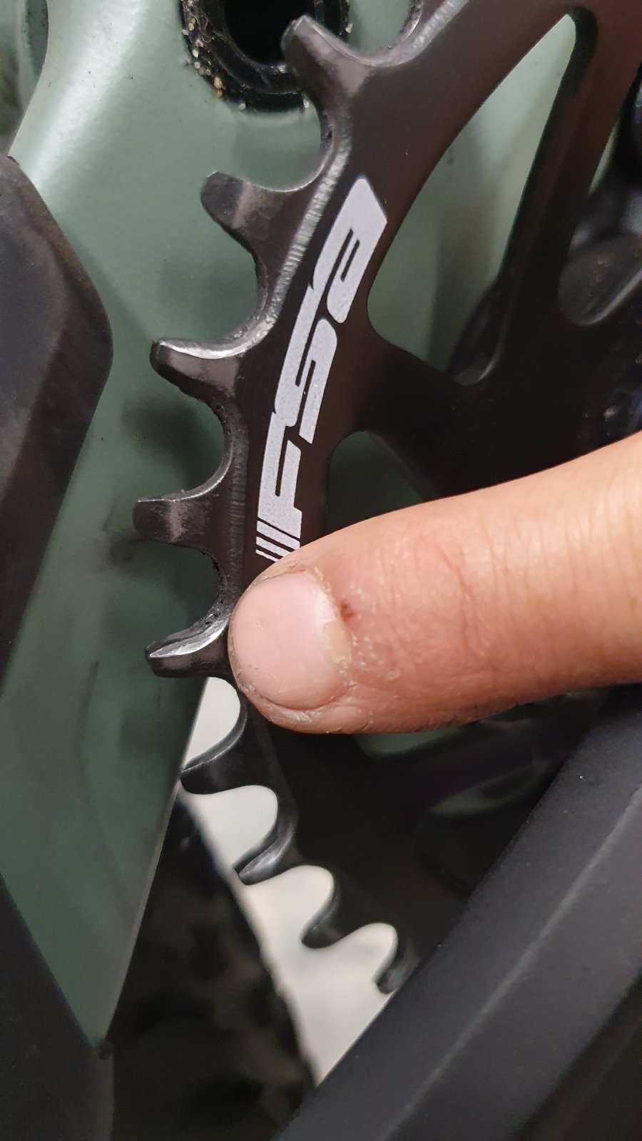

I'm having some troubles with the stock FSA chainring on my Thron 6.9. I think Focus is using non-optimal parts on this bike (also noticed they use the same chainring on Shimano drivetrain Jam²)
On my new Thron2, with a FSA G4 34t megatooth chainring, When pedelling uphill mainly off-road(especially on grass), and putting pressure on the pedals, it makes a noise from the chainring and a sensation through the pedals. After closer inspection it appears the chainring isn't letting go of the chain properly causing a bit of 'chainsuck'. The problem comes and goes a bit, the video below demonstrates it at its absolute worst:
Focus sent me another FSA chainring this time instead of a direct mount it was a 104bcd attached to a spider. Same tooth profile, same issue straight away. The chain was also replaced at that time.
I believe that focus isn't using the optimal chainrings on the Thron/jam for the Hyperglide+ chain. FSA megatooth chainrings are made for 1x11, not 1x12, and Hyperglide+ chains are especially picky about the chainring tooth profile.

So I have high hopes that when I pick up my bike this week that the issue will be resolved and the pedaling will be a lot smoother. You can see in this picture the wear on the wide teeth. This is the spot where the Hyperglide + chain inner link comes in a bit.

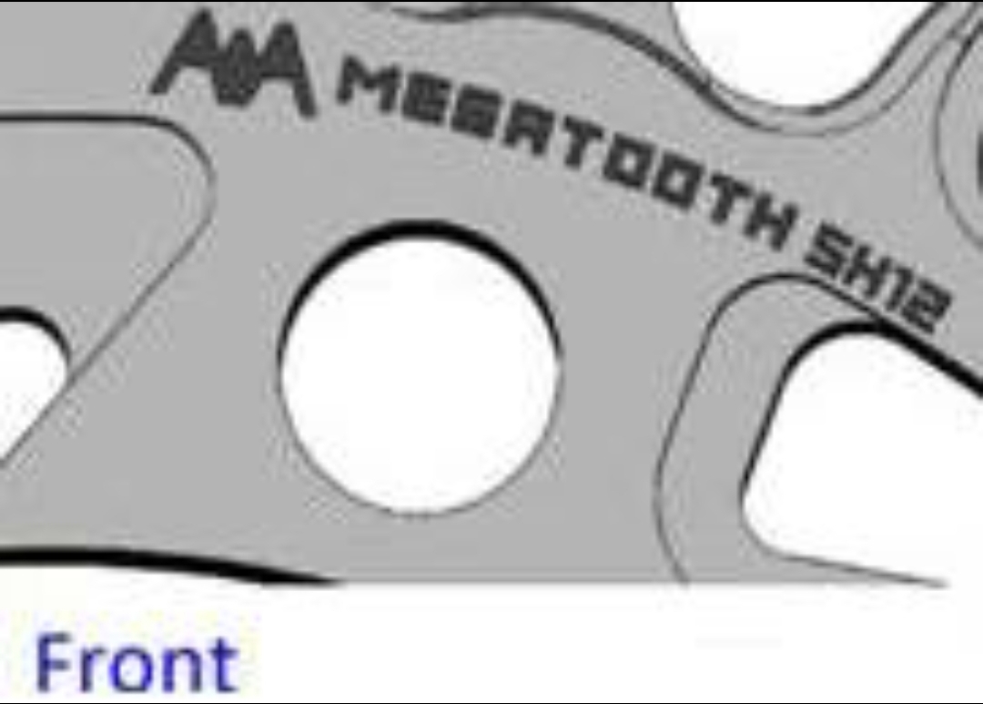

After emailing FSA they informed me that only the megatooth chainrings with 'SH12' designation printed on it are compatible with Shimano 12 speed chain. So the plain FSA megatooth chainrings are not optimal and may cause extra chain wear/chain suck.

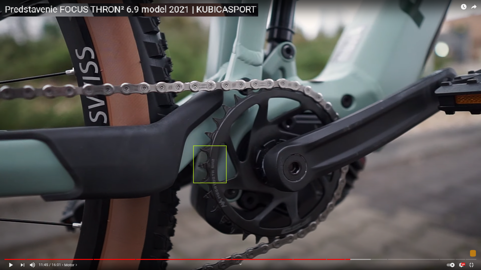

*edit* few months later, i can confirm that the bikes are now shipping with the correct SH12 chainrings. However still the models i see in my local store have the old chainring. So might want to double check what you've got.
This is a screenshot from a youtube video of a 2021 Thron with the new update chainring. Check out how different the teeth profile are! And clearly you can see why the existing chainring was a problem..

Yes, I think that is exactly the problem. I spoke directly with FSA and they told me that only the megatooth chainrings stamped with "SH12" are compatible with shimano 12 speed chains.
And so the Shimano 12 speed specific inner link on the chain catches on the too-wide tooth under load, causing it to not release smoothly.

They said to me "You may ask your bike brander to send you megatooth with the marking SH12 which will solve the current problem." And also provided the picture above with the "megatooth sh12" imprint. :unsure:

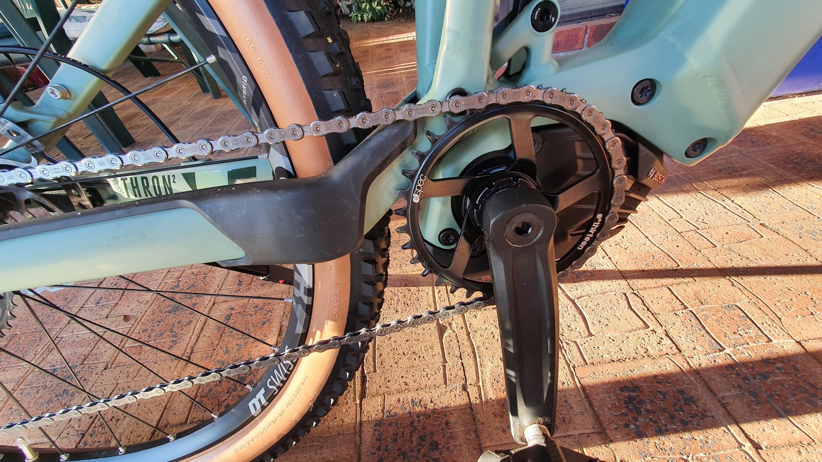

So I got my bike back today from my LBS and they fit the E*Thirteen E*spec steel Bosch gen 4 direct mount chainring.
It has completely resolved my chain suck issue. It's honestly like a whole new bike. Pedalling uphill I feel a much better connection between myself and the bike. It is much more pleasant.
The original chainring is an FSA WB459 which FSA confirmed does not support 12 speed shimano.
Here it is:
