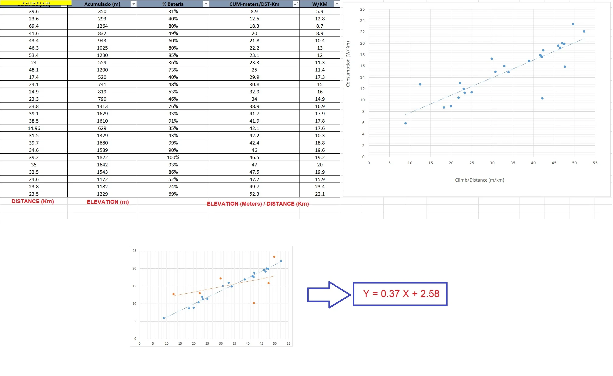

Power consumption is a linear function if you take power consumption on Y and the ratio (distance/elevation) on X.
NOTE: for "samish" average speed.
I did several TURBO rides, meaning values will equate to maximum battery consumption.
I'll edit this post later today, with my powerconsumption equation.

I have limited time on my CXR motor due to injury, but I'm using more than I thought that I would. Elevation isn't that much around here, best I can get is about 125'/ mile, however it's extremely rough and rocky. Weight is 82 kgs & bike is 22kgs (yes, I know I used both STD & Metric, that's where us Americans are now). I seem to use right at 250wh/ hour of ride time.
I gather some informatiin and placed into tables to produce graphs.
Basically, you need to record Battery Consumption, Distance and Elevation --> basic data.
So that you have consistency, I would use always the same mode, and putting as much effort as possible.
[EDIT]
You can also verify the power consumption using other modes, you can do like 3...4...5 rides, with different elevations and distance (basically you want to have as much elevation/distance ratios). Plot that data into the graphs, and check the slope of the linear equation. You can do shorter rides, but preferbly on the same Ratio. Eg: set a ride with a ratio of 15m elevation for each km ridden. Do like 10km and store battery consumption. Then do another ride with 25m/km...then 30..40...50... and easily you'll get the power consumption and can determine range on any type of terrain.
This is very useful if you do races (without battery swap), or have a ride in unknown location
Battery consumption: I used Flowapp to determine the % of power consumed. I've used a 750Wh for all these tests.
Distance: I measured in Kms - you can apply miles, no issue.
Elevation: I measured in meters - you can apply ft.
The ratio between Distance and Elevation is done by using meters and kms --> I didn't converted to the same units.
Afterwards it's just a matter of finding the line that passes through most points (or closest) - you can use Trendline in Excel.
And then, just use the y=mx+b and find slope --> look at google.
As a thumb rule, just use:
15 to 20 meters of elevation per km = ~ 9W/km --> Range: Battery Size / 9W/km = 750Wh/9 (W/km) = 83,3km & ~ 1250m elevation
20 to 25 meters of elevation per km = ~ 11W/km
30 to 35 meters of elevation per km = ~ 15W/km
35 to 40 meters of elevation per km = ~ 17W/km
40 to 45 meters of elevation per km = ~ 19W/km
45 to 50 meters of elevation per km = ~ 21W/km --> Range: 750Wh/21W/km = 35,7Km & ~ 1600m
It may seem complicated, but it's not and really helps on determining the routes to ride, on places I don't know.
NOTE:
This data, is for a rider weighting around 88kg naked, a ebike with CX4 and restricted to 25km/h, and all rides were performed using Turbo and really forcing pace.
The main goal, was to determine real maximum power consumption, and from there determine routes on unknown areas to elaborate GPX and following with GPS.
Using other modes, such as Tour or Eco, will lead to greater range.
hope it helps. Cheers!

I gather some tables and graphs.
Basically, you need to record Battery Consumption, Distance and Elevation.
NOTE:
