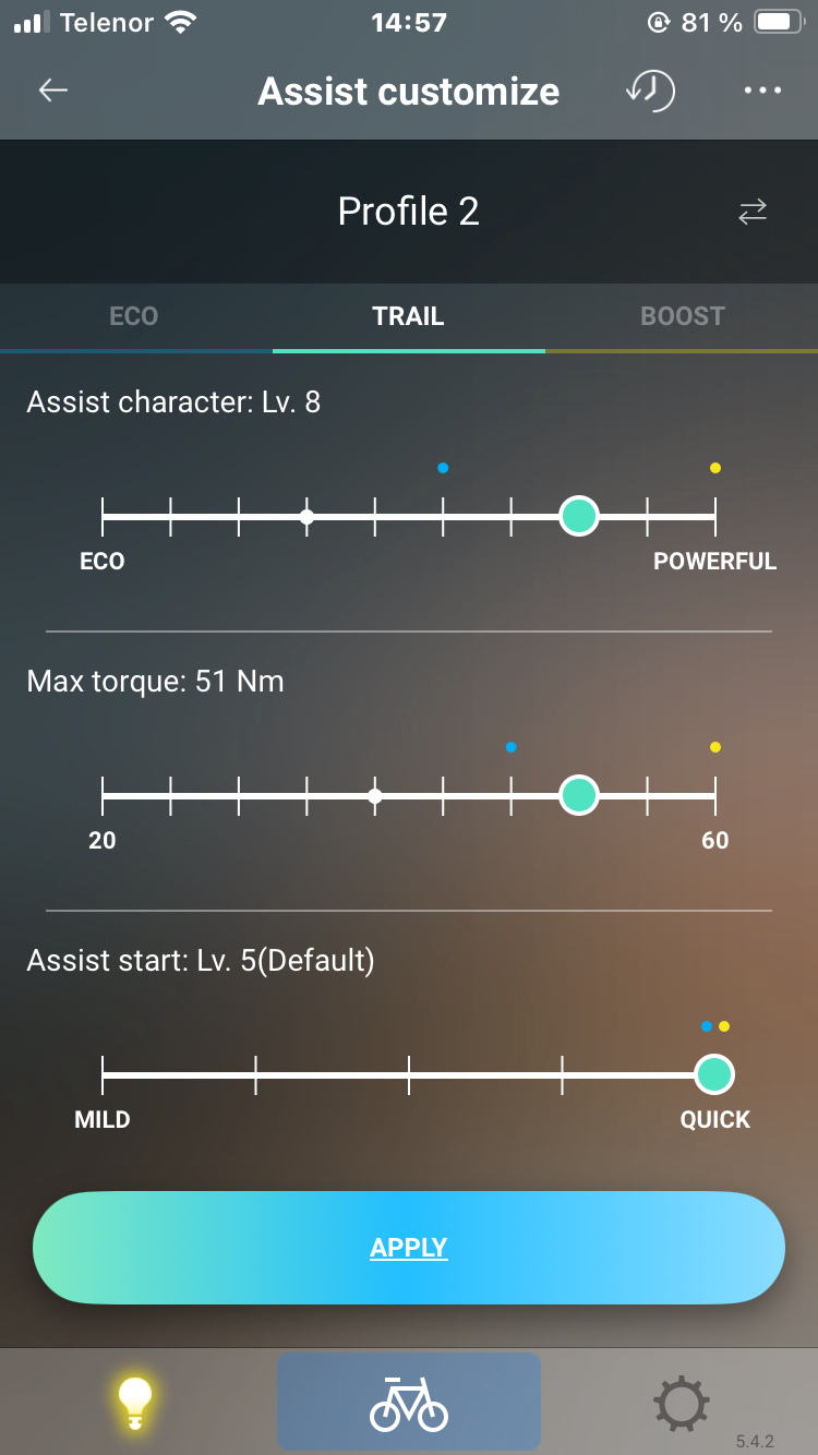

I used my Profile 2, which I had set up to be very aggressive, see attached picture from Shimano's E-Tube app.
The pic shows the Trail mode, with blue and yellow dots showing the Eco and Boost modes, respectively.​
White dots (not easy to see) show Shimano's defaults for the Trail mode (as implemented in Profile 1 on my bike)​
On asphalt roads I used Eco mode 90% of the time, since I can easily maintain 20-25 km/h. On tracks mostly Trail mode, some tricky parts Eco mode, since even Trail was too aggressive. Only used Boost a few seconds...​
Based on this trip, I will dial back the Eco and Trail modes, they were way too aggressive.

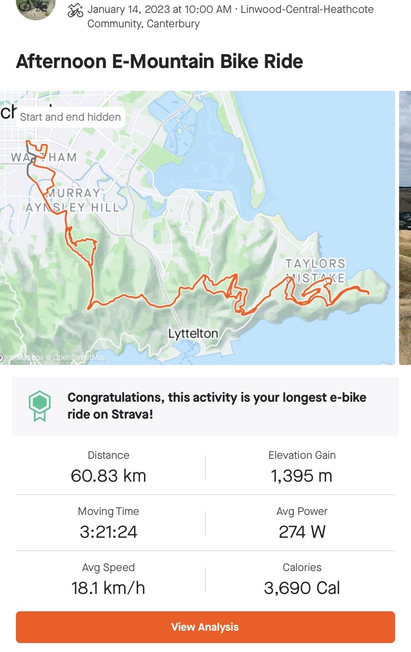

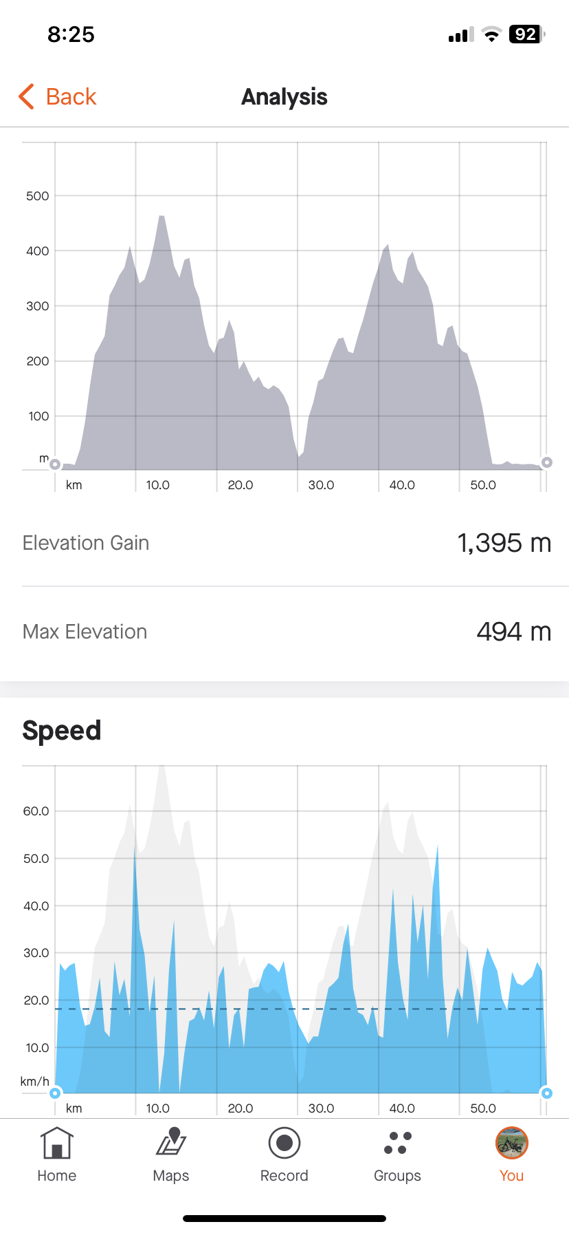

Well I jumped back into some older Data for my Rail
Bosch CX Gen 4
750wh Battery
Bike weight is 23.6kg
Travel is 160mm
I'm 110Kg
60km with 1395m of elevation over 3 1/4 hours riding. (37.5 miles / 4576 feet). Mostly Tour+ and 4-5% in EMTB (No turbo).
Came home with 17% battery spare. Range was showing another 15km in Tour+.
So by my limited calculation skills thats around 190wh per hour?
