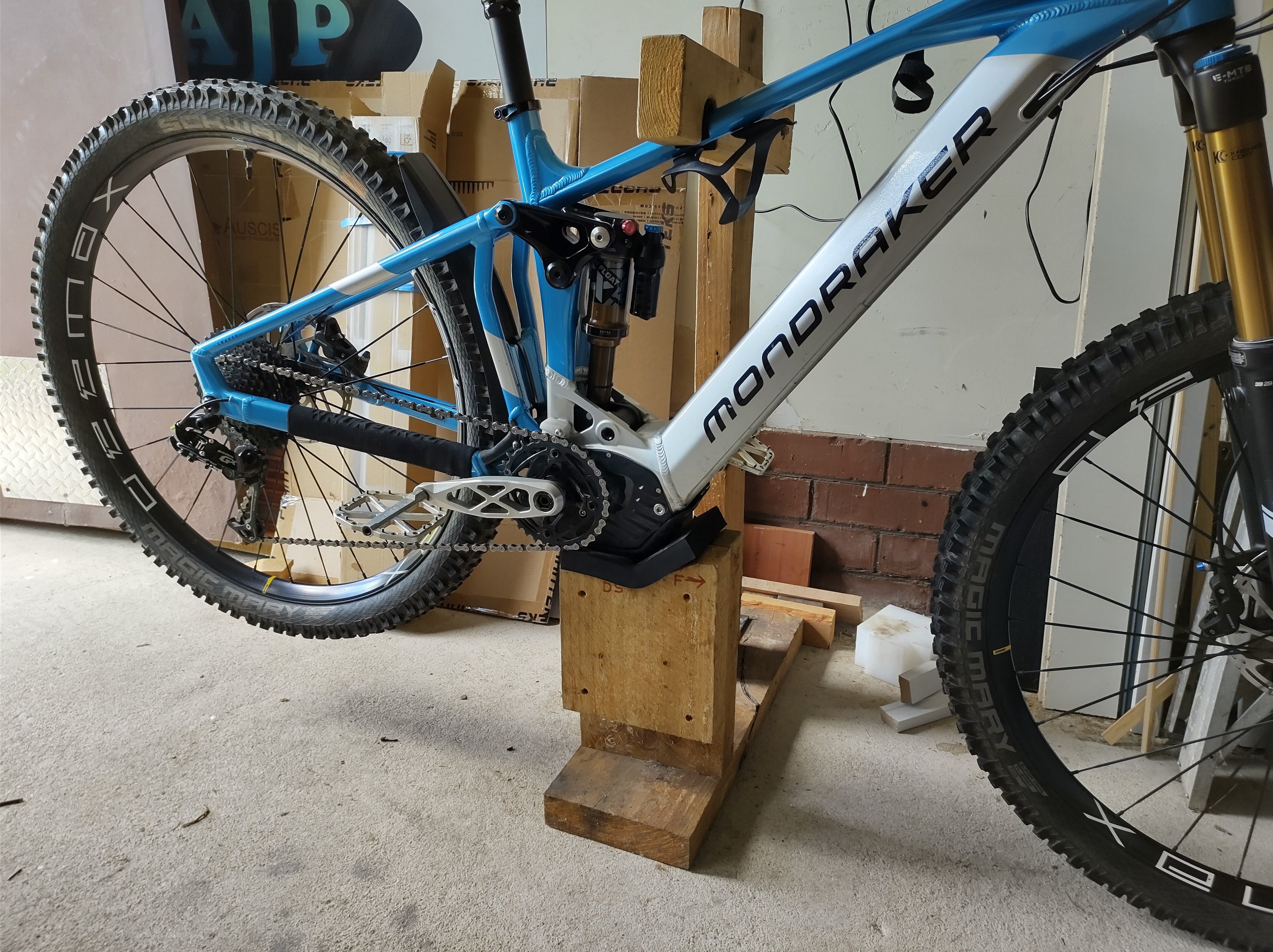

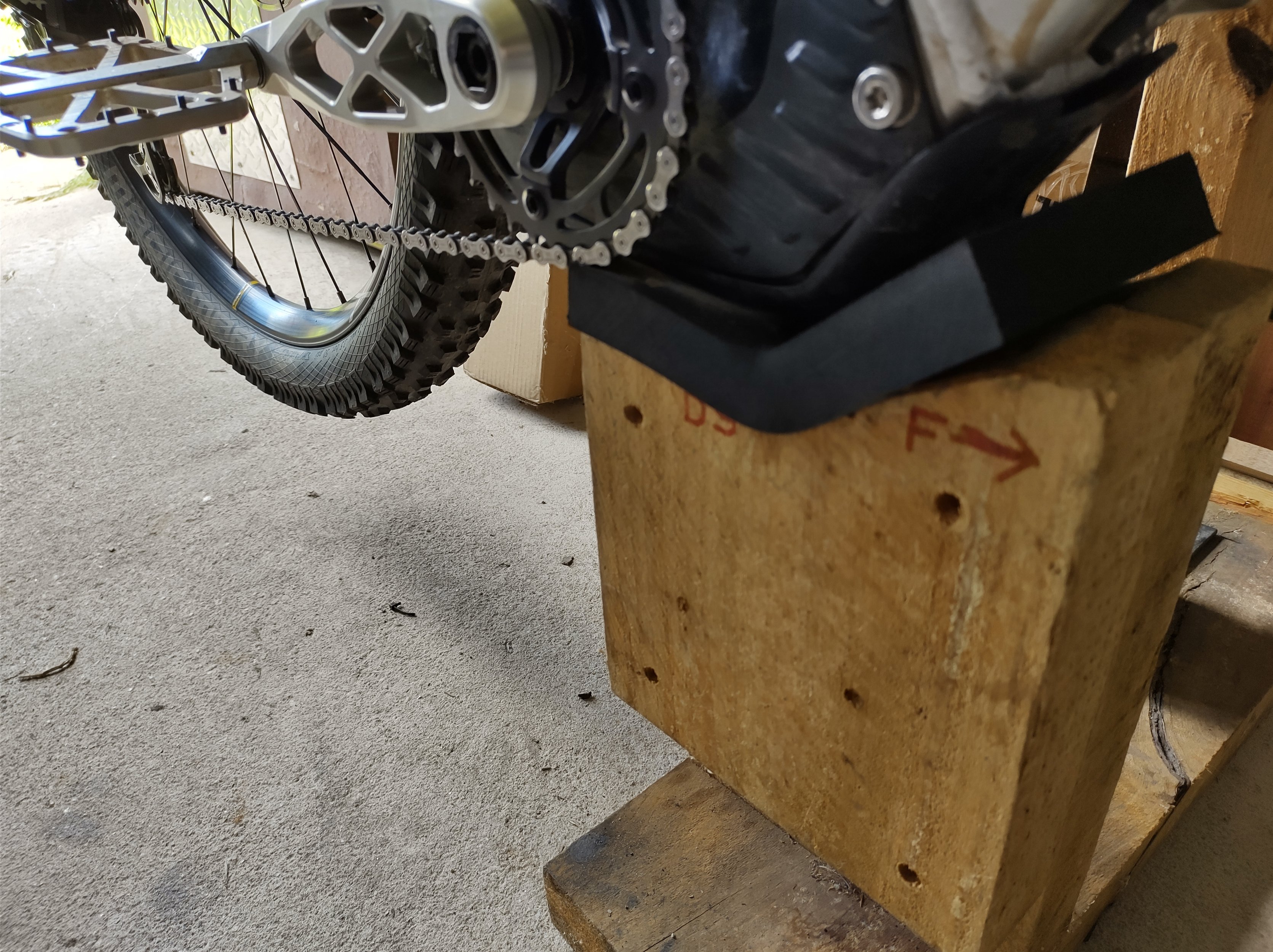

I made a couple of cheap wooden stands for the job. 1 for the front wheel and a block of wood to sit under the motor to lift the back wheel off the ground to sllow the pedals to turn cost less than a fiver.
Same. I can wipe down and lube the chain , tune shifting , even check the rear wheel for true thanks to $10 worth of timber offcuts and a couple of hours work 😁
High density foam between the base and the motor cover and the top "arm" swings up and down to balance the bike.
When I see 25kgs of ebike hanging from the upper section of a dropper post in an expensive stand , I have a little chuckle to myself.
View attachment 101029View attachment 101030
Love the look of this. Going to try making one myself now.
