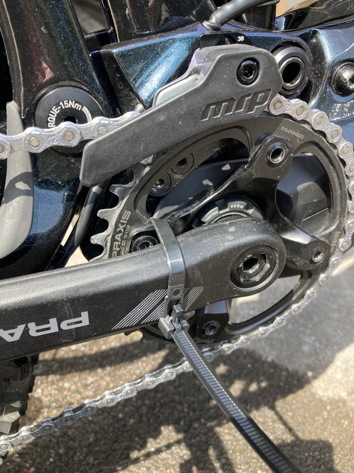

With the Trek and Bosch motor's using the allen key trick doesn't work. So I put my Trek in a bike stand rear wheel just off the floor, then apply my chosen lube which is Squirt, great stuff been using it ages, and doesn't attract all the grime some others do.
