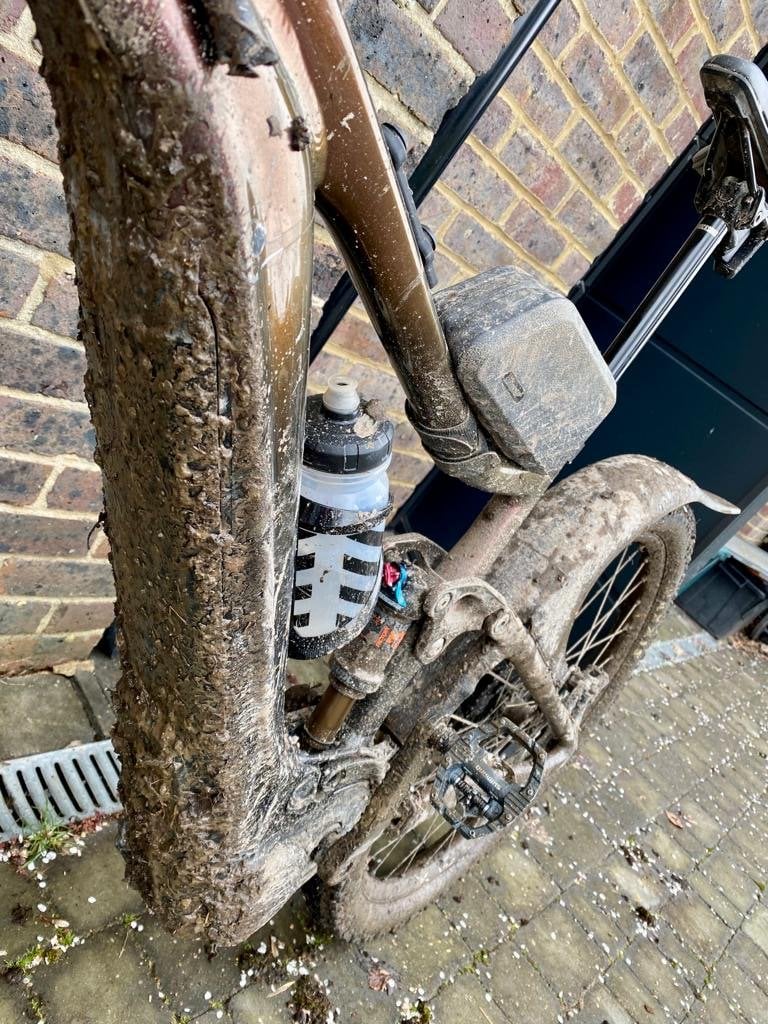

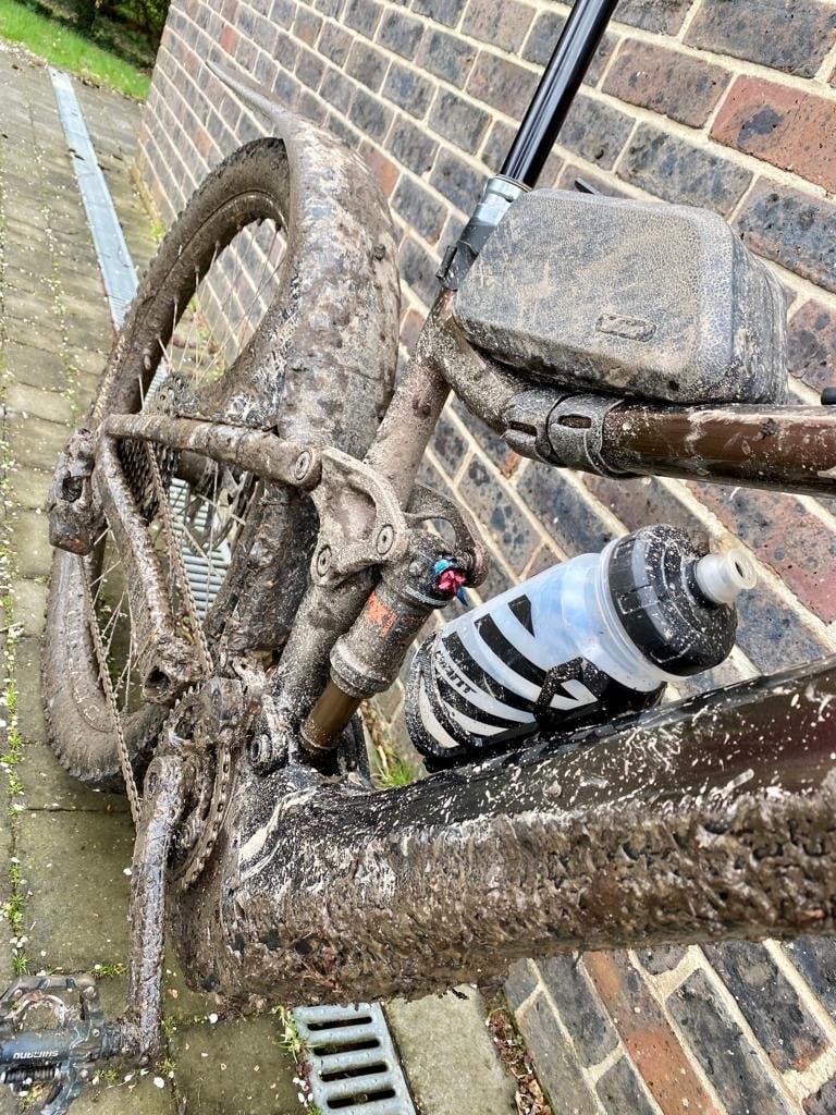

Hi, absolutely don’t be worried about getting out in the muck. I’ve done 7000k through Uk weather with zero issues. Firstly best advice is decent rear mudguard, protects your dropper and keeps you dry, I use a mudhugger for this, they are excellent. Secondly I tape over any areas that I’m likely to get water ingress from either washing or riding. On my model (21 trance) that’s the battery release catch and the hole in the frame for the torque key. Wash with hose and sponge, only area I don’t really soak is around the charging port. After washing I bounce the bike to shake off the excess then wipe over before removing the battery to check for ingress. Once I’ve done that, replace the taped areas, clean and lube the chain and it’s ready for the next mud bath 😁
Example of how effective the mudguard is for the seat and dropper
39959e37-a14b-44a2-92dc-a84db0dc2572.jpeg 92b5bc98-fcc7-458c-85a4-7ebccae978c6.jpeg 93ba49aa-7e20-4f12-9b27-1894e965bb82.jpeg
AHHAHA, that's some serious muck. Thanks for showing me! I'm still feeling a bit precious about the bike because its new, but I've gotten previous ones pretty sloppy so I know its coming.
Yup I know what you mean. When there new you don’t even want to take them out of the garage 😎
