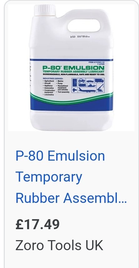

Want to get tyres on even with liners then this is all you need .
I've used it for years and haven't even skinned a knuckle
