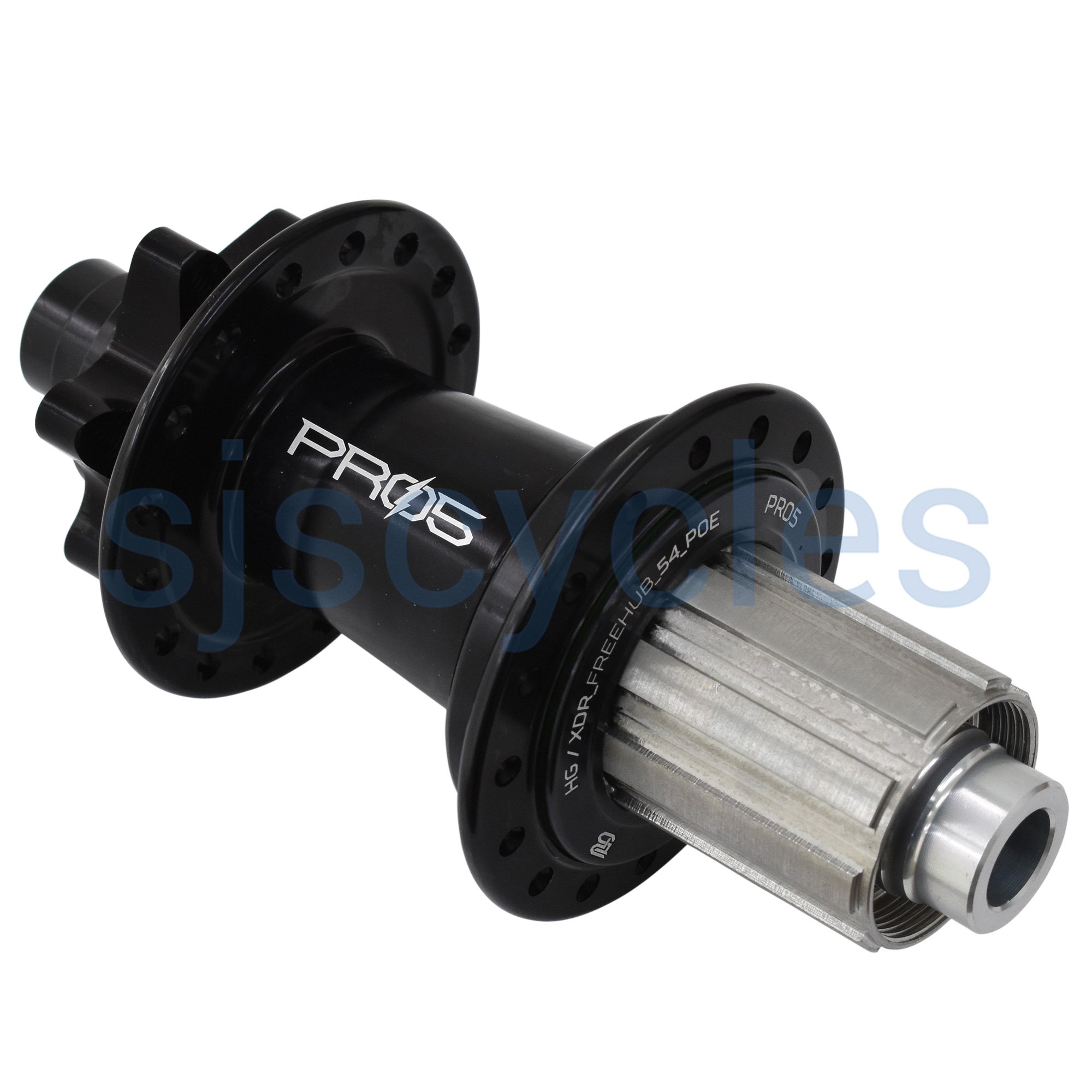

I wanted to change the regular freehub from my Pro5 to the ebike specific freehub. Its made from stainless steel & has half the POE for more strength (54 instead of 108). I've looked online and ordered the HUB557. But when I installed it, ive noticed that the pawls engage offset, not all at the same time like it says on the website. When I further compared them they weight exactly the same. Steel vs aluminum. The steel body also wasn't magnetic, so it's probably aluminum I think.
So now I'm wondering if there was the correct freehub in the packaging from Hope.
Having both, the sound is very different from the 108 to the Ebike 54. The 54 sounds like the old Pro4's rather than the angry B's of the Pro5 standard.
Does the O in the Pro5 logo on the rear anodised hub body have the lightning bolt through the O?

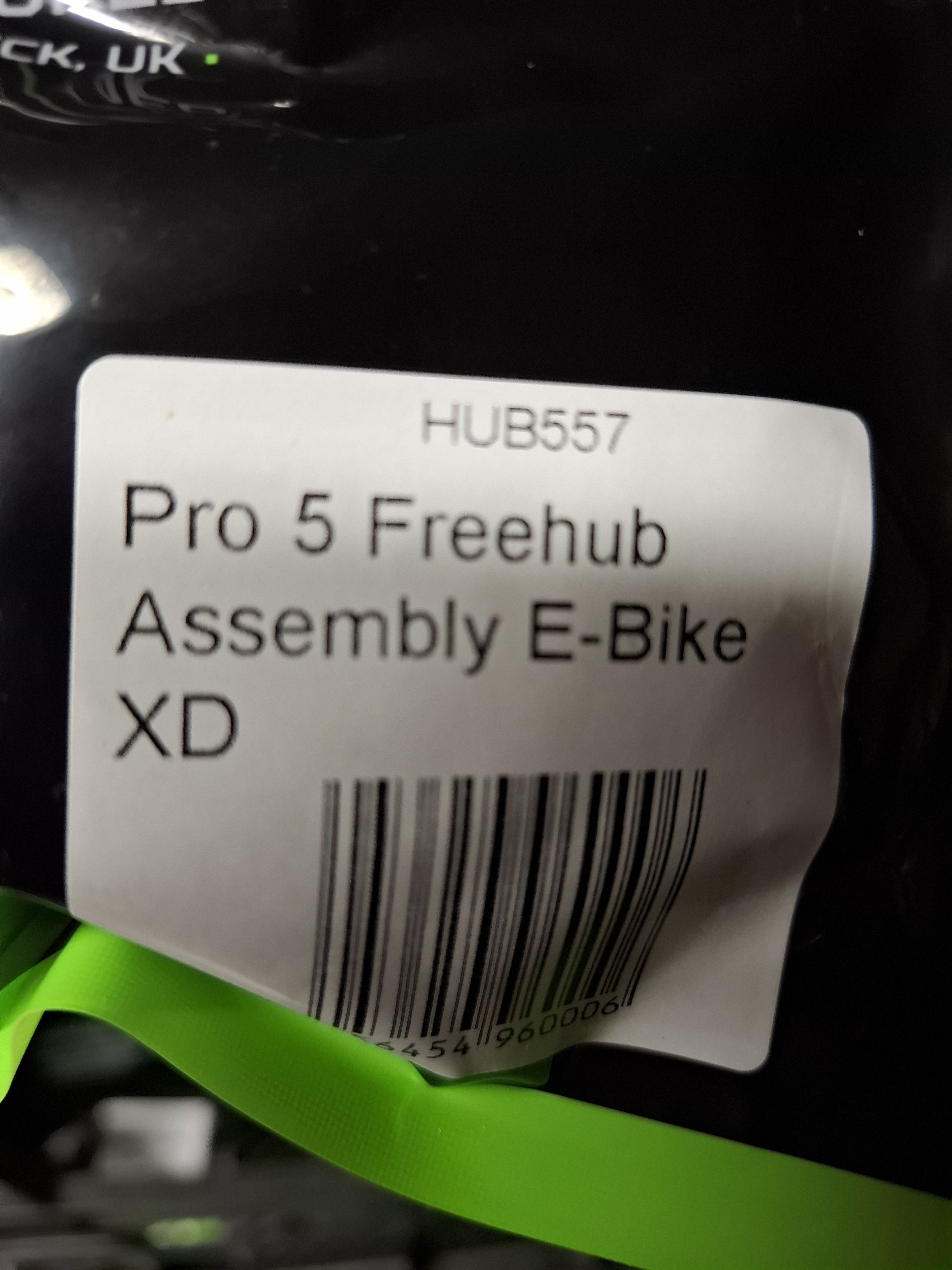

Just the freehub, not the complete hub. I think there was the wrong freehub inside the package. I checked the site frome Hope & on the package it says: Ebike freehub.
