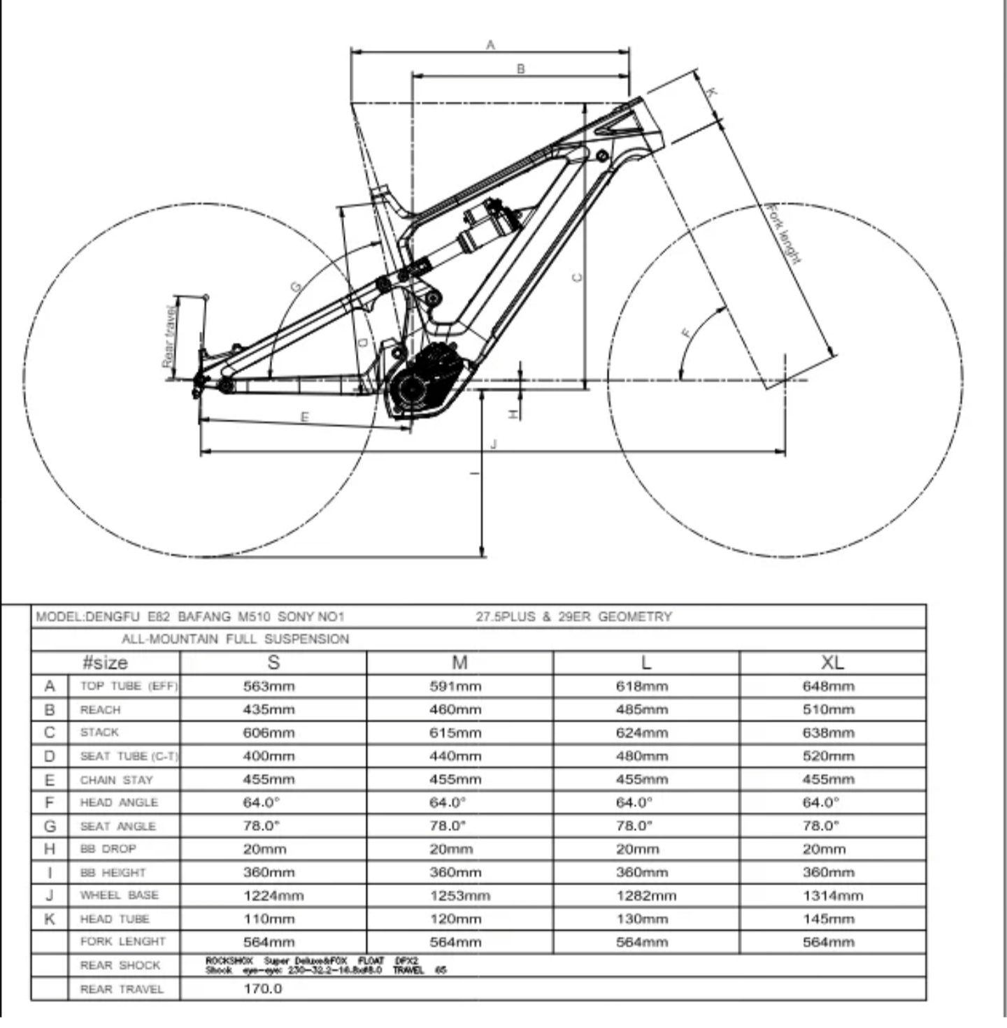

Head Angle and Seat Tube Angle are XC geometry. So 4 pot XT brakes will be just fine.
All looks good. Fork and Shock can be upgraded later. But are perfectly adequate.
Maxxix Rekon are XC tyres. So maybe an upgrade here is justified. It really depends on what sort of XC trails you'll be riding on.
All in all, a great XC bike. My only negative, is I would have chosen Enduro geometry to match your longer travel suspension. Especially if you are looking to downhill later. Geometry can't be upgraded. So it's something you need to think about at the start, when you get a new bike.
This: Especially if you are looking to downhill later. Geometry can't be upgraded. So it's something you need to think about at the start, when you get a new bike.
From the figures posted it has a 500mm rear centre (RC/chainstay length), which is very long. Given the wheelbase (and front centre and battery location) it will put a lot of weight on the front wheel. I like long chainstays, but 460mm is long on that wheelbase. Regardless of the components it will not be a happy downhill bike for sure. Maybe not even good for milder riding. Never tried a bike with even close to that weight distribution. Be wary.
Cheers.
Agree. The bike isn't going to downhill easily with that geometry.
I made that mistake with my first MTB. I thought I wouldn't do much downhill. So I got an XC bike. Invariably you start doing downhill, and the slacker geometry bikes, just give you so much more confidence. And I changed to an Enduro EMTB.
Cheers.
My bike has 462mm chainstays and it is a dh machine. It's so planted its amazing. But im also 6'3 so its good for me
But it's combined with a steep head angle. This bike is 68 degrees. Enduro is 65-66. Downhill is around 63.
If you end up not liking it and decide to change you'll lose less on that in a year than the depreciation on a high end bike IMHO, but it sounds good for your intended use - battery size, motor, suspension, brakes will be fine for XC and easy DH.
Thanks guys, all makes sense. And for Trail and XC the geometry and components should do just fine. If I get serious about DH later, I can always sell it and get an enduro and won't get stung on depreciation. (y)

If I can change the frame to something like this but with the exact same components, would it be a better all rounder?
