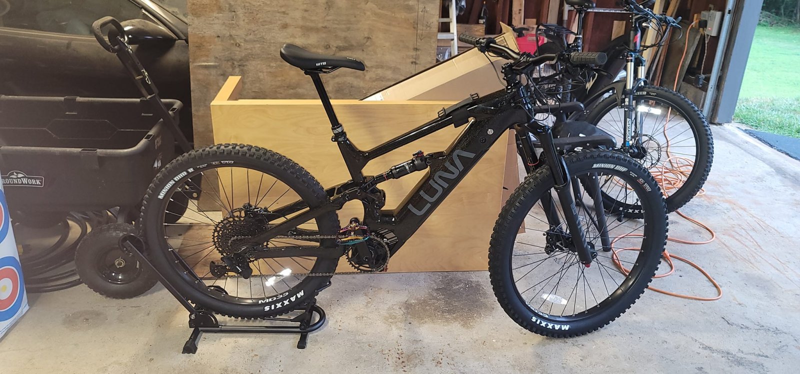

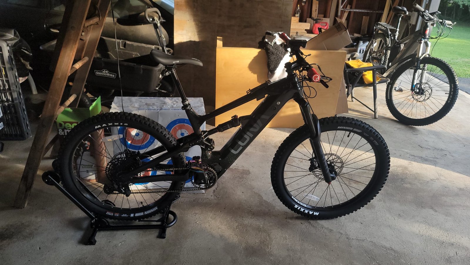

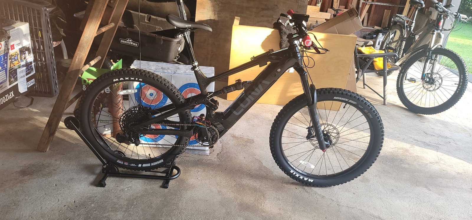

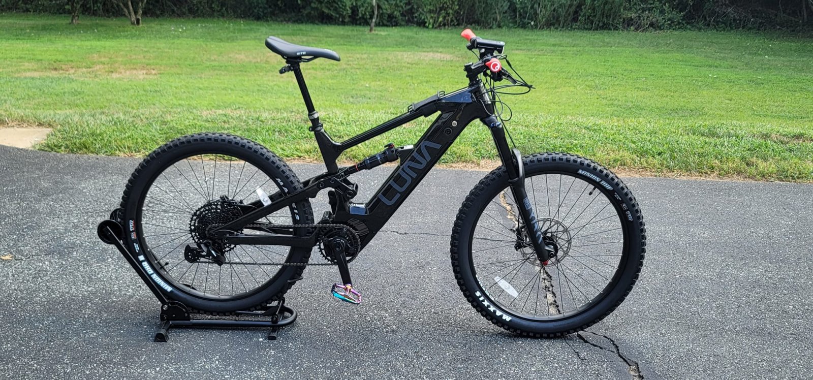

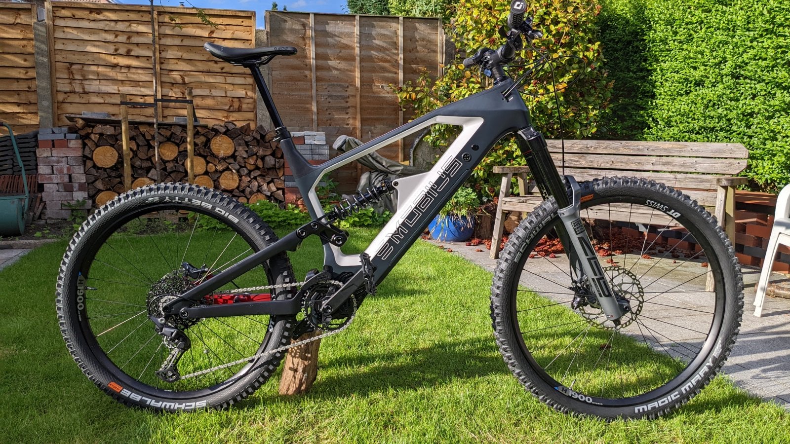

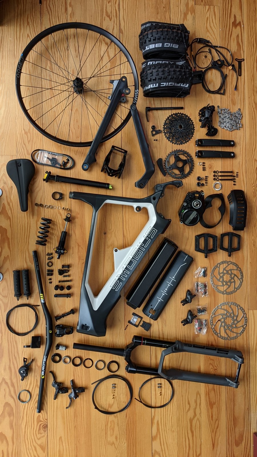

So the front wheel finally arrived which meant I could finish the build. I wanted to say a massive thanks to @thaeber, @patdam and @Rob Rides EMTB for all their help and advice on the sizing. I did go for the XL in mullet format in the end with the Cane Creek 216x63 coil (-2mm bushing) and it is brilliant. Especially the rear shock, with a few click of LSC to take out the bounce it is a pleasure. Motor does feel on the weedy side, but maybe it is my weight and not the motor that is the issue. Also, it does mean I get some proper exercise.
With the XL frame I am getting a BB of 360 with no pedal strikes and head angle unweighted is 63.4deg. It feels super long when you stand next to it, but at 1.92m tall it is actually just right for me and rides well - really confidence building and with the rear shock in climb mode if sticks to the loose terrain really well. Fork (170mm) View attachment 89279View attachment 89278View attachment 89276View attachment 89275View attachment 89274View attachment 89273still not tuned right and feel a bit jarring but I have only had 1 decent ride so far.....I do wonder whether 160mm might have been enough?

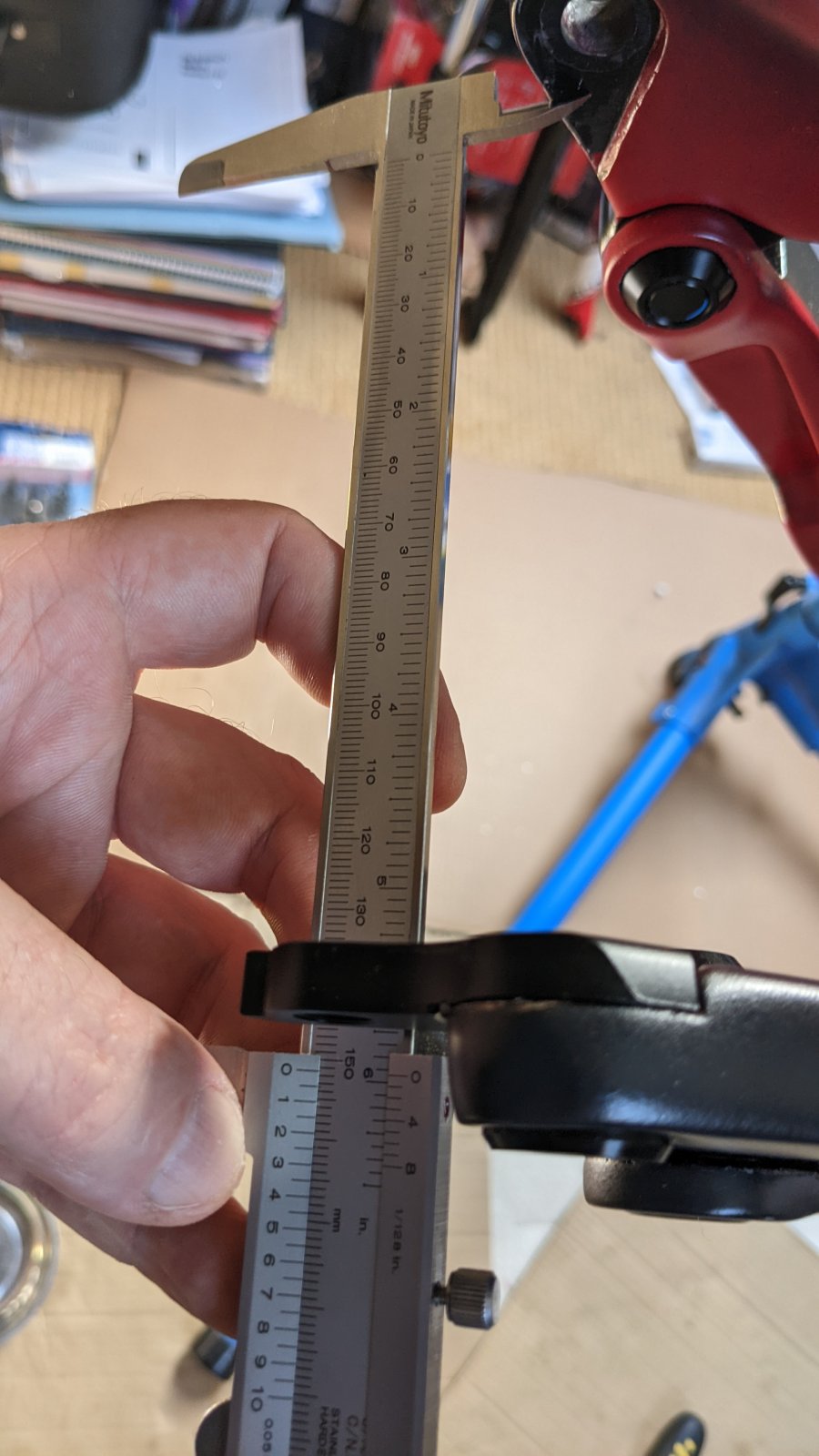

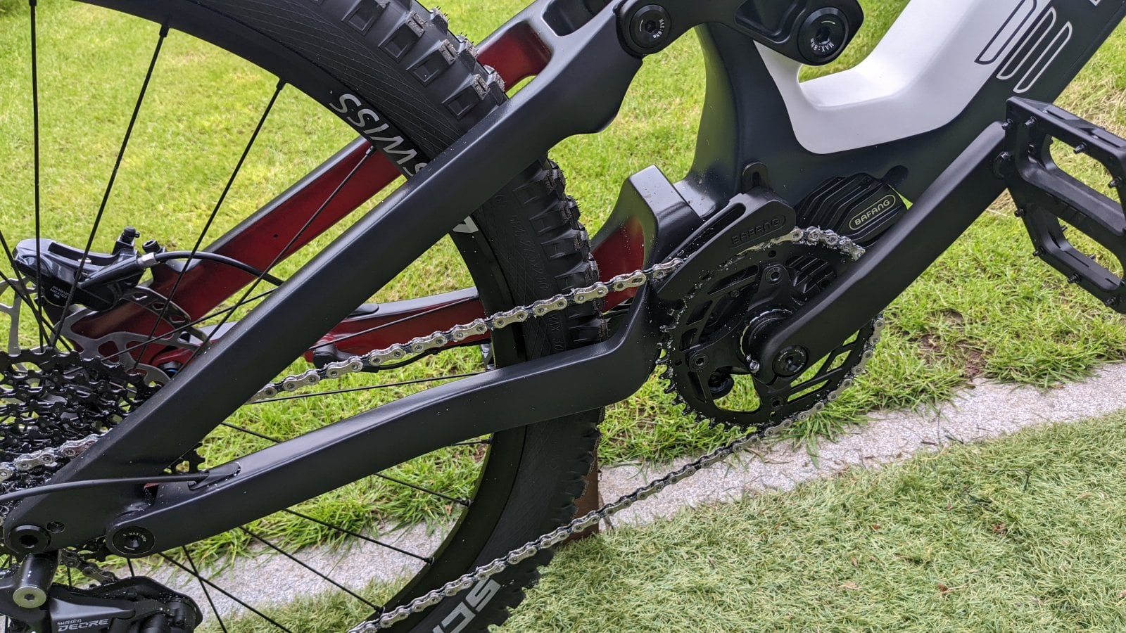

One thing I did notice is that the distance between the rear axle "brackets" is a good 4-5mm wider than the axle meaning when you tighten it the frame "pulls in". Anyone else notice this? Does not seem to affect anything.
Thanks again guys!

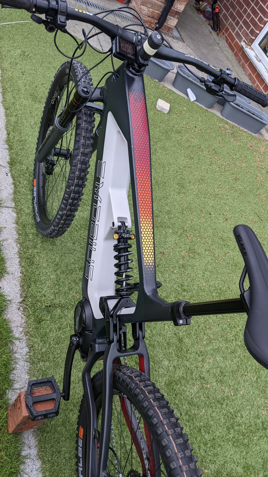

Yes, after seeing some youtube videos I took the plunge.... This was my first paint job and therefore I used rattle cans and plenty of time whilst waiting for front wheel to arrive.. Paint quality would be better the 2nd time for sure!
They are not decals, I masked and sprayed everything..... Thankfully I have a vinyl cutter at home which allowed me to cut my own stencils for spraying...

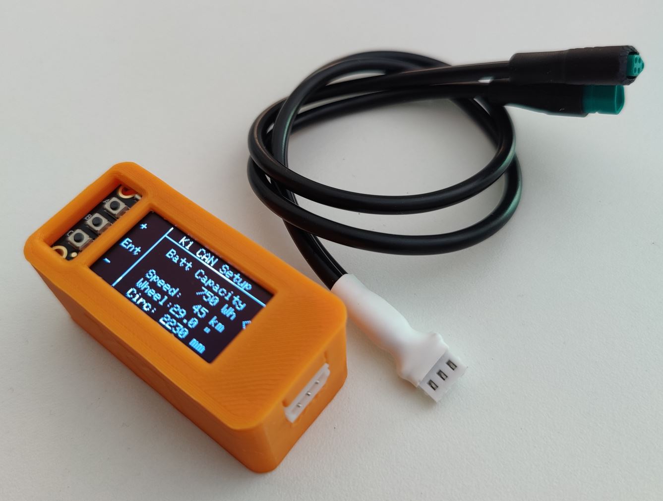

Hello ebikers.
K1 eBikes has designed small, portable and simple K1 CAN Monitor & Speed Unlocker - no need computer or mess with BESST. Works ONLY with Bafang motors with CAN bus (green connector to display with "house" shape 5 pin connector).
For more info check the following link:
https://endless-sphere.com/forums/viewtopic.php?f=31...
How to unlock speed:
https://youtu.be/6z3TzEqNWsQ
If you interested, send an email to [email protected], will answer any questions and will send user manual.
K1 CAN Monitor is determined for testing purpose only and is not waterproof.
