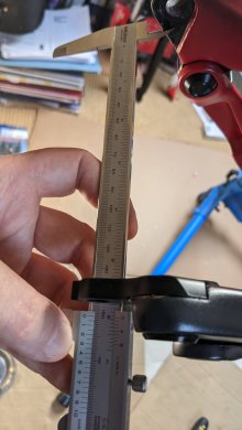

Any update on seat post tube max length in large or XL frame I would like to order one as well but don’t want the sticking up part of the dropper.
I've just measured my large frame and the 'clear depth' from the top of the seat post clamp down to the top of where the motor mounts, is 390mm. My 150mm travel, 440mm RS post fits with room to spare. I would imagine most droppers will fit the large / X-large frames.
I have a Reverb Stealth 200mm travel C1 post that I fitted to my Dengfu E10 Large Frame at the weekend, I can confirm it's slammed right down to the bottom with no issues

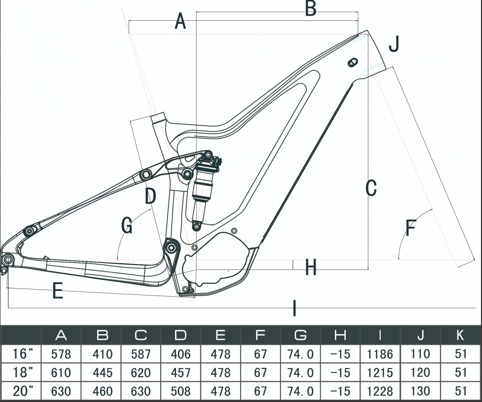

Sorry to hijack the thread here. My frame arrived and it seems too small. I ordered 19". When I measure TT, I come to 630mm. Am I measuring wrong or is this a 17" frame? Has anyone ever re-measured his frame and if so how?
E10 frame sizing
Sheff73
Feb 13, 2021
98
82
E10 frame sizing
Make sure you measure the distance with the frame chain stays positioned roughly horizontal (how the bike sits when assembled) then take a horizontal measurement from the centre of the head tube to the centre of the seat post. Should then match the figure shown in the table.
Mind you it says the head tube length is 120mm for the 19" and mine is 130mm :rolleyes:

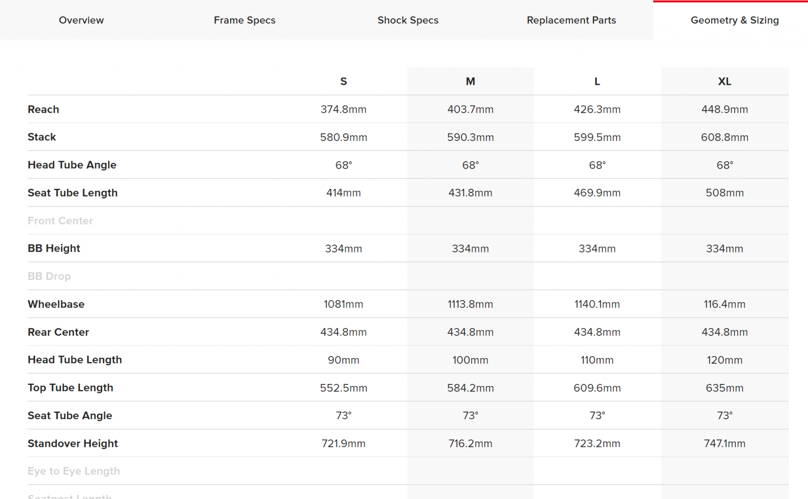

thaeber - thank you - really appreciate your opinion! Had a look at the SC5010 v1 geometry and reach is actually 449mm - hence why I was wondering about the 20" E05.... stack similar too... but it is not always about the numbers, sometimes gut feel counts for a lot. Enclosing the SC5010 v1 chart to compare against the Dengfu E05. (Pretty sure you know the E10 already!!;-)

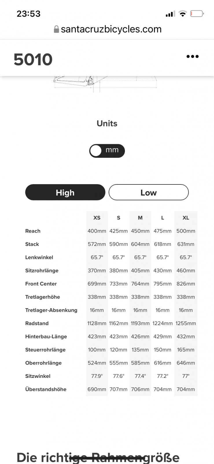

Sorry mate I expected You are talking about the 2021 SC 5010. They massively changed the geo compared to V1, way longer reach values. The E05 geo is comparable to Your 5010 V1, for sure, but the short reach values are not really modern yet - outdated. May be You have a chance to ride a 2021 SC 5010 XL in comparison to Your V1, and You will know the difference. Personally, I‘m 6“ (183 cm) and the size L E10 is perfect for me with 40 mm Stem and 35 mm rise 800 mm wide bar. I run mullet wheelset, longer coil Shock 216 x 63 and BB is at 358 mm HA at 64 Deg. 180 mm Fork and 170 mm rear travel (measured). I ride with 30% SAG and the bike is perfectly balanced. If I would be in Your shoes, I would run the same setup on XL frame, may be a slightly shorter stem.

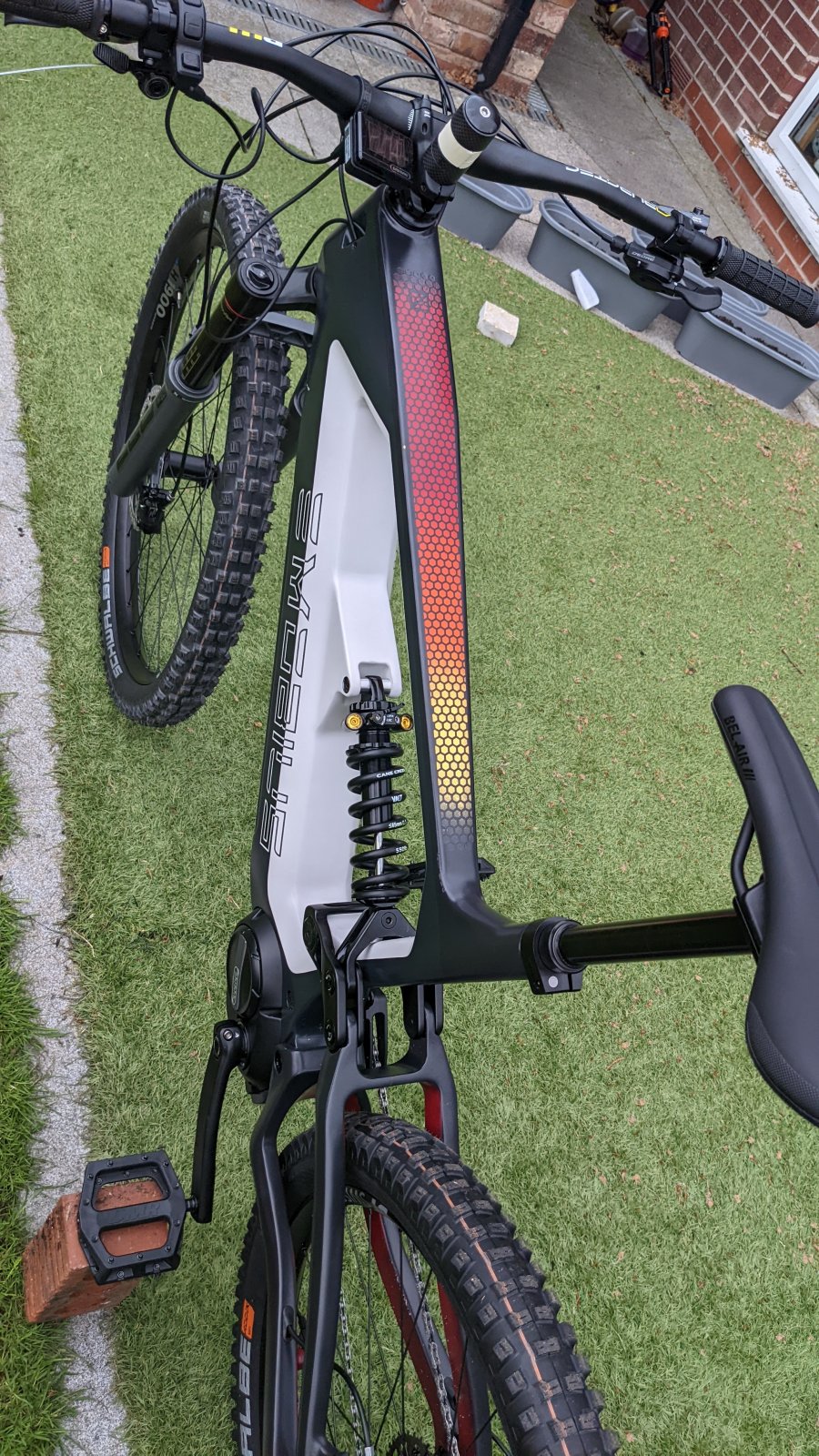

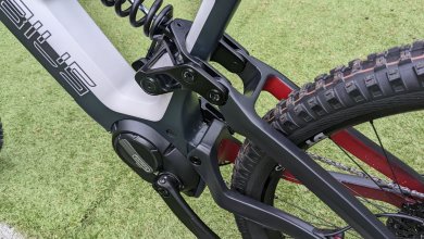

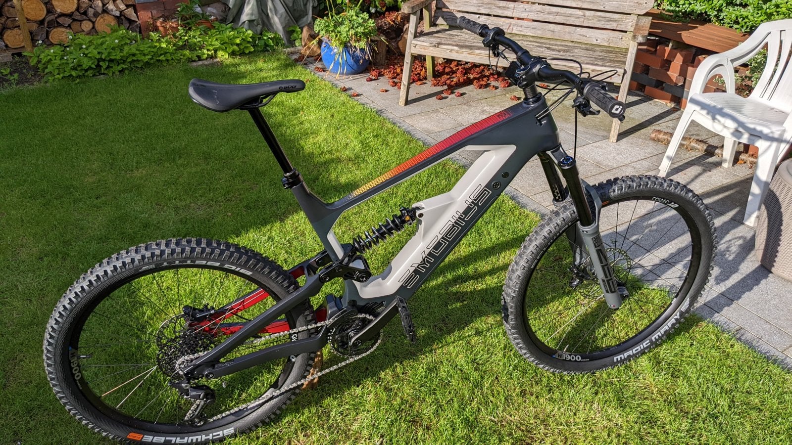

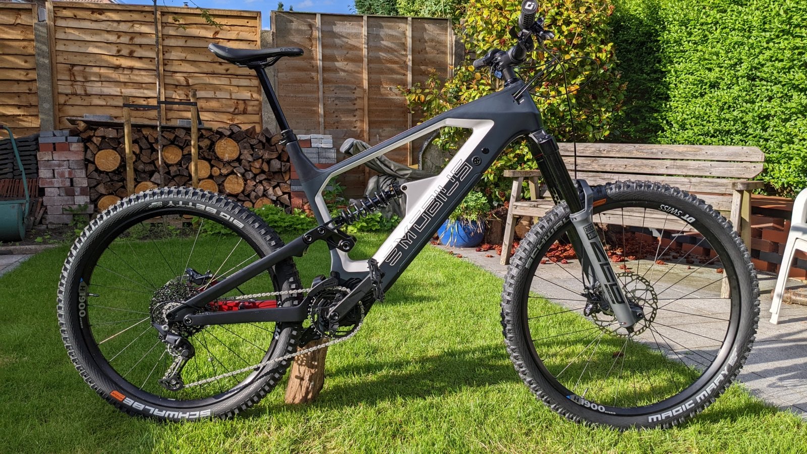

So the front wheel finally arrived which meant I could finish the build. I wanted to say a massive thanks to @thaeber, @patdam and @Rob Rides EMTB for all their help and advice on the sizing. I did go for the XL in mullet format in the end with the Cane Creek 216x63 coil (-2mm bushing) and it is brilliant. Especially the rear shock, with a few click of LSC to take out the bounce it is a pleasure. Motor does feel on the weedy side, but maybe it is my weight and not the motor that is the issue. Also, it does mean I get some proper exercise.
With the XL frame I am getting a BB of 360 with no pedal strikes and head angle unweighted is 63.4deg. It feels super long when you stand next to it, but at 1.92m tall it is actually just right for me and rides well - really confidence building and with the rear shock in climb mode if sticks to the loose terrain really well. Fork (170mm)
PXL_20220517_161625791.jpg PXL_20220517_161601174.jpg PXL_20220514_160247628.jpg
still not tuned right and feel a bit jarring but I have only had 1 decent ride so far.....I do wonder whether 160mm might have been enough?
One thing I did notice is that the distance between the rear axle "brackets" is a good 4-5mm wider than the axle meaning when you tighten it the frame "pulls in". Anyone else notice this? Does not seem to affect anything.
Thanks again guys!

Thanks mate, a pleasure to help and even more pleasure to see such awesome result! Make sure to carefully dial in the LSR on the slower side, that helped with my bike to really stick to the ground after big compressions and harsh impacts! Ride on!
