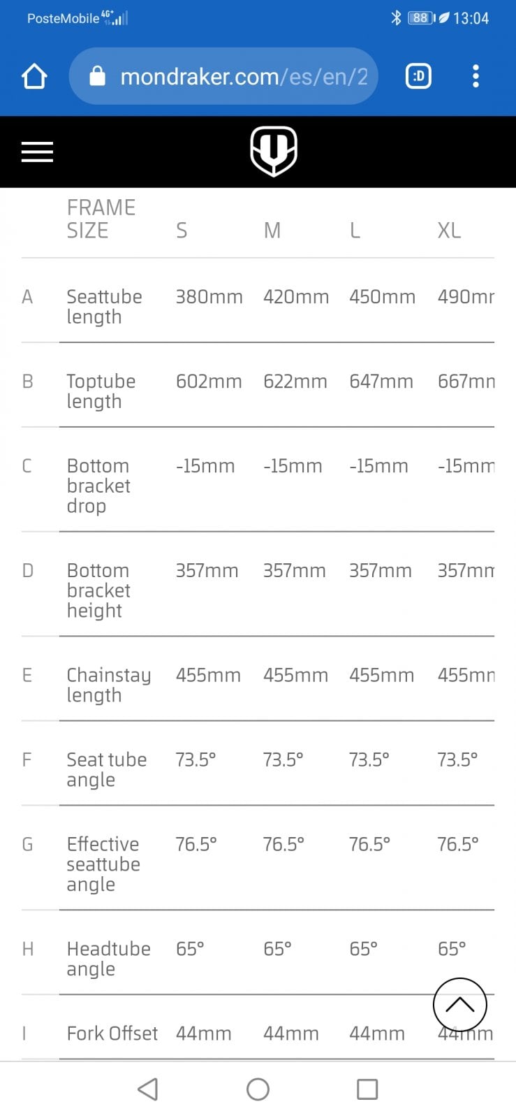

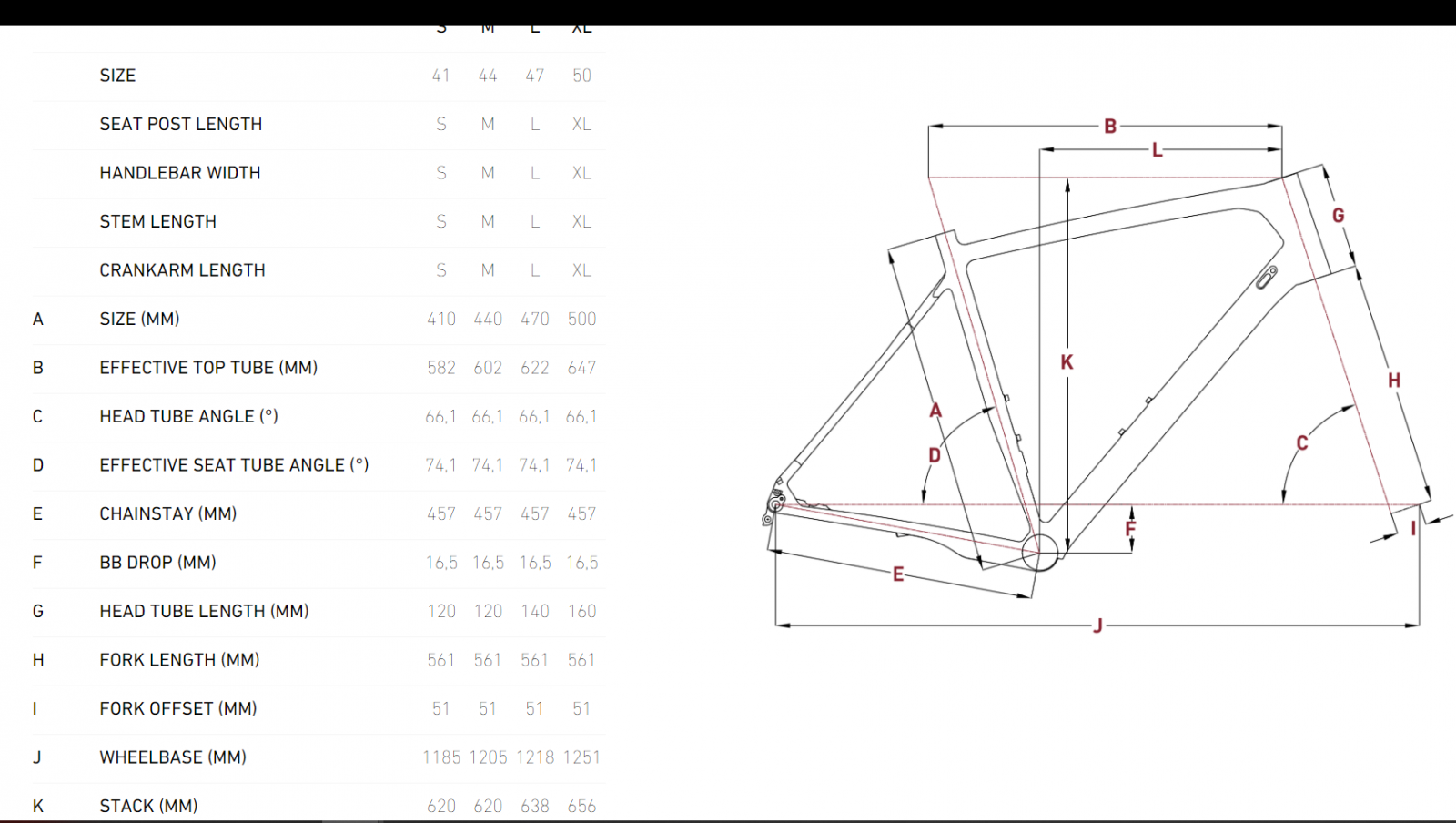

i have a Focus jam6.8+ which i love but i purchased it as a "L" in size, feels good most of the time but can some times it feels a little big when on trails.
totally fine as my other half loved mine so much we purchased one for her too which basically means we go out a lot but do no trails, so i thought after seeing videos etc. and the fact that i have lots of good quality spares purchased in the recent years i would like to build a Dengfu e10 with an M600 Bafang motor, but the stated geometry concerns me if i compare the jam 6.8+ geo with the Dengfu it is saying it is the equivalent of a 17" frame which would be medium, do they come up big or do they come up small in comparison please help i do not want to get this wrong.

For sizing i can only help you when my framset is delivered and assembled ?. It should be deliveed in march - i got the 19" frame evene i normally ride a L. I guess framsizes come smaller then used but it is just a guess. I think Rob or any other user who already have built up their Dengfu could help with this question ?

What I know Rob took a framesize 21" and he is normally riding xl. So i would wonder if the come up even bigger as "normal" framesizes. I would not know for what market they are making the framesets if a 21" would then be a xxl and a 17" would not be a M but a L and so on ?‍♂️

I only know that the reach seems to be really really long but maybe this frame needs longer reach.

I would say, the 17" is the same as your bike, only the reach seems to be longer. They seem to be come up big. Apart from the seat tube length, the DengFu medium (17") is bigger than the large Haibike that I have. I’m getting the 17”. I’m 5ft 10 with fairly long arms and legs.
So this is my dilemma I'm also 5ft 10 but have short arms and legs which is why the focus can sometimes feel a little large in some technical places I feel like I'm fighting the length of the top tube if that makes sense, awesomely stable but perhaps a tad long for me, with the top tube and reach being bigger on the dengfu I'm actually tempted to go for the 15" I just don't want to get it wrong saying that the motor and battery would fit on to another frame if I get it wrong so perhaps not the end of the world and I'm overthinking it....

I think you’re right to consider the 15". You can always can compensate the short seat tube length with a longer dropper post. I noticed that you’re from Northampton, I used to live near Oundle before moving to France six years ago.
That was my thinking.... might make it a bit more agile as it would be obviously shorter too..

I was surprised to see that someone already entered Dengfu E10 frame details on Geometry geeks website,
You can compare your current bike's geometry to the Dengfu. I was even able to find my Chinese carbon XC frame from 2012! I have a mate with an SWorks Turbo Levo which I've tried so also a useful benchmark for me. Hats off to the guys doing a great job to compile this?. One or two dimensions not quite converted correctly but still a very useful tool.
I've ordered E10 in XL, but after looking at this I'm thinking I might ask to change order to L.
XL Wheelbase and effective top tube length might be a bit long for me.
