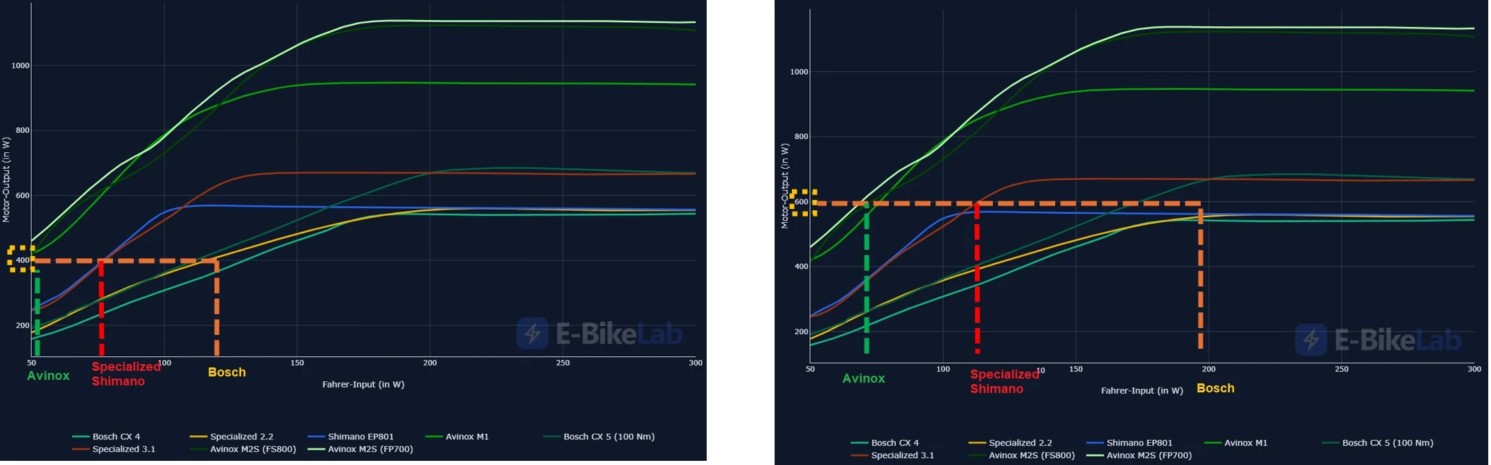

Avinox has brought a completely different perspective on what assistance from an eBike motor can be.
Below, we can identify three major assistance curves:
  1. Avinox
  2. Shimano/Specialized
  3. Bosch
It is easy to see that for the motor to deliver 400 W, the rider only needs to supply approximately:
  1. Avinox – 50 W
  2. Shimano/Specialized – ~75 W
  3. Bosch – ~120 W
For a motor output of 600 W, the required rider input is roughly:
  1. Avinox – 75 W
  2. Shimano/Specialized – ~120 W
  3. Bosch – ~200 W
From this, we can quickly conclude that Avinox is characterized by low rider power input and high motor power output, while Bosch represents the opposite approach, with Shimano/Specialized positioned in the middle ground.
Unfortunately, we cannot directly compare SL motors on ebike-lab.de, but it is reasonable to deduce that they fall below the Bosch CX4/CX5 in terms of assistance. This implies higher rider power input and lower motor power output.
It is here that I believe we are witnessing the emergence of a new class of eBike motors, characterized by low rider input and high motor output—an “Avinox Class.”
Personally, I am not particularly drawn to this low-input/high-output approach. I have tuned down the Tour mode on my Bosch CX4 to 450 W and 60 Nm, with ECO set to even lower values. While I can still use Turbo or eMTB+ modes for very steep or technical climbs, what I truly seek is the bike experience—without the suffering, but also without excessive motor assistance.
I do believe that Avinox systems can be configured for lower power output. However, whenever I read reviews, the emphasis is almost always on maximum power. For that kind of experience, I would rather use my 300cc two-stroke enduro/hard-enduro motorcycle.

I think the problem is that because for years we've all read "250w nominal" - somewhere in everyone's minds that means that all the bikes only have 250w power.
That isn't the case, it's just everyone miss interpreting what that means.
Effectively, the decision was made that 250w nominal was a good baseline number to use for power. All this means is that a motor has to be able to output 250w CONTINUOUSLY- Indefinitely - without overheating.
Pretty much every e-bike motor has had peak power considerably higher than that - the difference is that the peak power can normally only be maintained for a far shorter period - say 20 or 30 minutes as an example before it overheats and restricts it melts.
Even if you take something like a Levo SL motor with it's 35nm. It's actual peak power is nearer 320w.
You don't see everyone building mini trebuchets to throw their toys out of the pram because OH MY GOD, it's got 50% more power than is shown as it's nominal power output.

I know lots of people say "I don't need that much power" but 99.9% of people aren't using 100% of the peak power any of their bikes have. Everyone also rides different terrain. Pretty much anyone who rides uphill on steeper terrain will at some point have found themselves in a situation where they'd wished they'd had a little more power.
Obviously there are concerns that Electric Mountain Bikes could turn into Electric Moto's - but for it to be a mountain bike, it still has to be below a certain weight just to be able to ride it like a mountain bike. Once you're into the electric moto zone, you have far far larger and heavier motors which would result in a hideous riding experience. You also have to pedal to engage the power rather than use a throttle, which creates an entirely different riding dynamic.
Yes, there will always be moron's who will ride too fast when it's inappropriate, but that's always been the case. There will always be moron's in any sport or setting who don't think about anyone else - what peak power an electric bicycle can output doesn't and won't stop people being Morons - don't forget, you even get Morons on unassisted bicycles, yes, moron's even exist entirely without any bike at all. Or the ones on Quads who for some reason think empty Monster Energy can's exist purely to randomly decorate the countryside.
