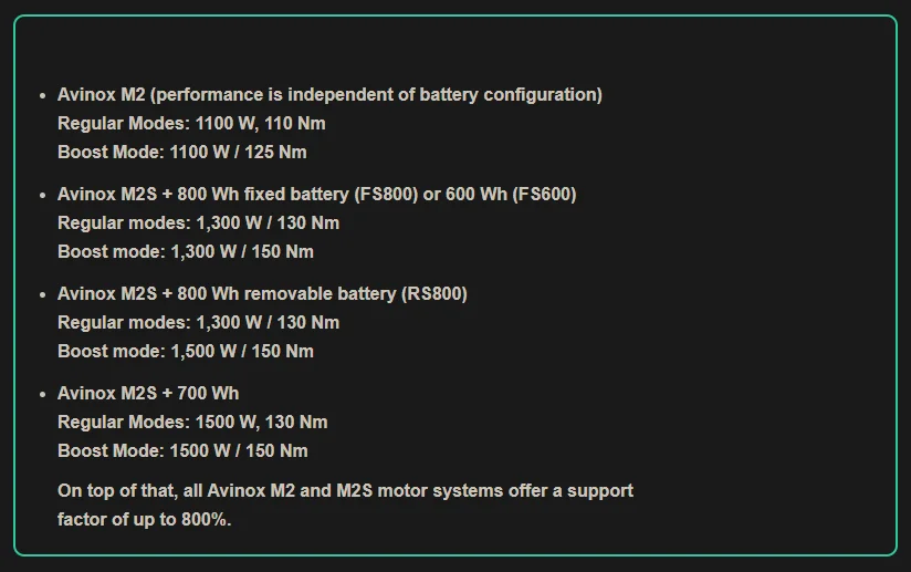

I'm wondering where these guys got the specs from
What bit do you want ?

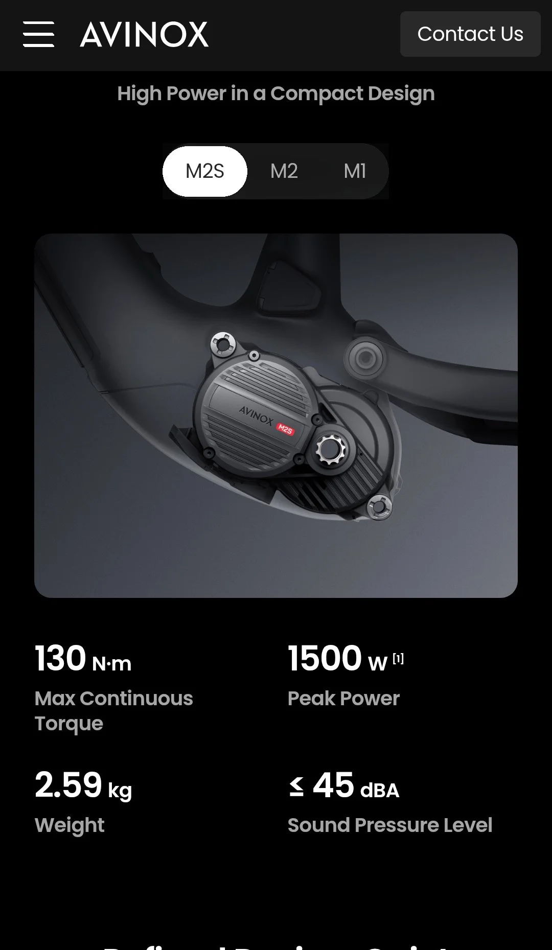

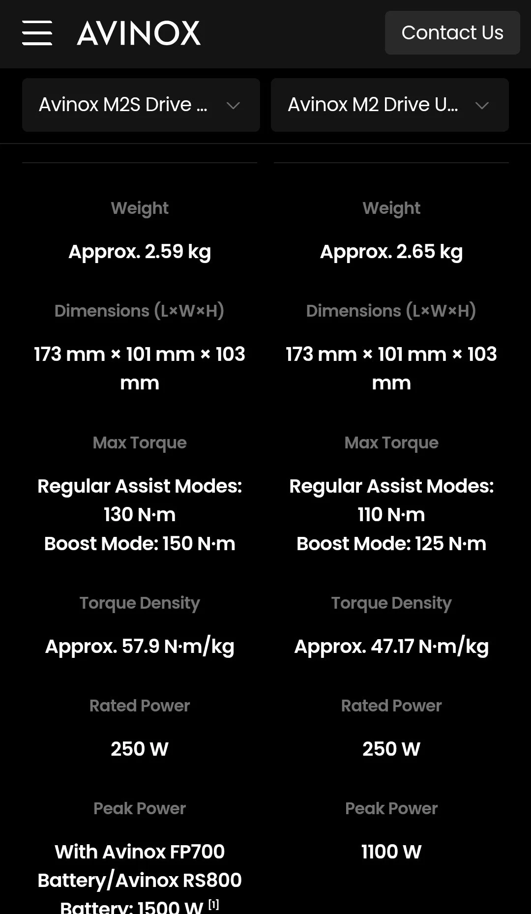

do they state a continuous power for the M2S with the 700wh battery?

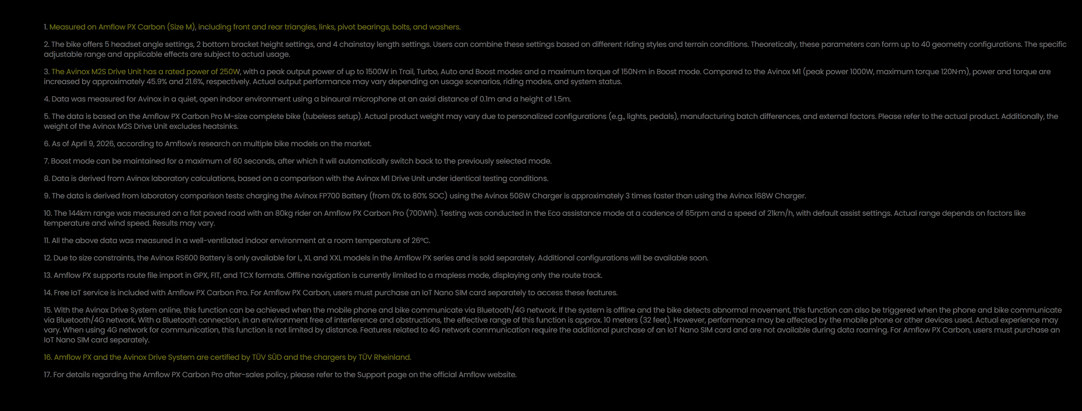

The data I provided was for the Amflow PX. The point that is important is Point 3. It states.
"The Avinox M2S Drive Unit has a rated power of 250W, with a peak output power of up to 1500W in Trail, Turbo, Auto and Boost modes and a maximum torque of 150N·m in Boost mode. Compared to the Avinox M1 (peak power 1000W, maximum torque 120N·m), power and torque are increased by approximately 45.9% and 21.6%, respectively. Actual output performance may vary depending on usage scenarios, riding modes, and system status."
The battery has no impact on rated power. It only impacts peak power.
I'm not sure that's the case - if rated = continuous = nominal = Regular,
and it's true the 700wh battery has better thermal regulation - this is why I'm trying to get info from Avinox themselves...
A motors rating is not linked to the power supply. If you connect a 1kW motor to a supply capable of 10kW or 5kW. It has no impact on the motor's rating. It's still a 1kW motor. The additional power the supply can generate, just means you can over current the motor, with more current.
But this just means the motor will overheat quicker.
A motors rating is not linked to the power supply. If you connect a 1kW motor to a supply capable of 10kW. It has no impact on the motor's rating. It's still a 1kW motor. The additional power the supply can generate, just means you can over current the motor, with more current.
in that case 'rating' isn't the same as 'continuous'
Sort of. You can run a 1kW rated motor continuously at 1kW and it should never overheat. But as soon as you run the motor above 1kW, it will start to overheat.
How long before the insulation starts to melt is purely based on time, ambient temperature and amount of power above it's rated value.
But any motor system that has over-temperature protection, normally uses a thermistor in the motor to monitor temperature and de-rate the motor controller when the motor gets too hot. The new M2S motor apparently has a thermistor in the motor. Where the M1 only calculated the heating in the motor controller. I got that from Rob's video.

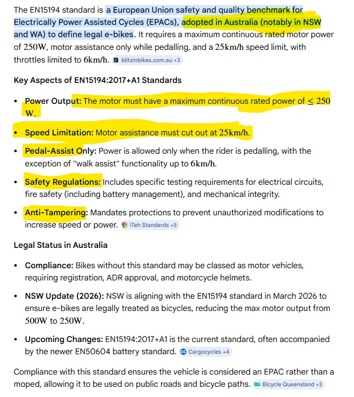

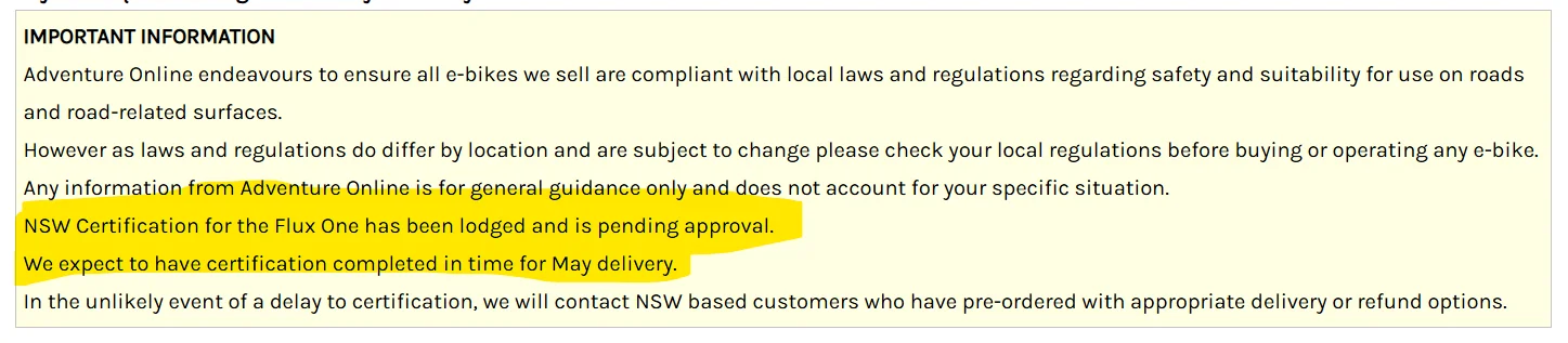

What a load of rubbish. My M2S Teewing Flux bike is currently undergoing NSW certification. If they deem it illegal. It's illegal. If they deem it legal. Then it's legal. And to be legal in NSW, it must meet Class 1 regulations. It has nothing to do with what I think or do.
And rather that just spreading hearsay. Here is the evidence below. It's super disappointing the stuff being posted here. No wonder there is such a strong Anti Ebike lobby.
And it's tiring and boring fact checking all the posts people are just inventing in this thread.

This is a game of marketing and legalese... Avinox claims their motors have a rated power of 250W and that's in compliance with EU regulations for pedelecs limiting continuous power to 250W (thermal). They also claim a peak of 150Nm and 1500W. However, testing shows with a 700 wh battery the M2S can effectively continuously output 1500W.
On Amflow's US site, when they released the PX/PR they didn't "showcase" the 1500W peak figure. Instead they focused on 150 Nm... I guarantee that was on purpose. IYKYK, folks are aware of the class leading power/torque levels Avinox has been pushing out. No point raising attention to 1500W power, when that may not be illegal in certain parts of the world.
*edit* I don't doubt Avinox is in compliance with EU regulations and I stated that prior and its a shortcoming of how the regulation was written for pedelecs. Instead of limiting mechanical output, whether continuous or maximum they chose to use a thermal requirement often used to spec motors to operate safely and without loss in performance.
