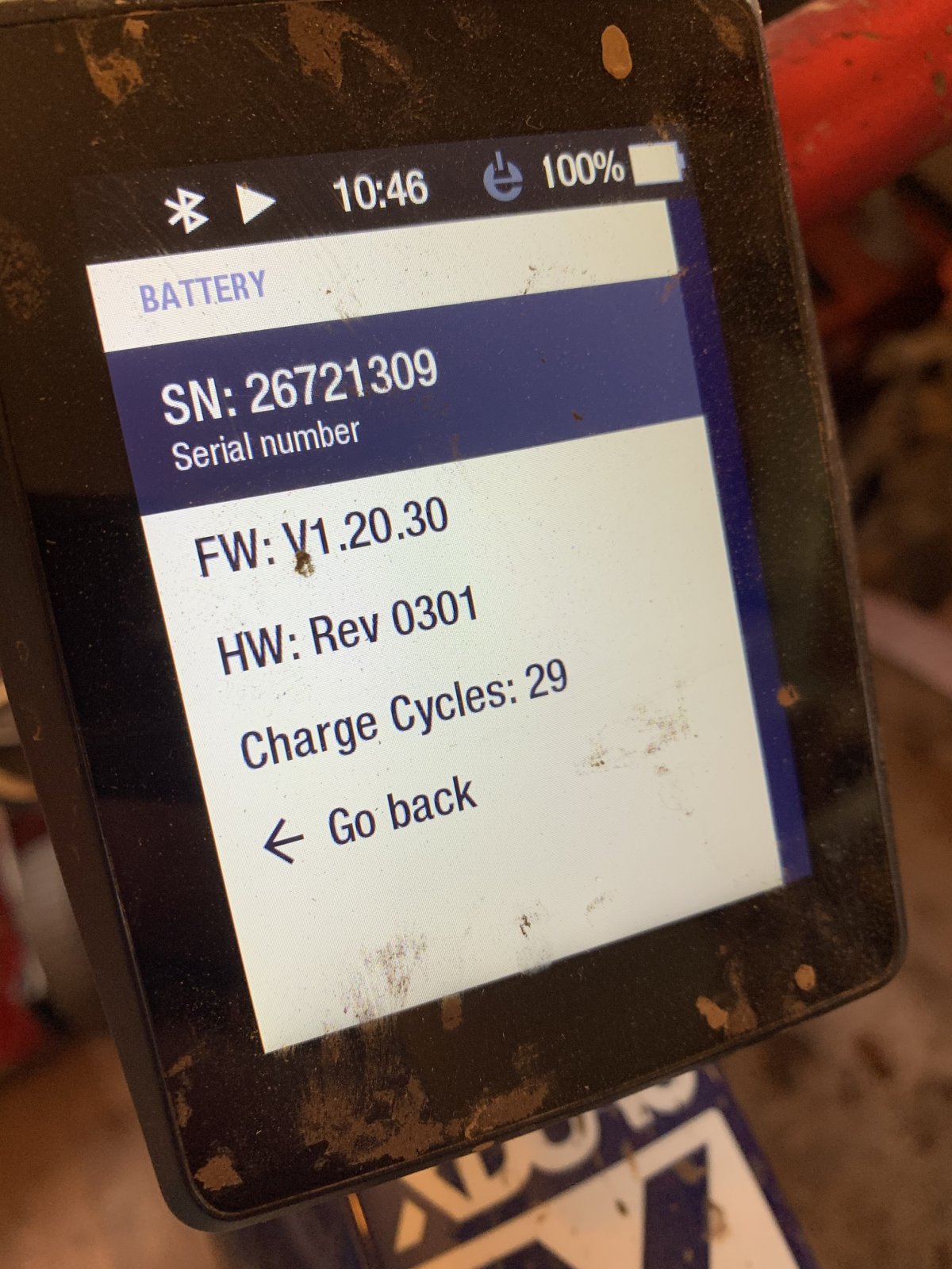

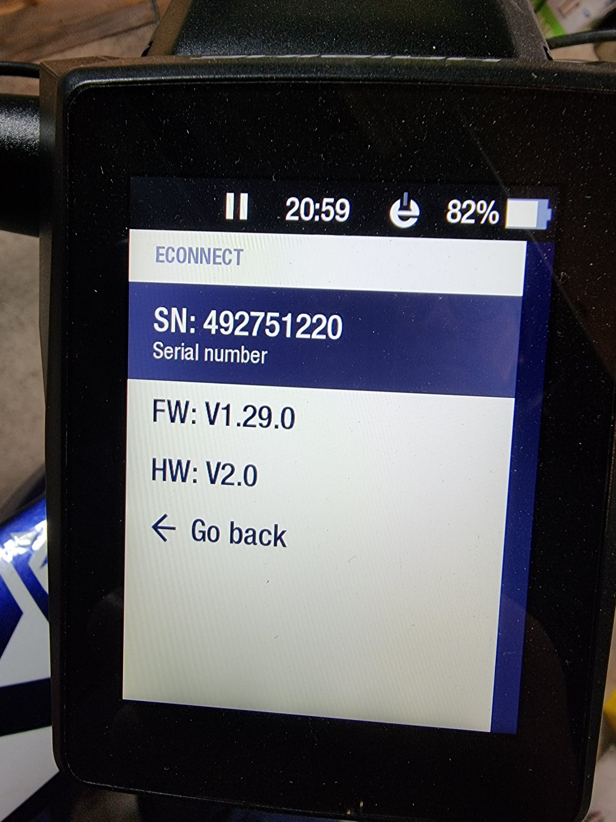

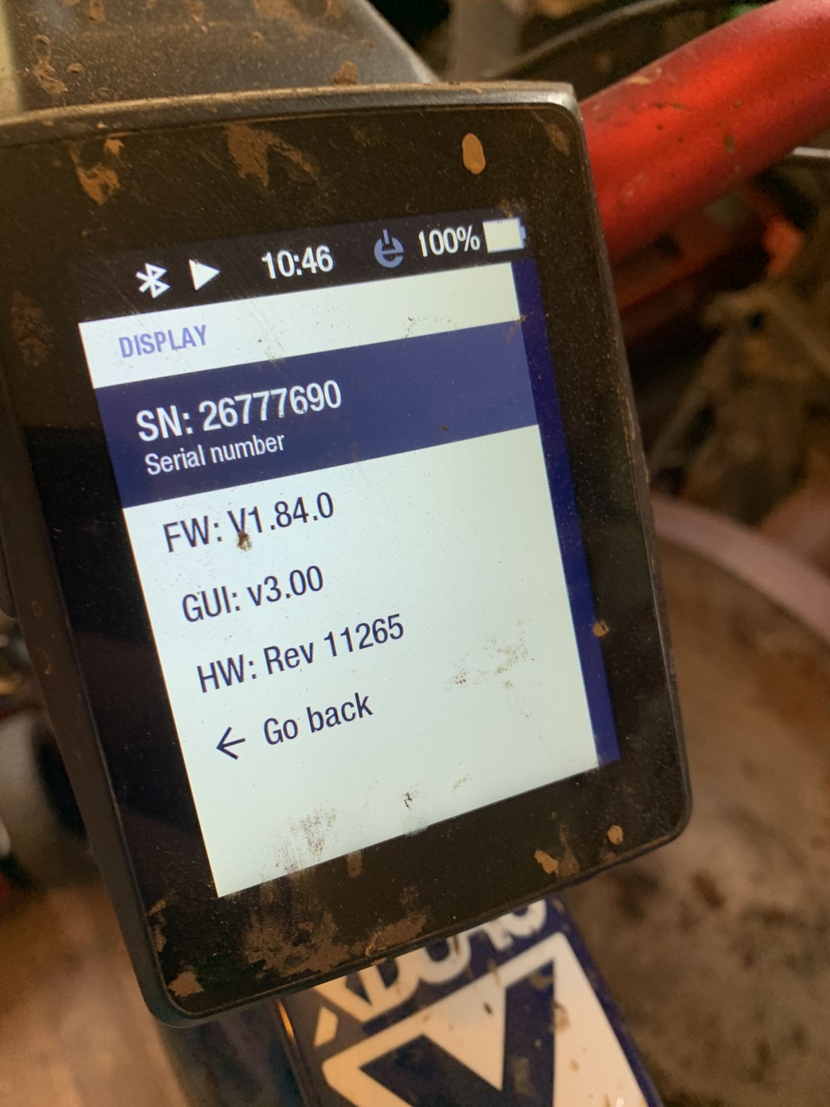

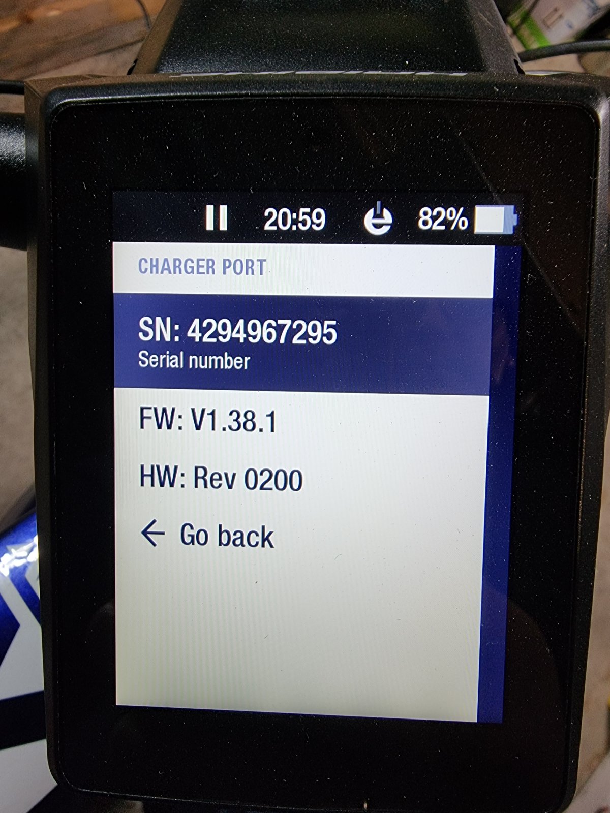

I have tried and failed to find the latest versions of the Flyon software. Mine are:
Motor: FW v1.5.137. HW Rev 0101
Battery: FW v1.20.30. HW Rev 0300
Display: v1.81.72. GUI v2.83. HW Rev 11265
Charger Port: FW1.38.1. HW Rev 0200
Econnect: FW 1.29.0 . HW v2.0
Remote control: FW v0.27. HW Rev 0101
I would be very grateful if anyone could let me know if there are any later versions – especially if they actually are improvements! Many thanks.

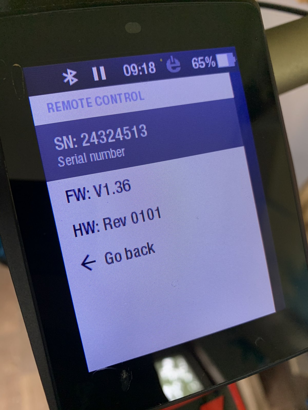

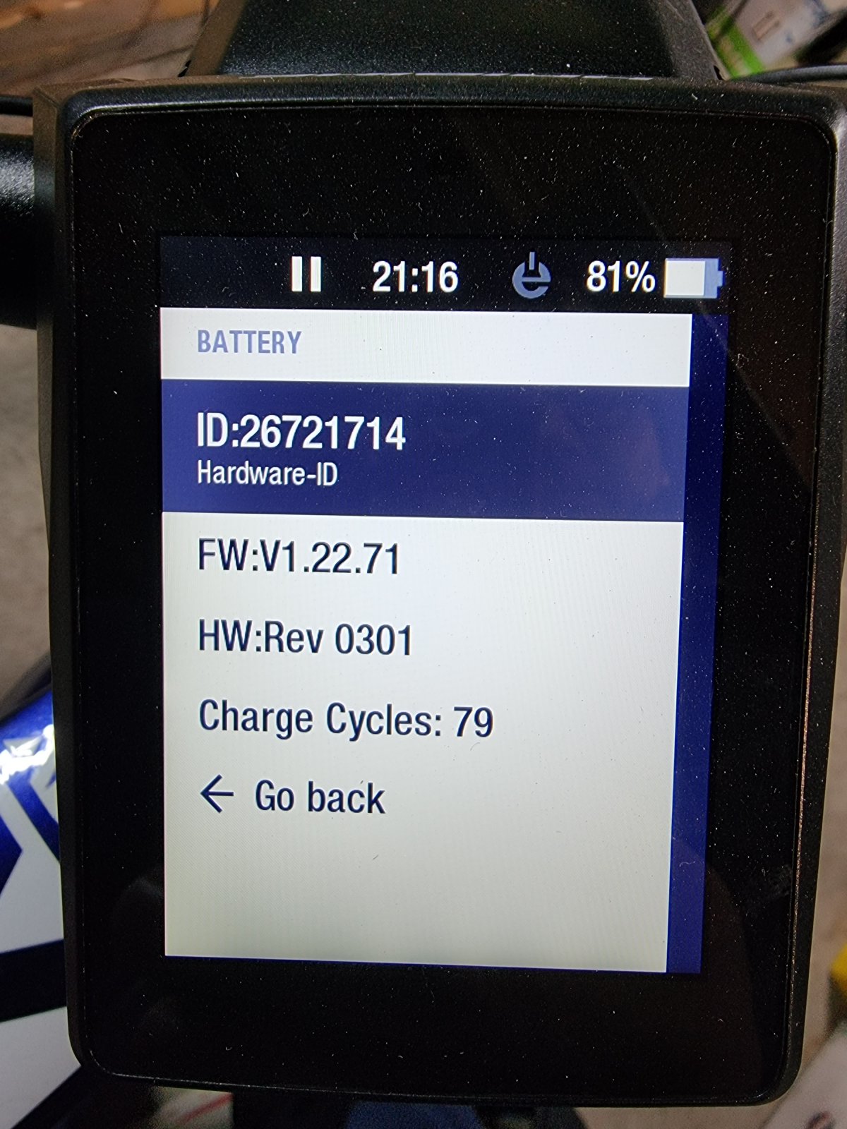

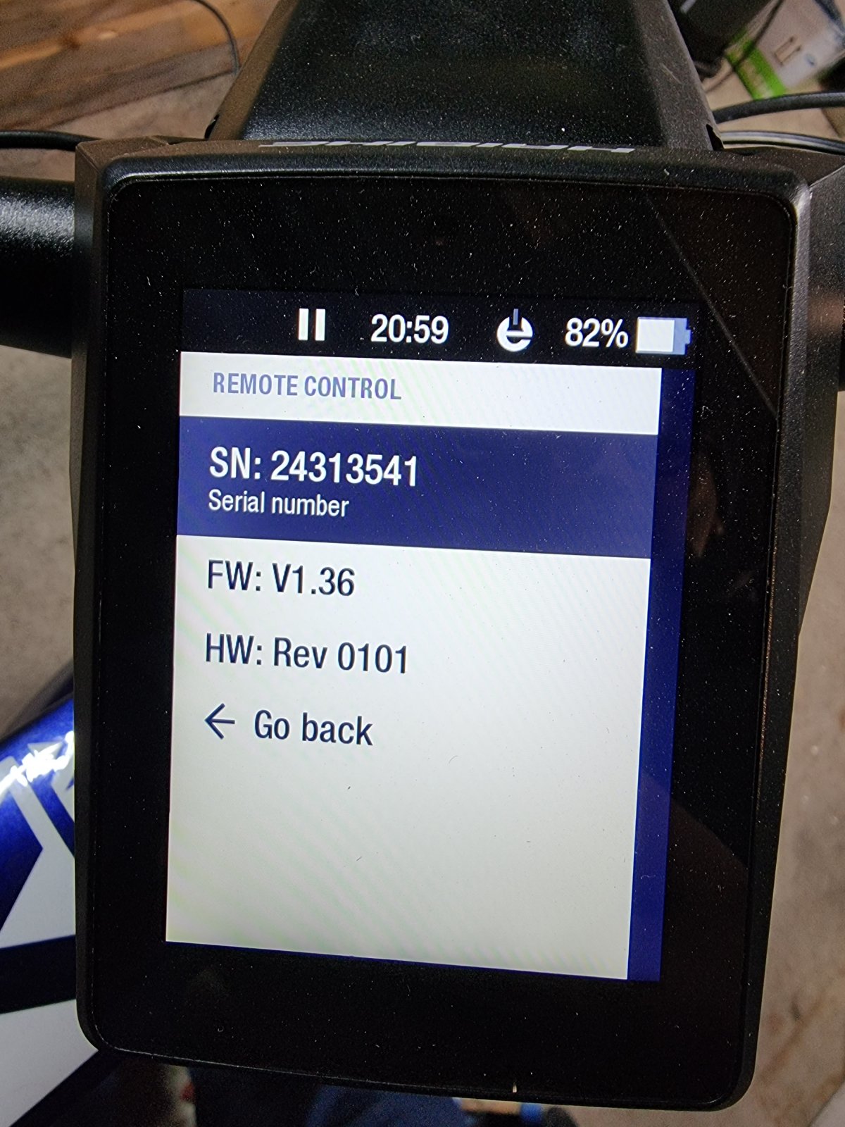

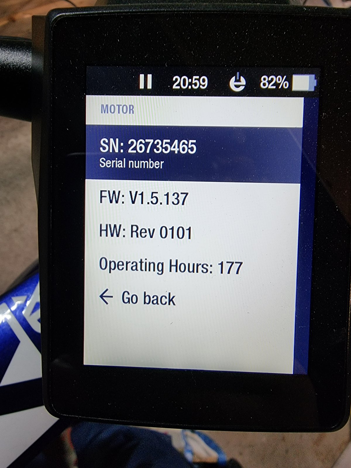

Ok I’ve checked one of my two Flyon bikes (the one I use most, there is no battery in the other at the moment, I’ll check it later)
All is the same as yours with the exception of the remote control which is interesting?
The bike is a MY19 but the remote is off a MY20 bike.
The remote on the other bike is even later as I replaced it. It’ll be good to see what that is.

Hi guys. Just finished updating my Haibike Flyon with the Haibike Flyon/TQ service tool 😁😉
This is the latest sw versions from Haibike Flyon.
I have the Haibike Xduro Alltrail 5.0 Flyon 2019
My display was updated from FW v1. 84.0 to v1. 84.8 (this FW update solve problems with connecting to the systems...)
My battery was updated from FW v1. 20.30 to v1. 22.72 (no extra info on this update)
