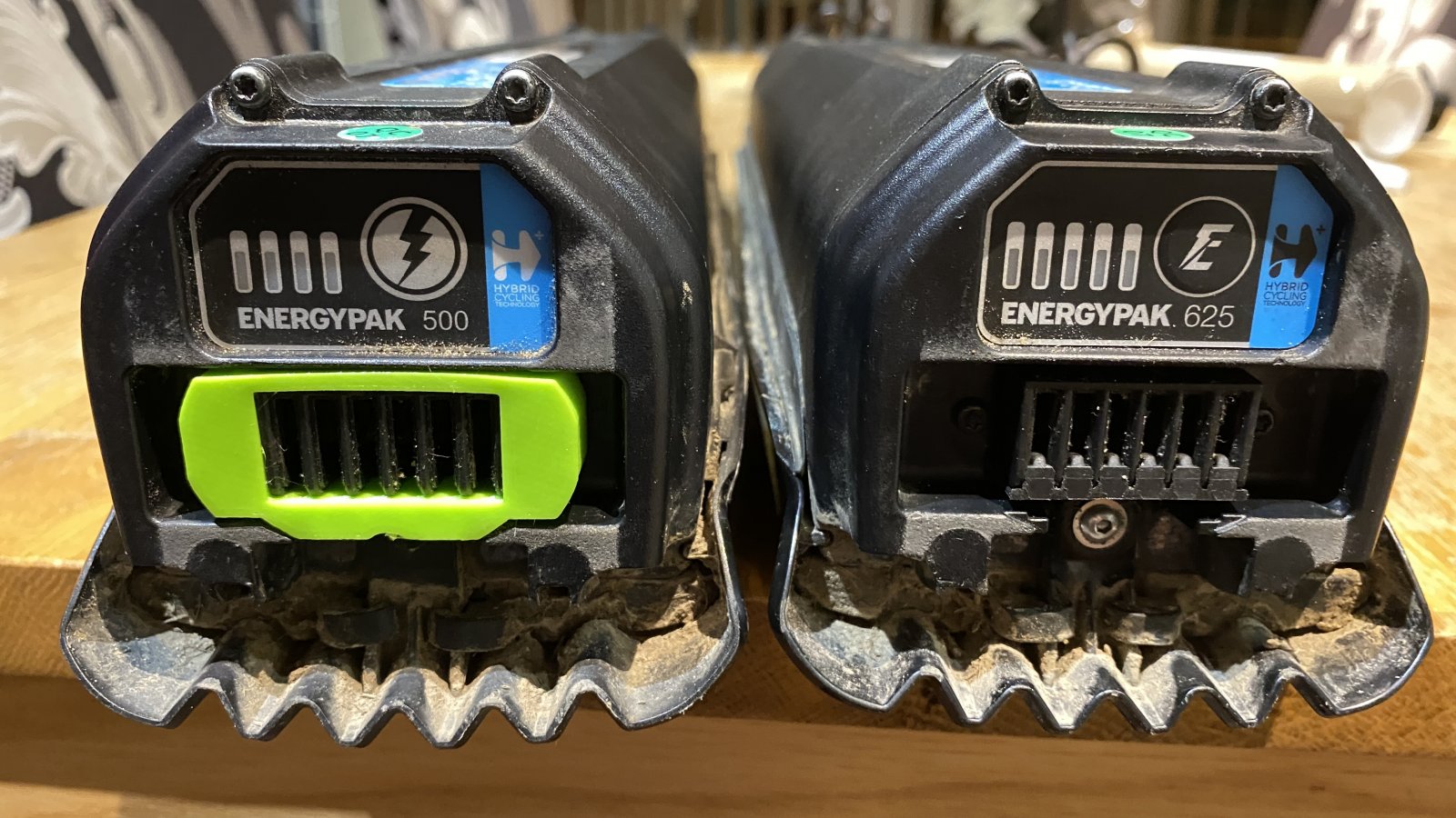

Anything is possible, but as documented in the OP I used brand new everything, all at the same time and it had never been wet.
plus i haven’t used the shrink method, I’ve used liquid tape and only covered the outside of the connectors. I also haven’t made that mistake that many make of adding a dielectric grease to the actual connection terminals. Mine are connected dry and the outer casing then waterproofed with liquid tape which we use on race car ECU’s all the time.
Plus of course the big one…
My mates battery works just fine on my bike.
I even bought and use the MY21 discharge connectors as it is so much better than the older ones that had no sealing on them at all.

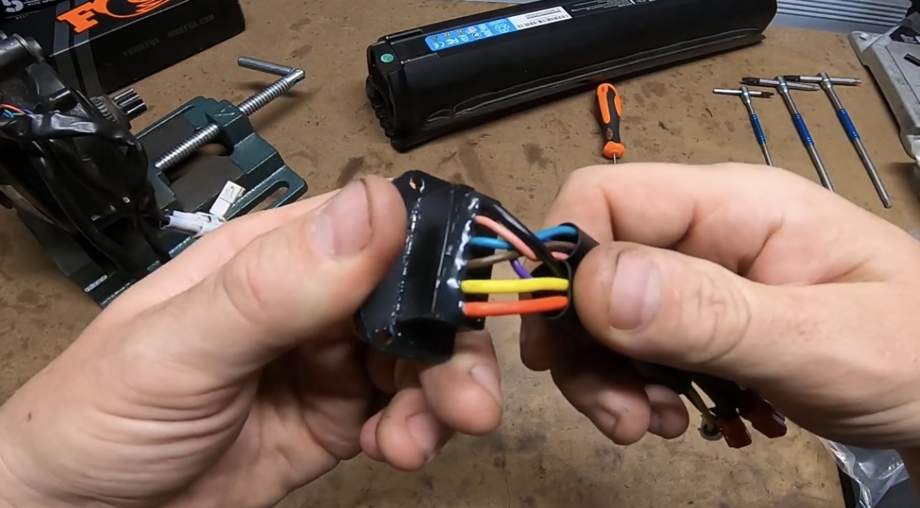

I did note on your photos of both batteries in posts a bove however that the battery (female) terminals were far from clean!!
Probably just residual Servisol CW7100 on the terminals.
Arguably the best contact lubricant in the world. But naturally I tried dry contacts etc first.

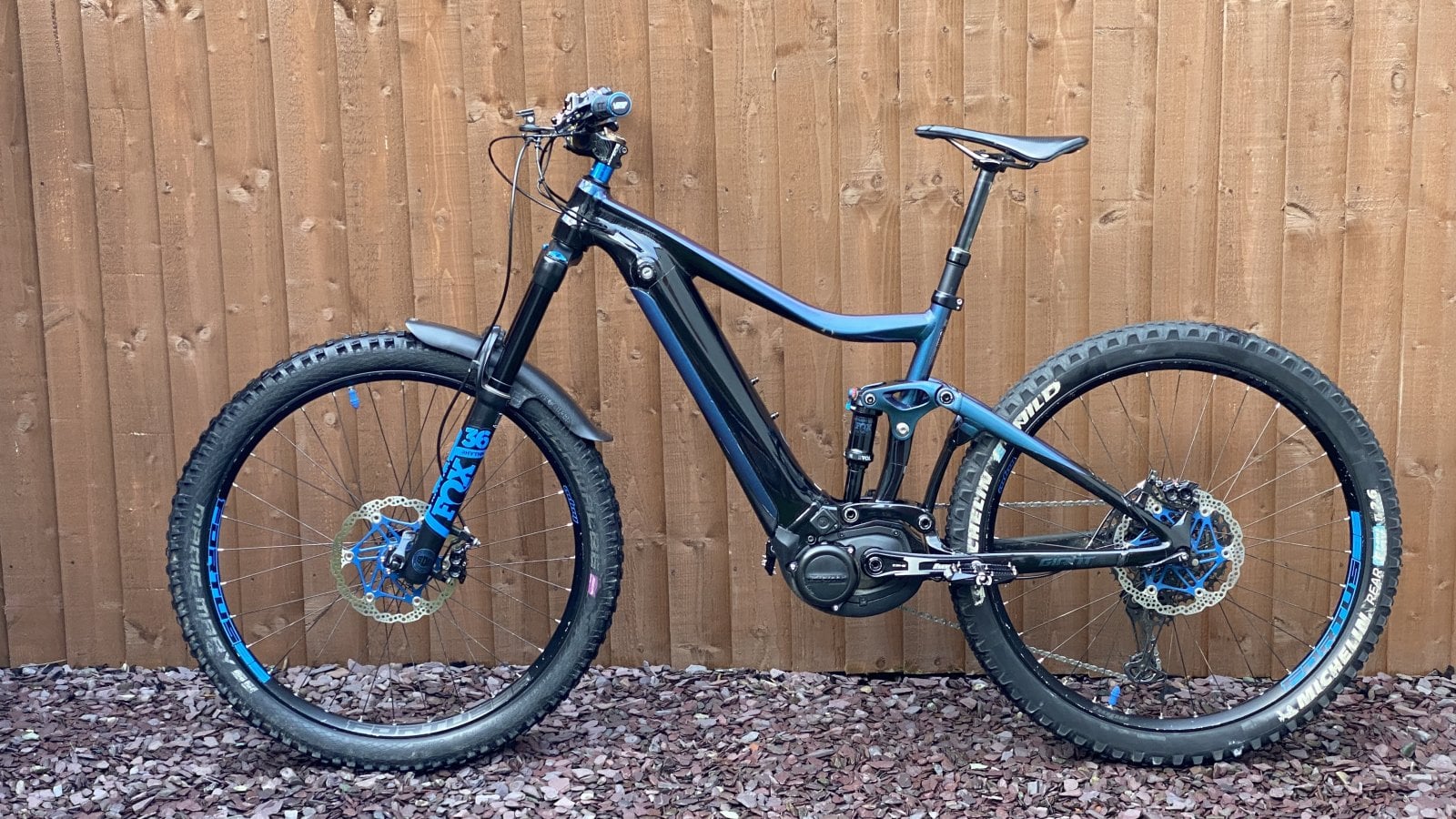

I have likely detailed it elsewhere but here is my tale of woe… (I’d grab a coffee)
MY20 Giant Trance E+2 Pro
Collected brand new: Feb 7th 2020.
This bike was a trade up for my rejected MY19 E+3Pro Which had a hub, a motor, a fork, 3 controllers and was generally nothing but trouble. 🤨

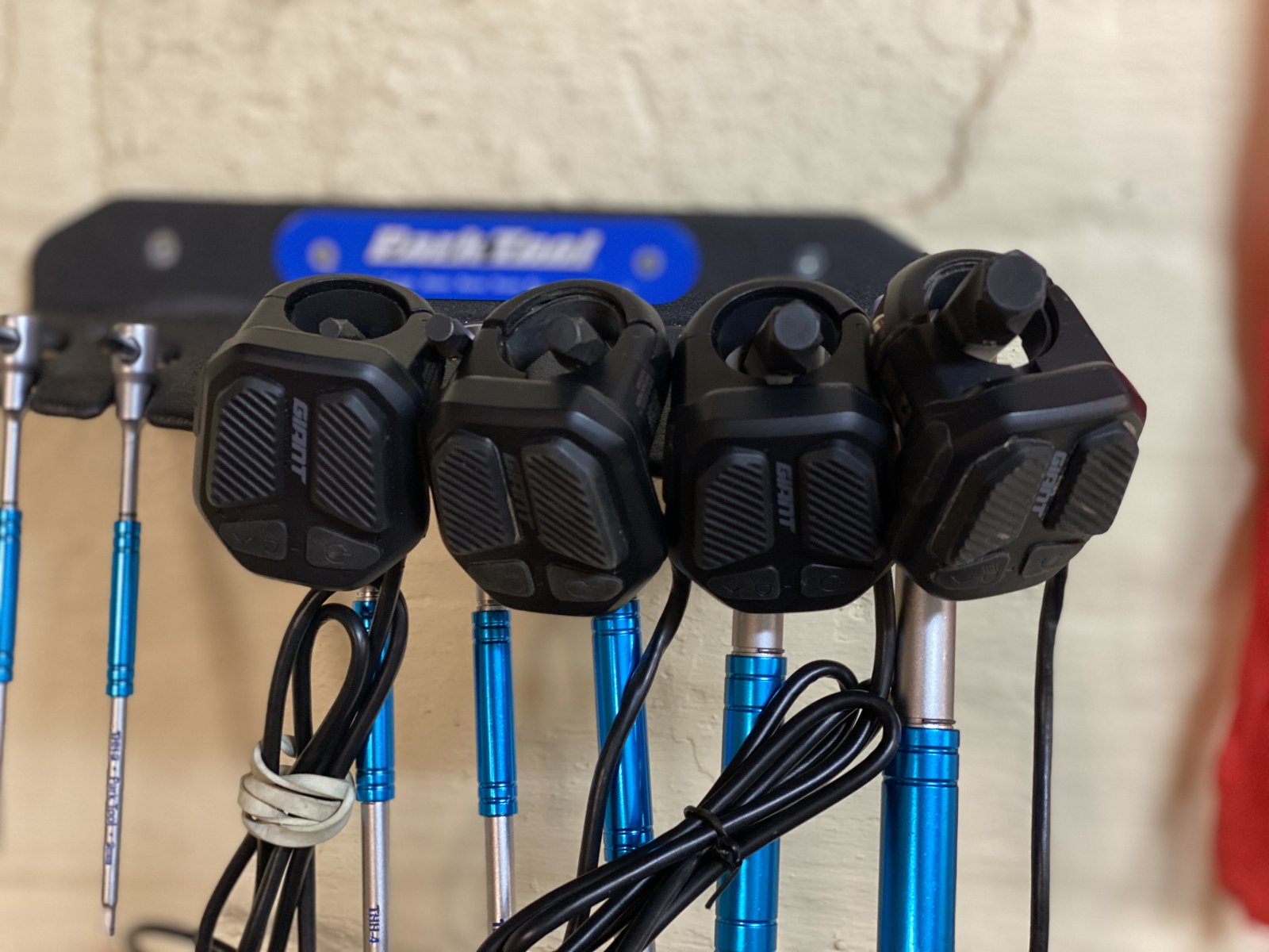

5th March = Ride One Controller failure (FLED28-10)
Had to wait a week for a new one to come
New one fitted and lost auto mode and ANT+ as they installed controller for a 2019 bike. (FLED28-07)

6th September = Ride One Controller failure
1 week wait until new one arrived 14th September (FLED28-10)
22nd November = Motor failure (2nd Motor failure)
26th November, her 3rd motor was installed.
14th December = Ride One Controller failure
1 week wait until 20th December. (FLED28-15 this time.)

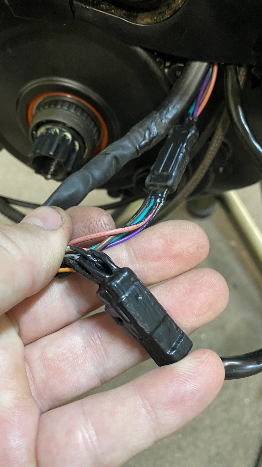

You can see the cover in my video and the terminal insulator can be seen in this pic alongside the Giant version on my other battery.
and my wiring is always waterproofed like this:
As end users, I don’t think we can do any more.

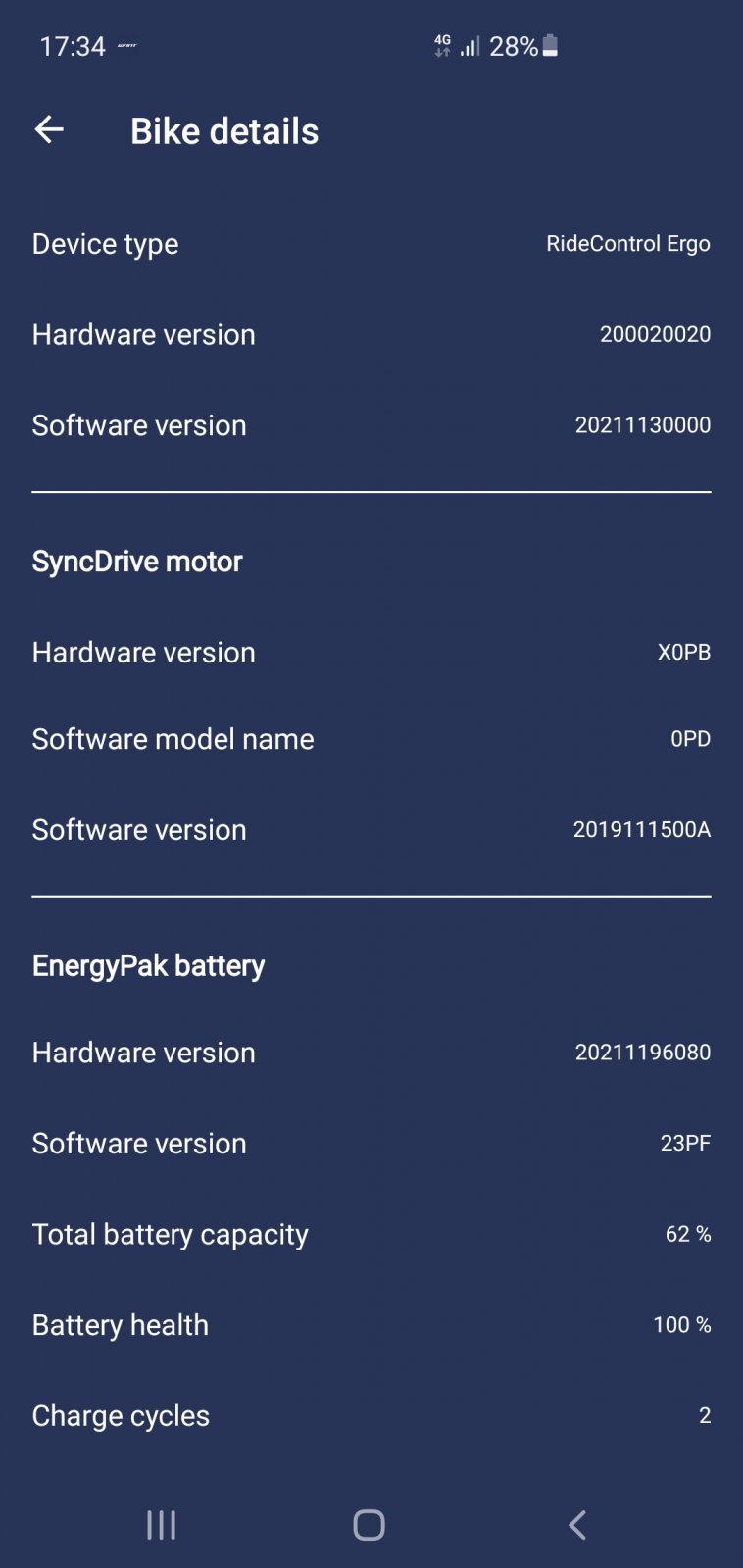

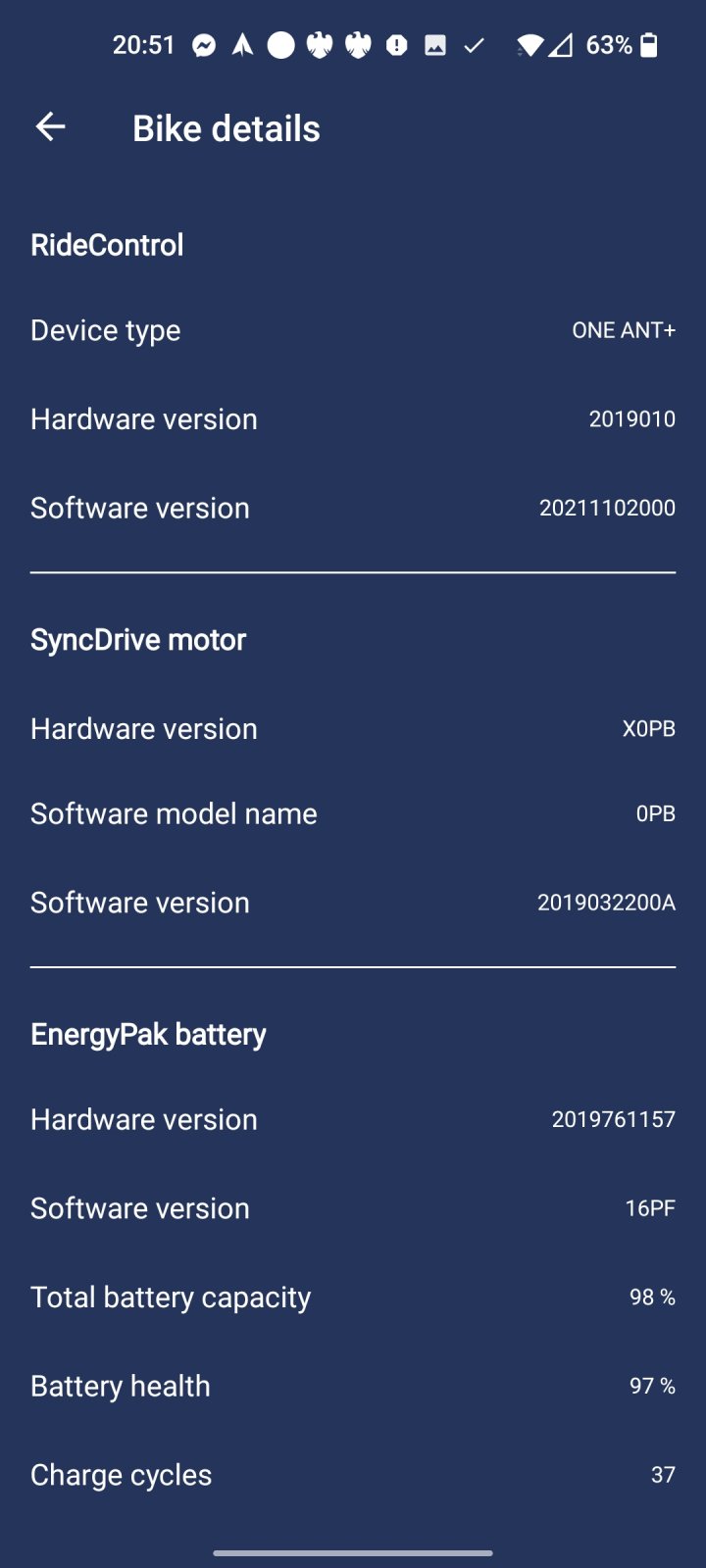

Mine is right now after a firmware update
Good to know mate.

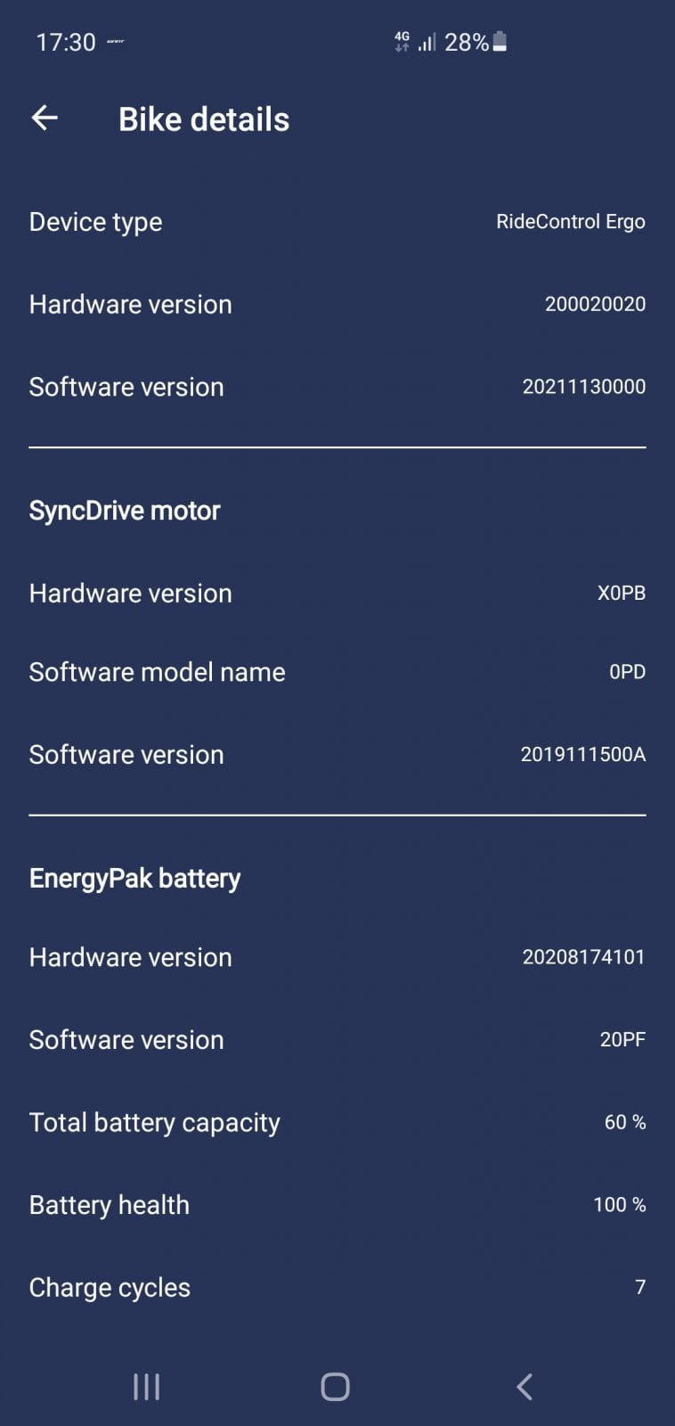

Would you be so kind as to hook up the App and let me know your battery capacity and firmware version?
I’ve been collating firmware numbers from tens of people all over the web and I have developed a picture of who will and wont have issues with these damn bikes now based on battery firmware.
Thanks.
Appreciate that pal. Yours is the first factory upgraded firmware I have collected a version number from.

Good to know mate.

Ah, ok
Apparently only the RC1 and motor unit can update via the app.
The battery can’t be updated via the phone App allegedly, it has to go back to Giant. Or so Giant say, but I do have that in writing from Giant UK too.
That said…
Your app screenshot shows a different firmware to any I have seen, and I’ve collected about 20 so far.
Last time I checked (Just prior to Xmas) another annoyance was that the phone app showed the battery software version in a different 4 digit format to the dealer tool , making diagnosis even harder.
Example:
Software Ver. 01710 on the app, is software version 0x11 on the dealer tool.
Crazy.
I wonder if the newest version of the app changed that?
Will check tonight as I have all mine saved as screenshots.

I your video you say that there's a connector for the bus up by the battery lock, (red connector I think) but on my bike I'm sure that is battery power on the red wire and from memory 1.5v 'wake' on a purple (?) wire. I did wonder what the battery power wire was for, but on the early bikes it doesn't go to the charge port so maybe that red connector is to supply the programming voltage when there's no battery output present?
I've since ordered a different bike, but got messed around by a shop claiming to have stock that they didn't have, so after months of waiting and getting lied to I've cancelled the order. Cost me £256 because the twats have had me stand the cost of the currency exchange both ways, which I'm not sure is right given that it wasn't really a cancelled order, it was an unfulfilled order on their part.
Thanks folks I joined here to see what the state of ebike tech was now its a bit more mature and was eyeing up a trance e , put me right off this has
I can’t remember what was on the second upper connector colour wise to be honest.
The loom is a little different to the 2019 version I originally pinned out.

This is what I like to hear, my data has saved someone’s ride and a long hard ride back with no power. Brilliant! 👌🏼😎
I wonder how many folk globally have ridden these expensive bikes home with no power now due to these wierd issues? 😖
Interesting that your identical bikes have different battery hardware AND software versions eh?
Would you be so good as to workout and let me know which of thosebatteries was the one that would power BOTH bikes please?
20PF or 23PF?
The latest firmwares have changed the numbering convention which has thrown me a curveball, but If the numbering convention is working how I think it is, the answer will be 23.
Spot on......the battery that is able to run both bikes is the 23PF. That seems to have the battery hardware with I imagine the year 2021. My son's bike which was bought in the summer has a prefix "date" starting 2020.......wonder if Giant can update hardware to my version. Strange that the bike is now back to normal and in 250 odd miles this is the first abnormally to have hit us. I will see what Giant have to say and pass on any info.
Good, Im pretty sure my little database of troublesome bikes battery firmware versions is becoming useful enough for me to spot the patterns.

Are your batteries both 625s?
I have one of the first available 21 trance x's in the US. My battery software is 17PF. I've only had one issue with water after a wash where the bike failed to turn on. Besides that it's been faultless (knock on wood).
I would like to preemptively have the software updated. Can any Giant corporate dealer do it?
