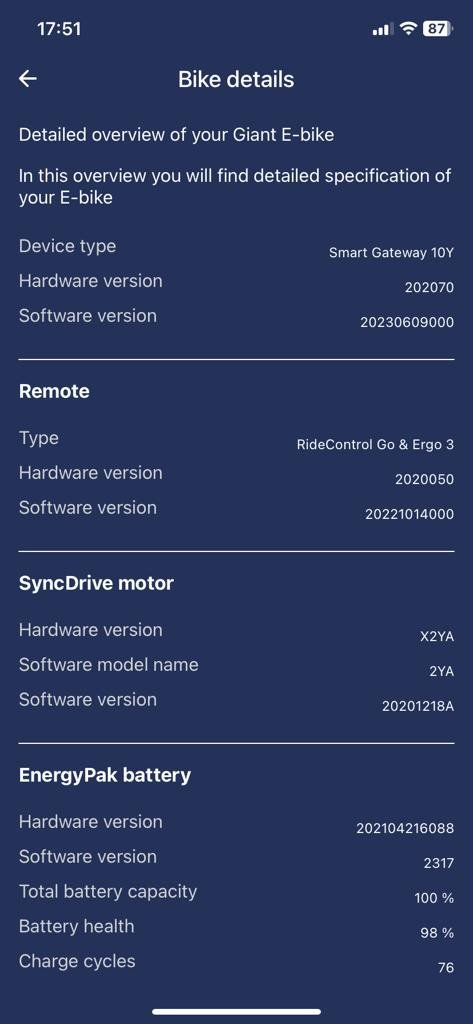

Good afternoon colleagues!
I went for a ride after an incident where the battery didn't charge fully when charging on the bike. After the ride the battery was discharged to 68% . Then I took the advice of (Evolution Stu))) cheers🍻) charged separately from the bike and everything went to 100% charge! But going into the application I saw the readings of the distance traveled during the entire time of use 55 km, earlier this figure was equal to 4675 km.
Apparently there was a zeroing or memory buffer or what to call it guys ???: не уверен::D
