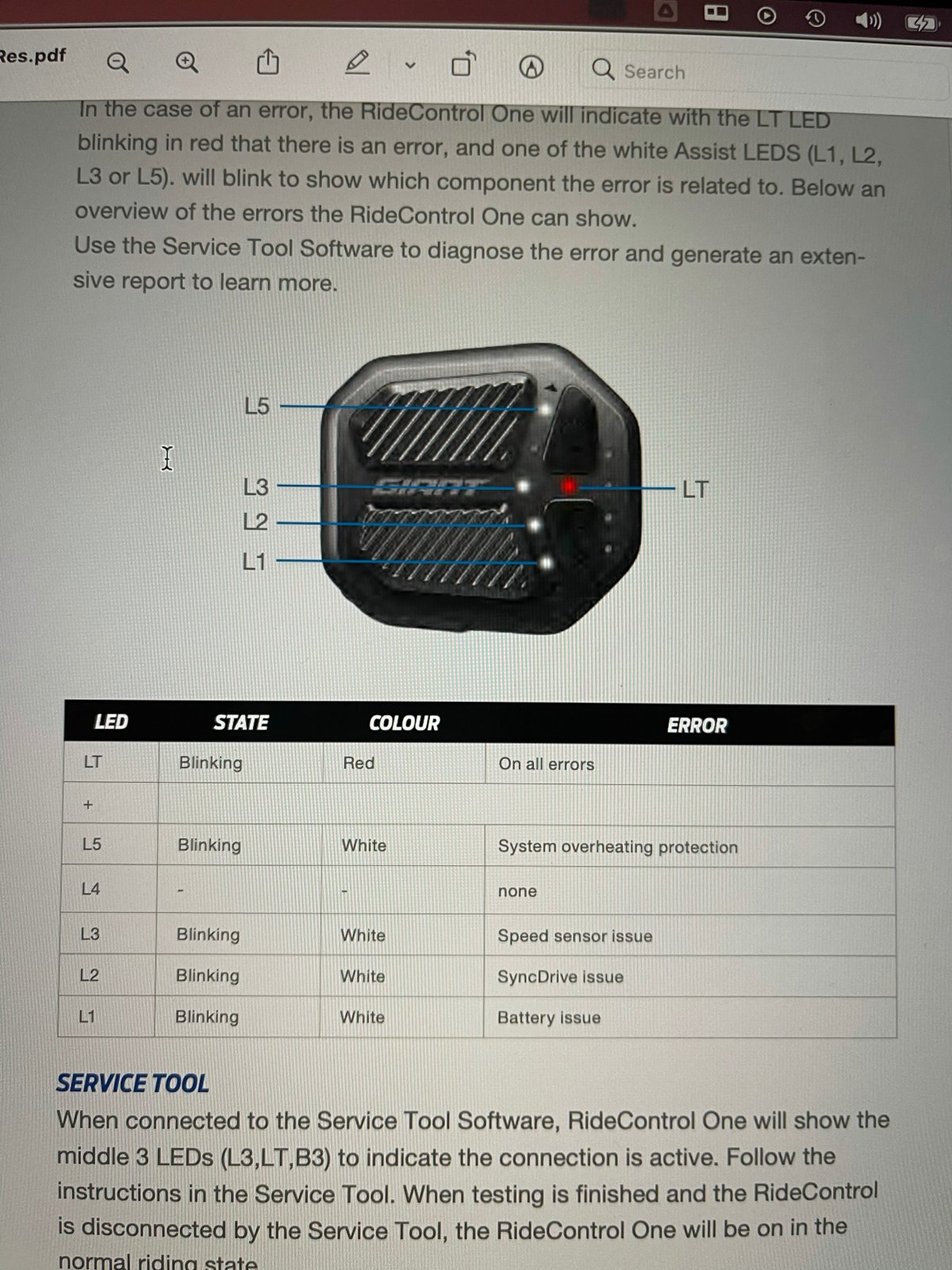

The middle power light was RED. And I think the L5 was lit. Googled and this came up:
Looks like it was over heating.

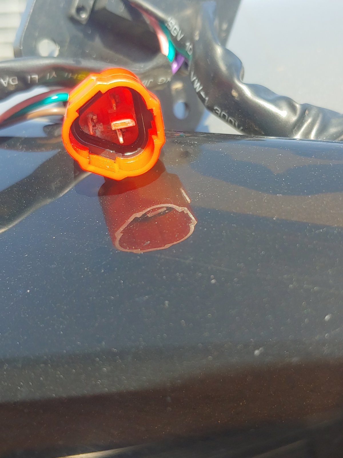

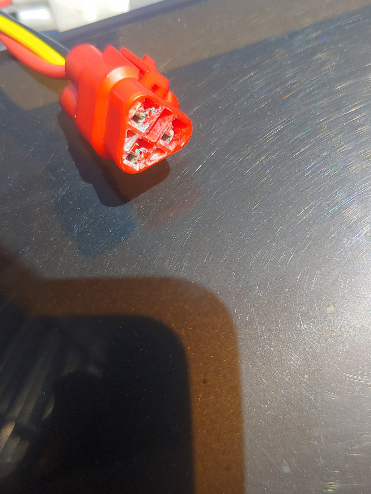

The tech at the dealer where I dropped my bike off discovered a corroded connector below the socket bracket which was likely the culprit to blame for the temporary shut down of my Trance. He thinks that all the connectors should be checked as a necessary precaution. Not sure if this is this is the solution for everyone who has been experiencing similar electrical gremlins with their rides but i think that it's a good start. The tech cleaned up the affected part, applied dielectric grease, updated the firmware and replaced the harness to boot. I pick up the bike tomorrow morning and will go for another test ride to confirm that all is well. He plans to submit his findings to Giant Canada. Thanks to Don at Red's in Lacombe, AB for going that extra mile for me. (y)
