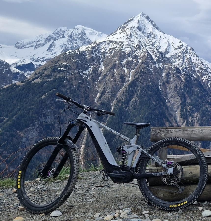

Lots of steep riding here in the French alps , coil at the back was the way forwards. Ride it in high position on maxiss 2.4 dual ply. Fork was sent to get tunned so it rides a little higher. but still plush.
I kept 170 mm as its already in 63 degree head angle in high position. The coil kept it much higher and still very sensitive.

I've been running the 180mm Zeb and 65mm stroke Super Deluxe Coil ultimate (~166mm rear travel) for a while now. Works great! To me, the Maestro suspension is plenty progressive for coil, and I'm running a 400# spring (178lb rider w/out gear). The hydraulic bottom out feature helps, but I've only needed to run it on setting 2 or 3 out of 5.
I've got the 180mm fork and the flip chip in high position and am pretty happy with the geo. As expected, it feels similar to stock geo in low position, just rides a bit higher overall. I still get pedal strikes here and there, but it's definitely improved over stock. I am running more sag in the rear with the longer stroke shock, but that shouldn't equate to more than a few mm of bb drop.
I even thought of throwing a RockShox Boxxer dual crown fork on here, but I guess this is hardcore enough for now, lol. I met a Giant rep out at a demo day and he did it with his Reign E+ with Fox 49s. So it's doable... but I think I'll stick with this setup.
I will say tho, this bike feels like overkill for more mellow trails that aren't about flat-out speed and mega-chunk. I weighed it at 56.5 pounds on my bathroom scale. Which is why I got a Trance Elite on the way! I plan on giving it the same travel treatment (+10mm on the fork, upstroke shock to 55mm) to make it feel more aggressive trail than its stock geo setup. Man, if Giant comes out with a lightweight, Reign E+ Elite that is dual-crown compatible, it's game over. One Reign to rule them all!
