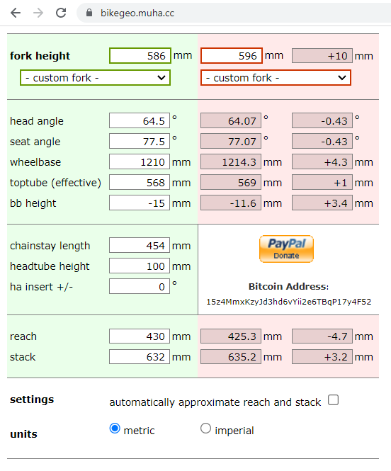

According to this bike geo calculator, going from 170 to 180mm fork is going to increase the unladen bike's wheelbase by 4.3mm. Doesn't seem like an undesirable change to me... but I want my Reign E+ to feel as much like a DH bike as I can reasonably get it to.
I entered in the Reign E+ size small geo in high position and added 10mm axle to crown to see geo changes. The resulting numbers are very similar to stock low position, just with a 5mm longer wheelbase and a 13.4mm higher BB.

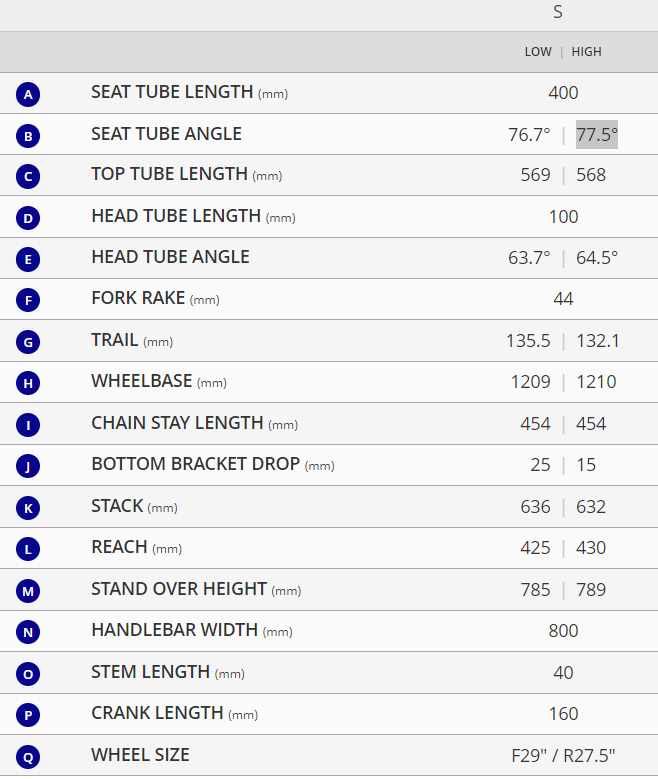

2023 Reign E+ 3 geo for reference:

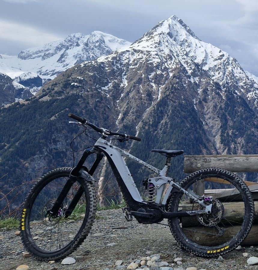

Lots of steep riding here in the French alps , coil at the back was the way forwards. Ride it in high position on maxiss 2.4 dual ply. Fork was sent to get tunned so it rides a little higher. but still plush.
I kept 170 mm as its already in 63 degree head angle in high position. The coil kept it much higher and still very sensitive.
Its an M size and still have 160mm cranks

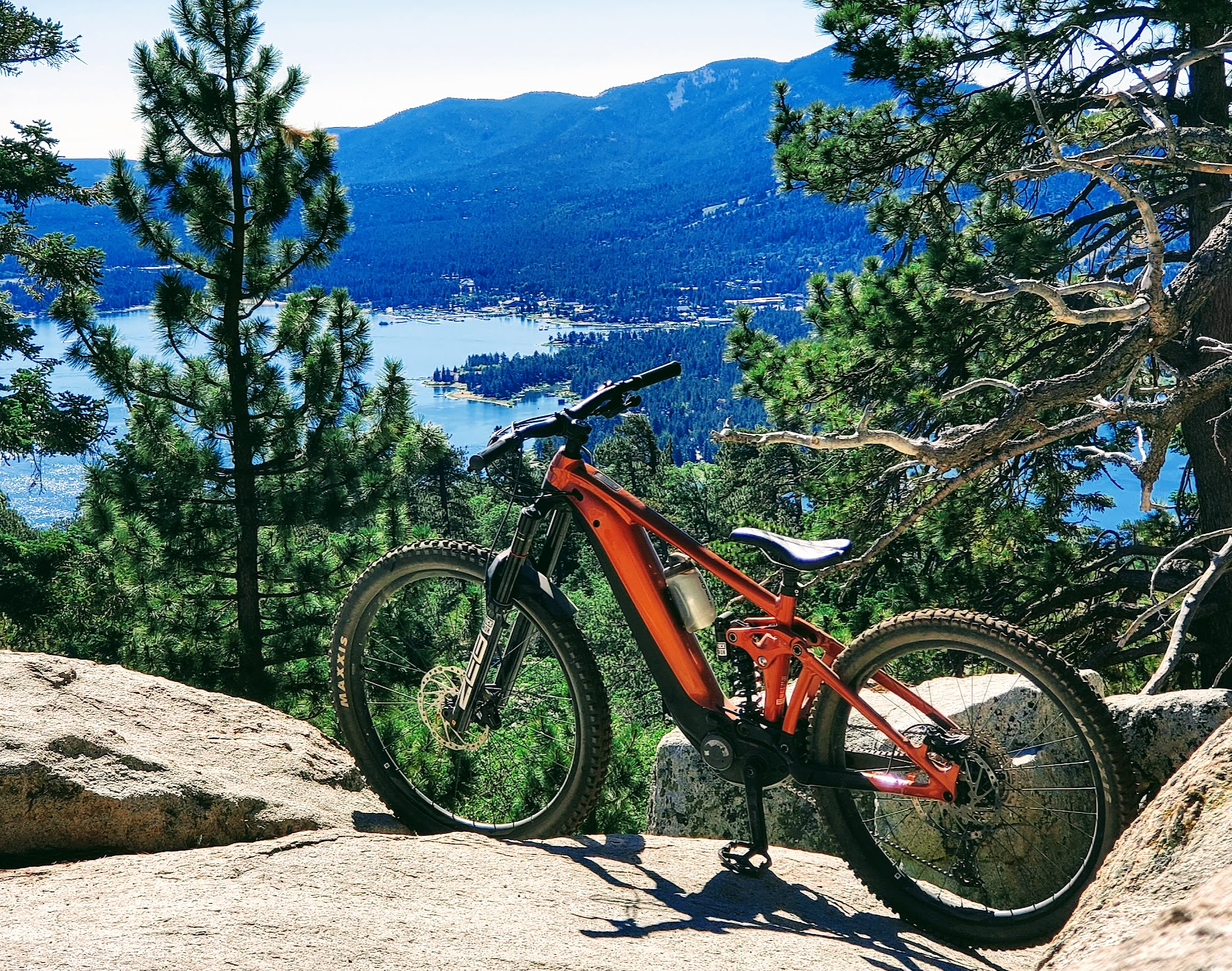

So I weigh 181 lbs, i run a ichu spring 500*2.6 it is not a progressive spring but my shock, fast fenix has hydraulic botom out resistance/ bumb stop, it becomes progressive in the last 15/20% of travel. You also have a knob to play with the mid stroke settings and has a climb lock out. You could look at a bos stoy rare, or an Ext storia. A fox dhx or rs will need a progressive spring. I had a fox X2 which was a disaster then tried a Rs deluxe still wasnt great for the terrain i ride, big enduro technical steep rooty rocky alpine terrain. I'd live in a smoother area, air shock would probably be great.
Thats pretty much the terrain i can ride daily. you'll start on rough rocky terrain go through high grass lands then step rooty forests . Grip for uphill has increased aswell. As for the fork when i had to service it i sent it to a reputable tuner and asked him to do a few mods.to ride a little higher with out loosing too much comfort. you can already try by adding volumes spacers.
I love this frame and motor but i ended upgrading a fair bit.:ROFLMAO:

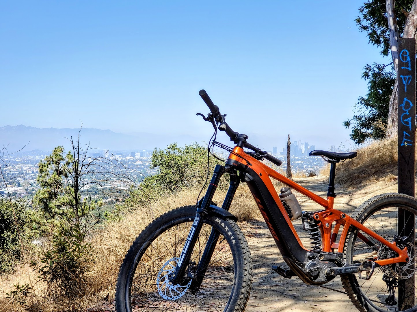

I've been running the 180mm Zeb and 65mm stroke Super Deluxe Coil ultimate (~166mm rear travel) for a while now. Works great! To me, the Maestro suspension is plenty progressive for coil, and I'm running a 400# spring (178lb rider w/out gear). The hydraulic bottom out feature helps, but I've only needed to run it on setting 2 or 3 out of 5.
I've got the 180mm fork and the flip chip in high position and am pretty happy with the geo. As expected, it feels similar to stock geo in low position, just rides a bit higher overall. I still get pedal strikes here and there, but it's definitely improved over stock. I am running more sag in the rear with the longer stroke shock, but that shouldn't equate to more than a few mm of bb drop.
I even thought of throwing a RockShox Boxxer dual crown fork on here, but I guess this is hardcore enough for now, lol. I met a Giant rep out at a demo day and he did it with his Reign E+ with Fox 49s. So it's doable... but I think I'll stick with this setup.
I will say tho, this bike feels like overkill for more mellow trails that aren't about flat-out speed and mega-chunk. I weighed it at 56.5 pounds on my bathroom scale. Which is why I got a Trance Elite on the way! I plan on giving it the same travel treatment (+10mm on the fork, upstroke shock to 55mm) to make it feel more aggressive trail than its stock geo setup. Man, if Giant comes out with a lightweight, Reign E+ Elite that is dual-crown compatible, it's game over. One Reign to rule them all!
