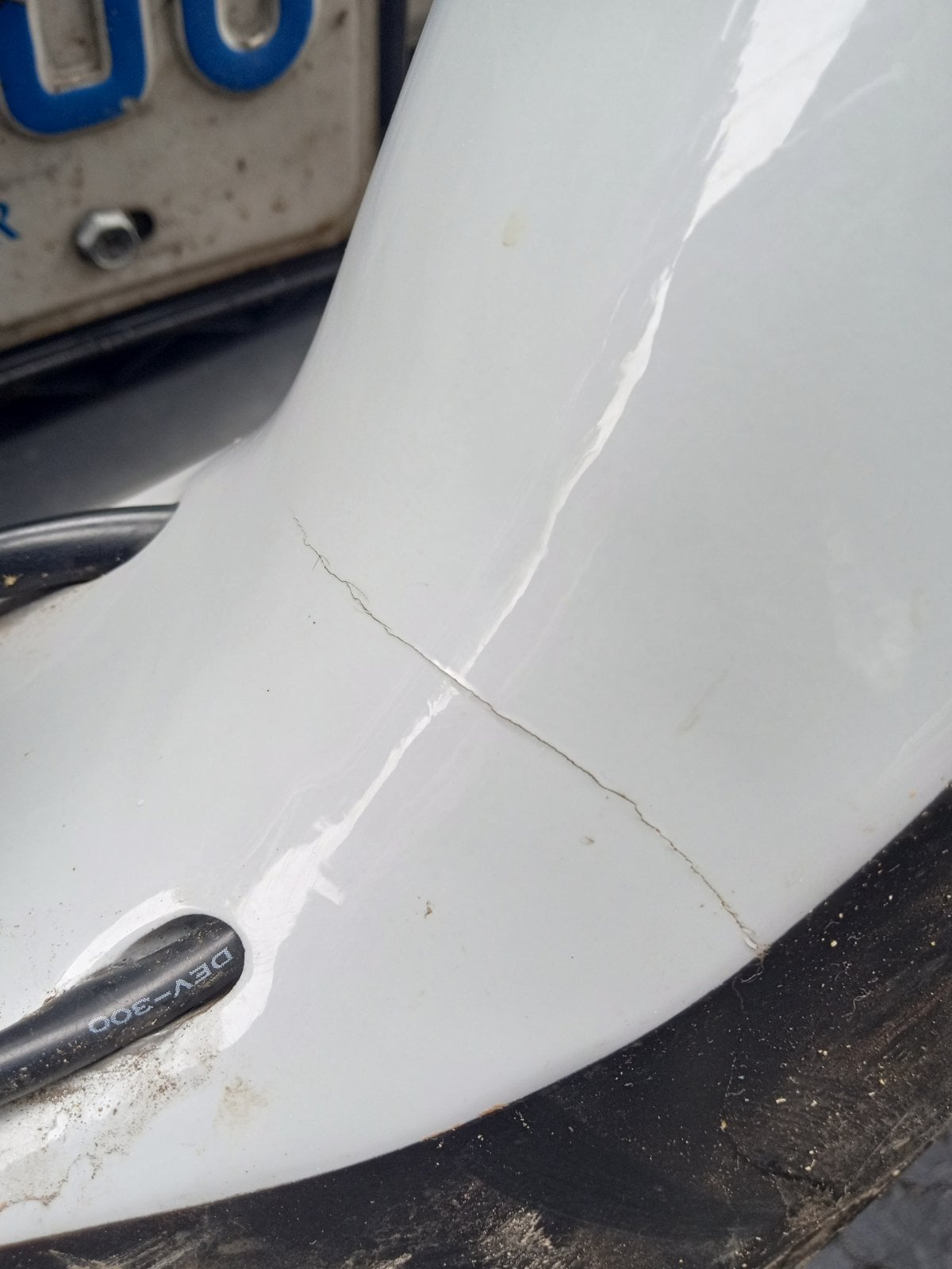

Giant have confirmed that the issue is with a filler used over the top of the welding that is, under stress, flexing and then causing a paint crack, no structural issues. Giant have categorically stated the bike is safe to ride and they are currently pursuing long term solutions with the factory for anybody who has had this issue. They say it’s 100% safe to ride.
So at least we can ride the bike now!
Not sure what the long term fox is though!!

How does it look like inside? Your crack is huge. If there is a structural damage you might see it inside under the battery. Although it may be hidden under the bracket that is welded there to the frame.
I don't want to be a pessimist but it smells like a VERY good candidate for not only a warranty issue but a full blown recall. It's very hard to believe that there is no structural damage underneath.
Only way to be absolutely sure is to carefully completely strip the paint off for at least 20mm each side of the crack. Is what I would do if only for my peace of mind. If there's no underlying crack it can be easily painted over.
Problem is that it might void the warranty.
Are they doing anything about the paint cracking? It can only get worse. It needs foxing now! :ROFLMAO:
Only that they are in talks to find a solution. Not really sure what that means at all. All the bike shop has been told is that the bike is safe to ride and it’s not the frame that is cracked just the filler over the welds flexing and cracking! All I can think of is that they are going to have to make new frames and send them out! That will take forever!!
Filler or a spackle? Filler sounds like it's some kind of material designed to be there. If the aluminum underneath looks like crap after hydroforming and welding the bracket, maybe they used good old spackle. It actually might make sense if this is the case.

It's a thing that you will find under a paint of some repaired cars. It's there to fix imperfections in the car's sheet metal. Sometimes it causes the paint to crack when the underlying metal moves.
Wow lots of great info and discussion in this thread. Curious to know how widespread this is so chiming in with one from Canada.
Another one in exactly the same spot starting from the mid point in the tube cracking down through the drive side.
So now we have cracking in Canada, New Zealand, Wales & the USA. Seems like the "bad batch" theory is out the window
The only thing that gives me confidence to keep riding the bike is that no-one has cracks on the inside. See.tomdit the explanation above its a filler cracking and not the actual frame. I don't have it yet, and would of thought I would have it by now so maybe just lucky. I know 4 people with one of these bikes and none of us have it. All do regular bike parks and ride alot

So one Reign is cracked right through and plenty of others showing cracks in the same place. You cannot categorically state its not structural when you don't know the details of each bike.

Top of page 3 of this thread... Might not have snapped in half yet... but can guarantee with more riding it will

Taken to shop today and it's fucked.
100 percent cracked.
You could run your fingernail easily in one direction and it would catch in the other proving there is a step /height difference.
LBS agrees and has started the warranty process.
As much as I absolutely live this bike I have purchased a Norco range vlt c1 as I have no longer have faith in the design.
Kinda blows the old aluminum doesn't fail theory out the window. Just tapping this area with your finger you can hear how thin it is.

The thin part doesn't add up. This frame is thicker than my grandpa's dandruff crust. It's so thick I couldn't believe my fingers. I thought the walls of the down tube must be hollow it's so thick.
