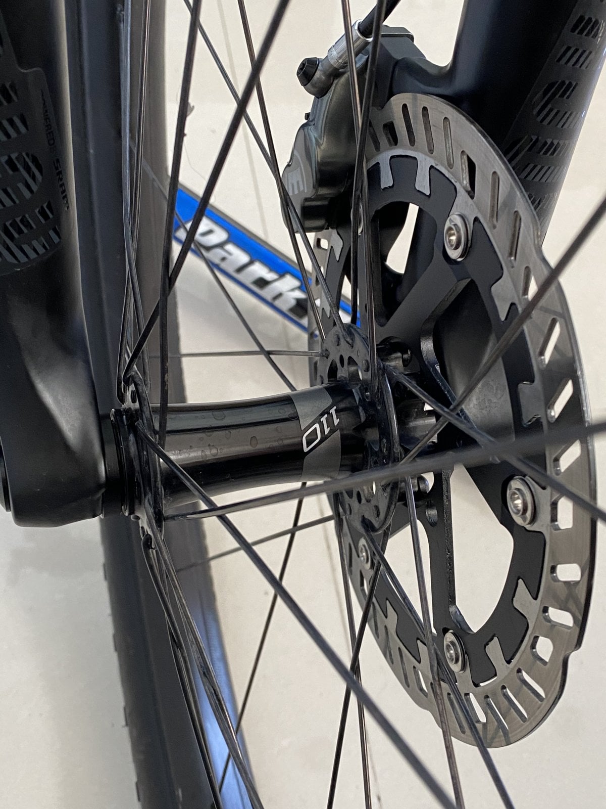

Well I got good news and bad news.
Good news is that the SWAT top cap/tool fits the fork! Just make sure that you turn the bottom
piece so that it sits nicely in the oval shape.

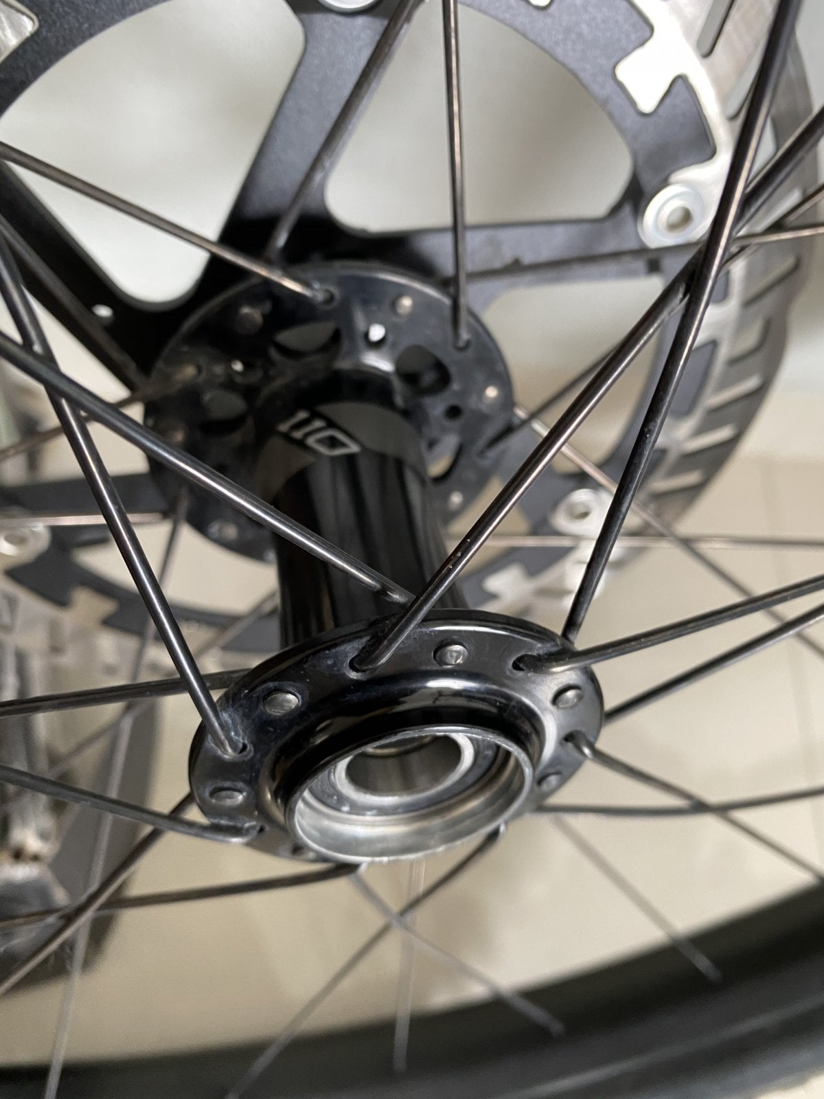

The bad news for me... I need new end caps for my stock Roval wheels. The fox has a smaller diameter drop-out. About 19mm. The end caps that came on my wheels are 31 mm. I believe this is because I had the Rockshox front fork. So if you are going from a Rockshox fork to the Fox fork, you may need new end caps like me.

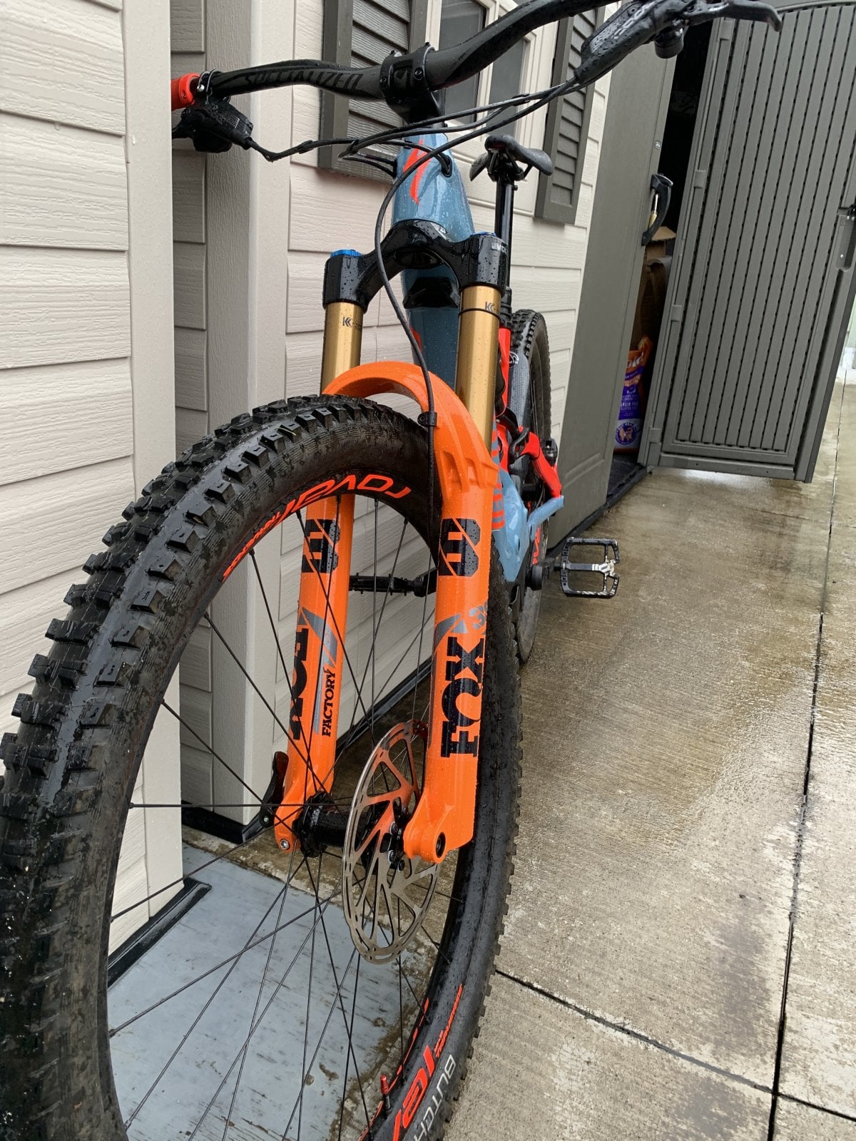

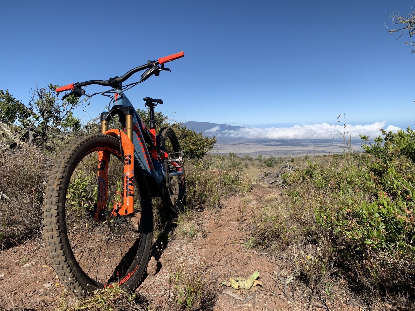

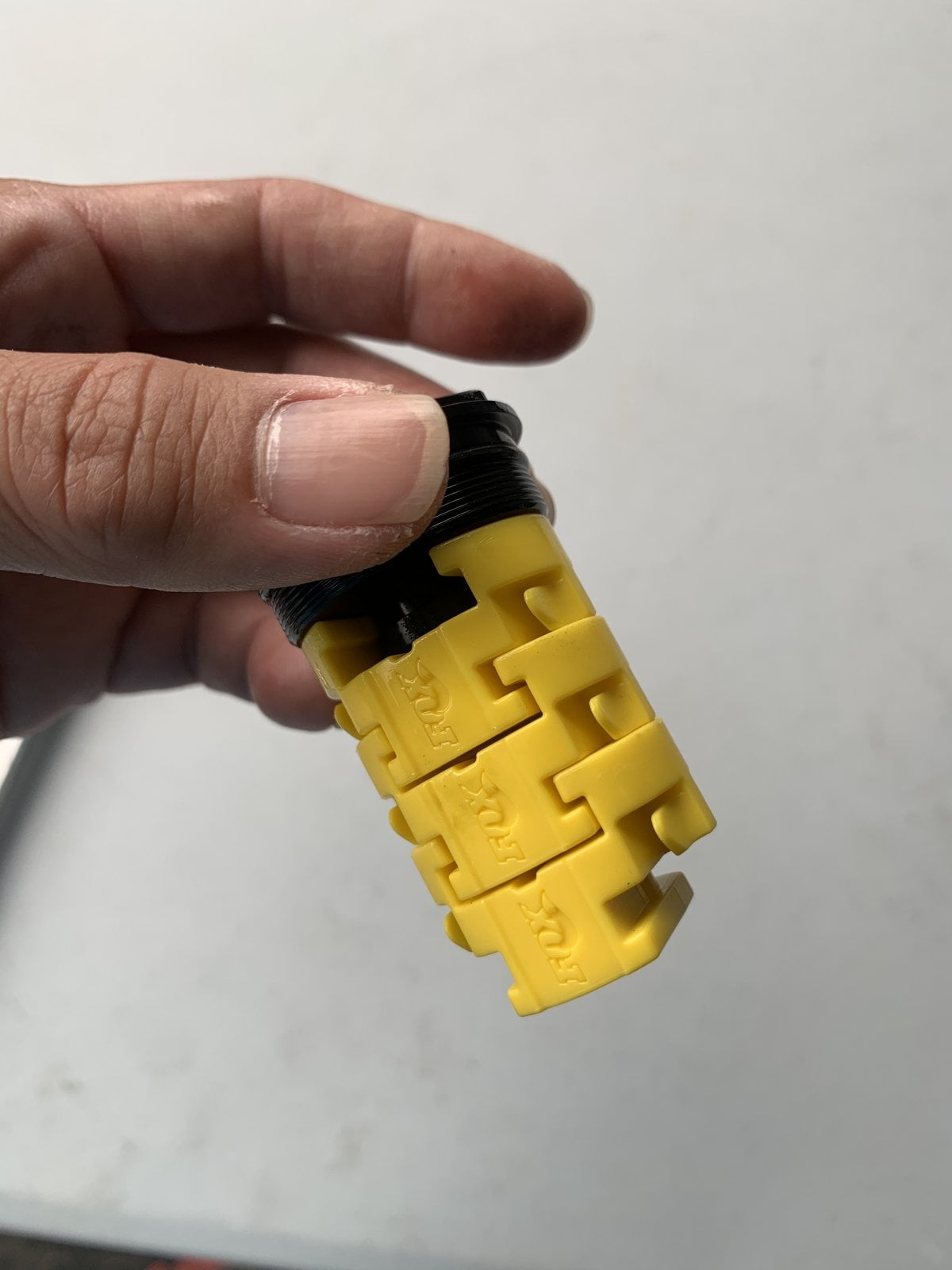

The fork came with 1 volume spacer installed. I could already tell that it was way too soft but I did a couple of jumps on my kicker ramp anyways. It blew right through all the travel on the fork. I weight 170 pounds and I had 95 psi in my fork at the time.
So I installed 3 volume spacers and increased the air pressure to 100 psi. Much better! I may even put one more spacer in too once I get this fork dialed in.
I still need to hit the trails to really tune it though. I currently just have everything set to the reccomended values according to my weight.
First impressions based solely on my kicker ramp and small backyard rooty yard....it’s waaayyyy better than the stock rockshox fork. So supple and smooth.

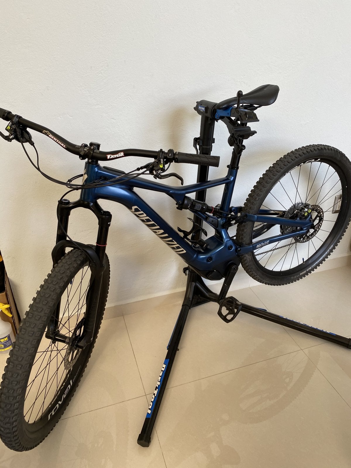

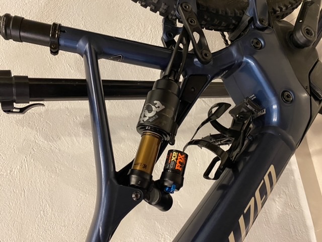

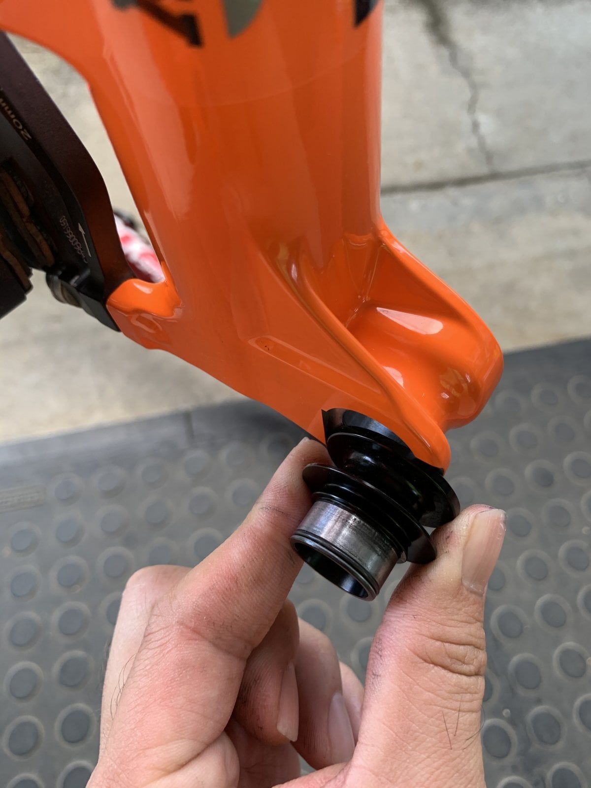

Finally my fork and shock arrived yesterday.
shock installed. No problems.

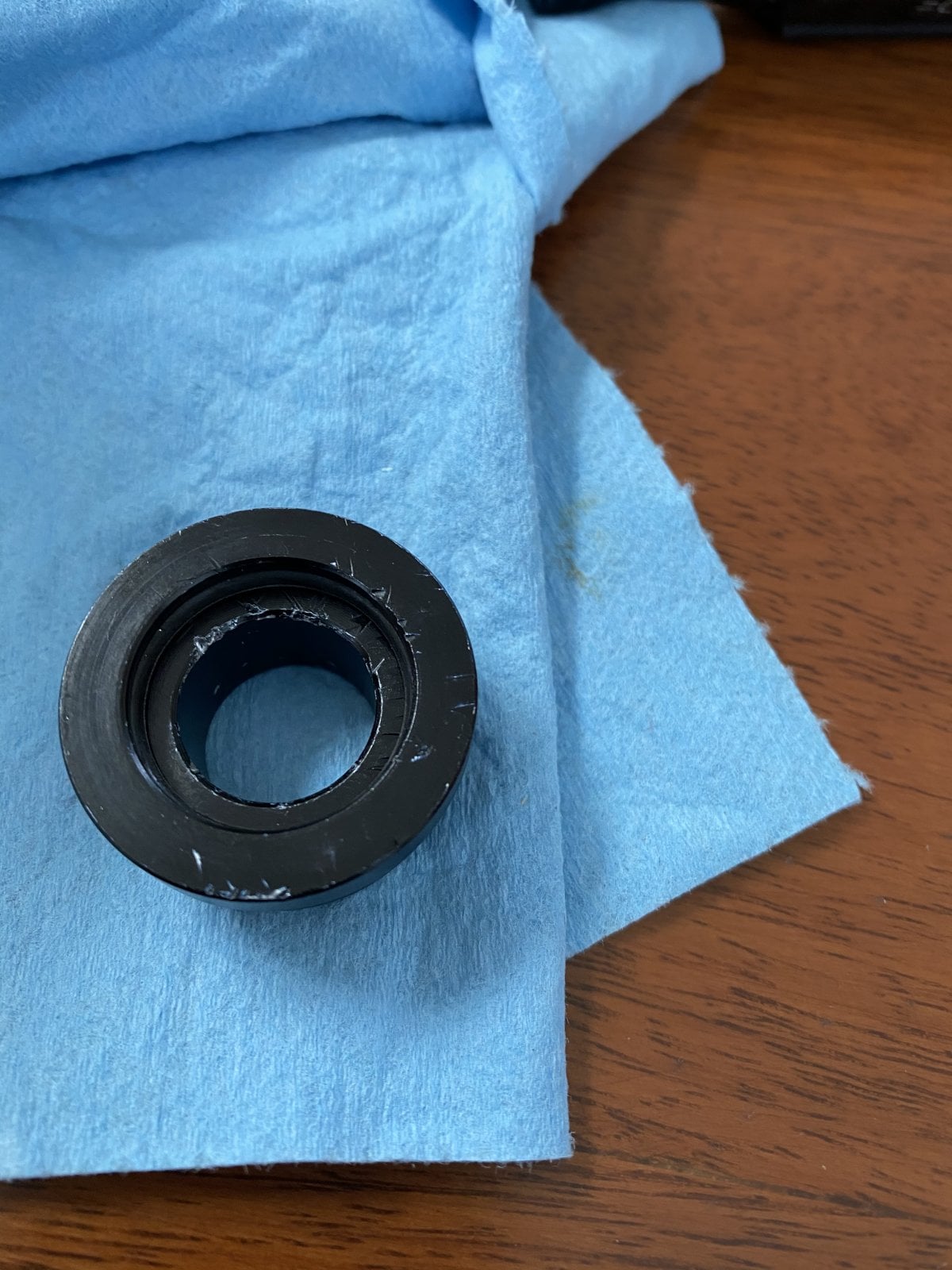

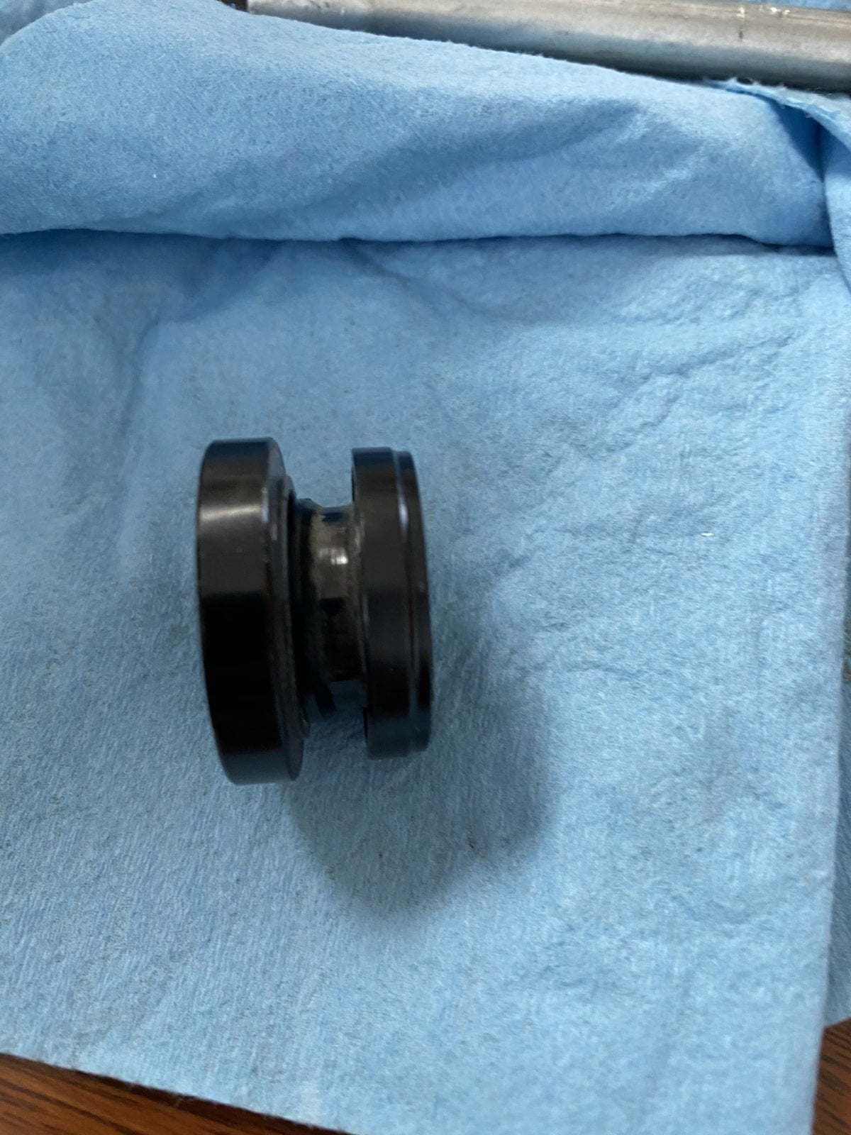

And because such is life in the fkn tropics, the end caps I bought (S19590001) are not compatible with my wheelset. Lol.

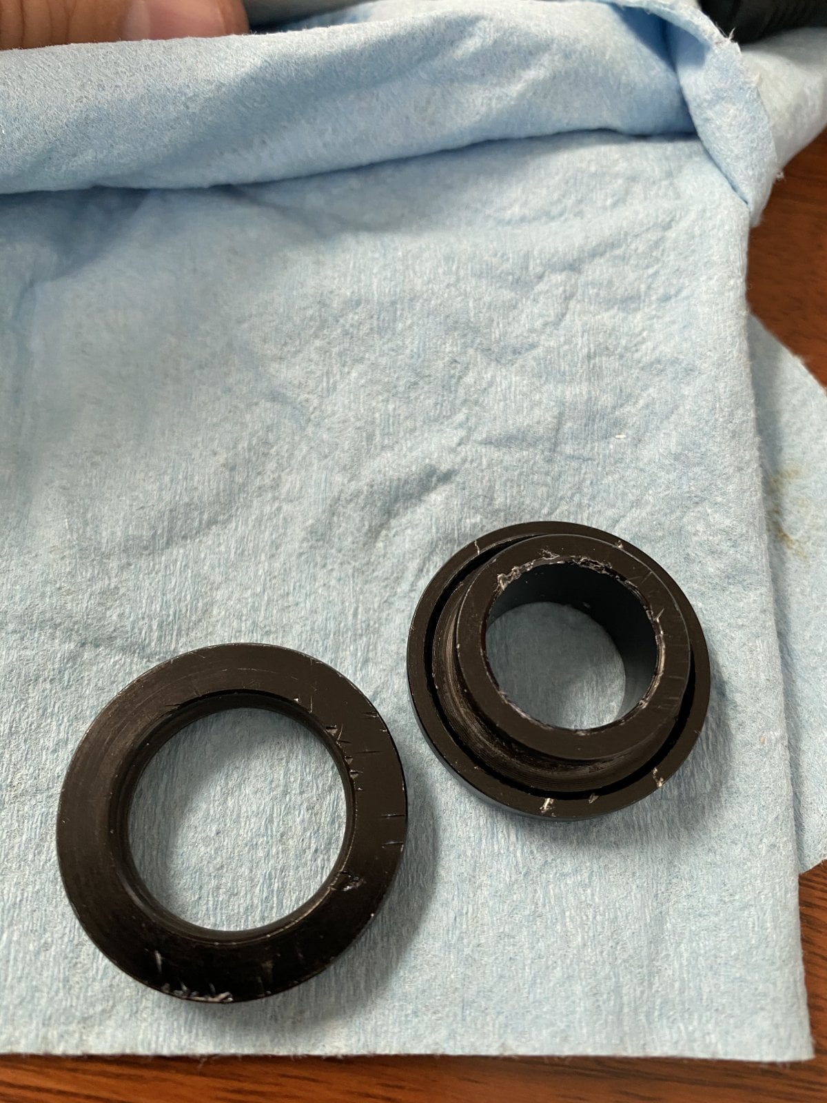

These below, are the originals. The diameter Of my bearing is bigger.
anyhow I noticed these can be split. And the inner diameter is correct (I think) for the Fox Fork.
I’m an animal and was mad at the notice, I made some scratches on the caps.

yes thanks. Everything sorted out. the end caps just split and install without the big rings that are for RockShox forks.
just a brief roll, but it feels amazing compared with the deluxe I had.
