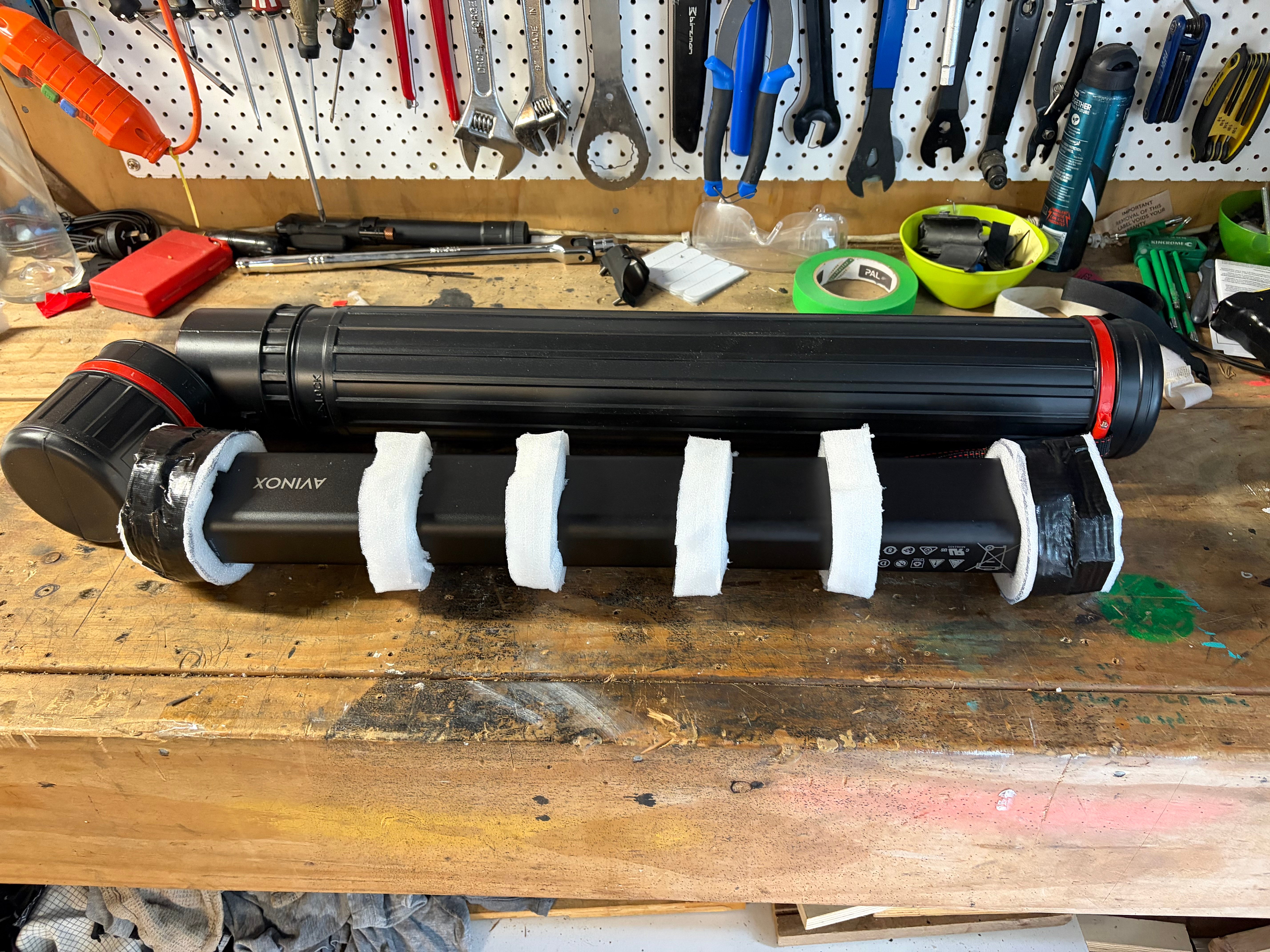

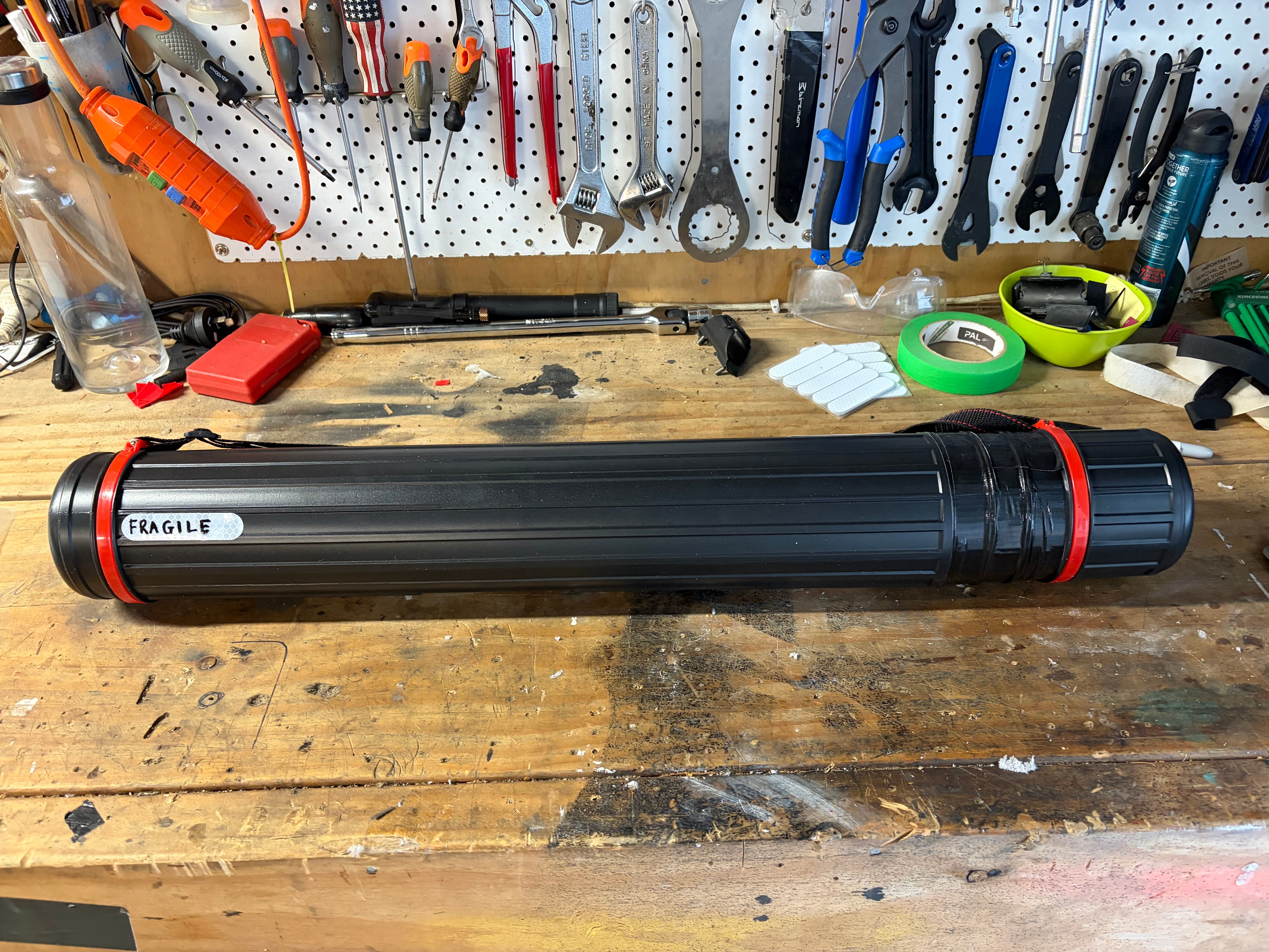

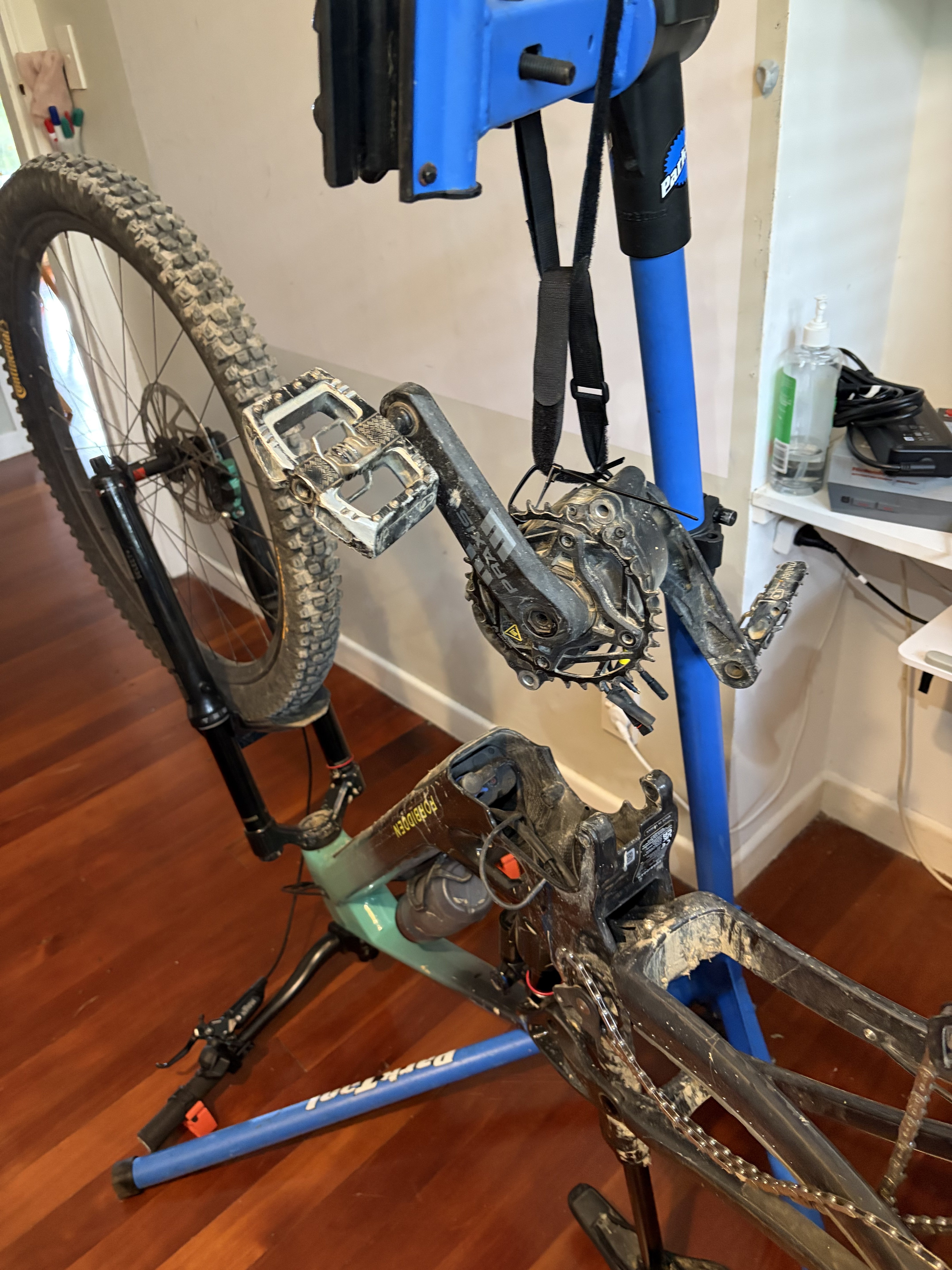

I'm heading to the South Island (NZ) from Auckland in a couple of weeks and decided to travel with my bike and ship the battery to a friend's place. The other option was to ship the whole bike in a box, but I didn't like the idea of having it potentially sitting around somewhere no where near me....
Motor and battery were really easy to get out. I used my bike stand as a mini-motor hoist to safely get to all the plugs.
Bike: With motor (incl. cranks and pedals) and battery removed and inside an Evoc bike bag, it weighs in at 24.4kg. Air NZ limit is 23kg, but they usually let you get away with ~25kg without an extra cost (can have up to 30kg with some extra $$)
Motor etc.: that'll travel in my luggage
Battery: I found a plastic plan carrier tube that is a really good size and made some foam rings / end padding out of old packing foam I kept (benefits of a garage!). This should be cheap to ship via truck/ferry between islands.
Hopefully it all works out!
