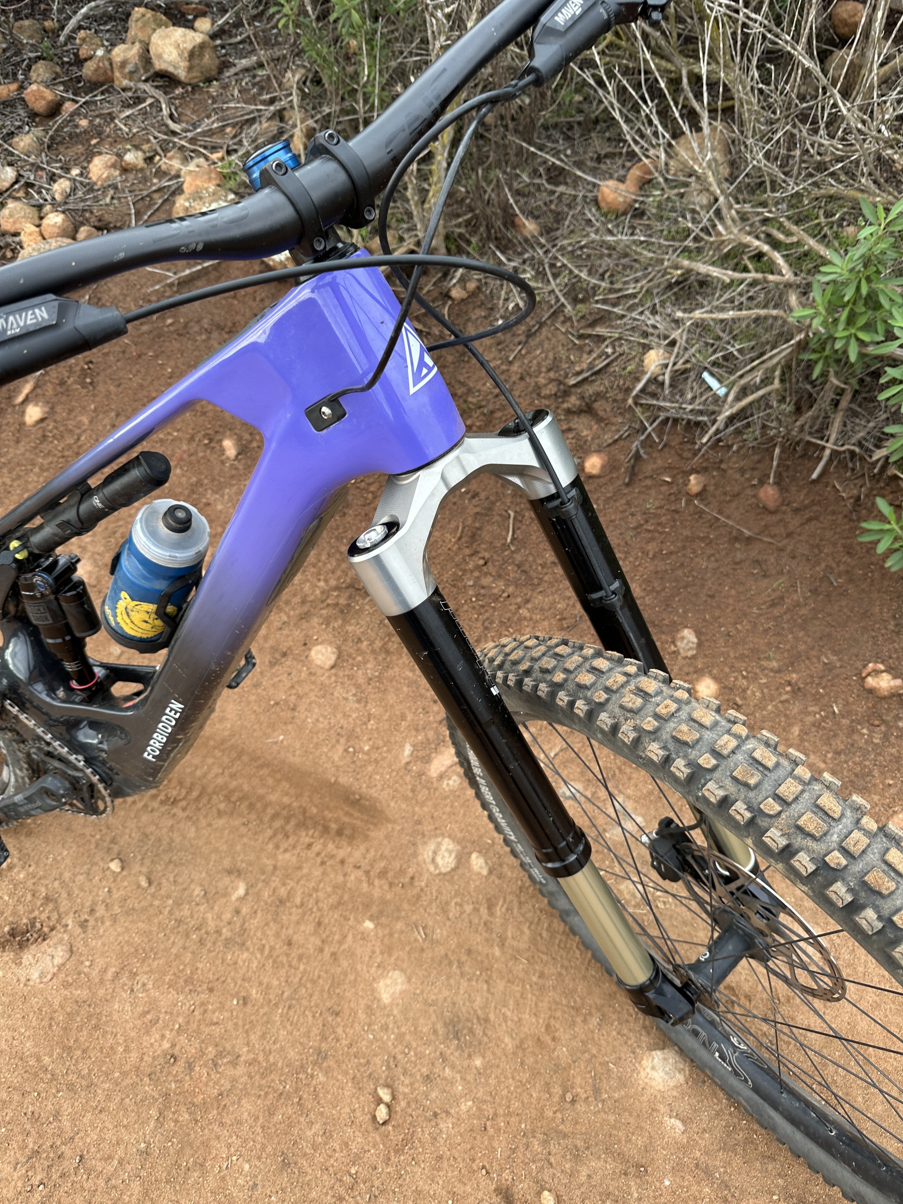

Had my first ride out with the 50mm risers today as well at a frozen but dry Golfie. Opened up the comp on the Zebs also , PBs everywhere 😎
Need to play about with the rear again, Might be a bit too stiff or too much HBO so I'll back that off a click as well and see how that goes as was struggling to get full travel on the back

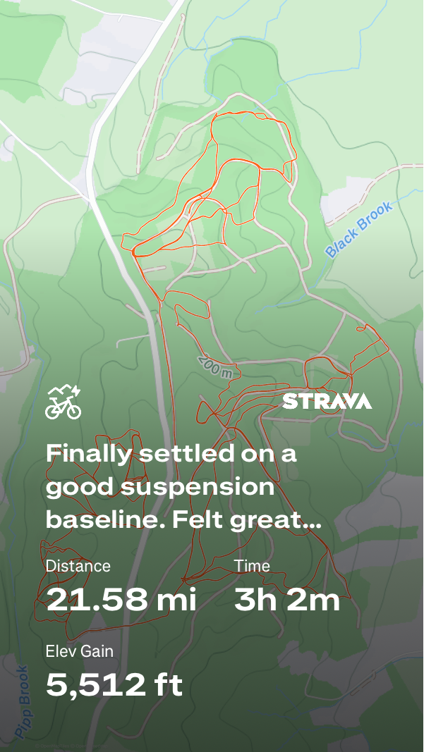

I have settled on just the 1 click of HBO. Anymore and it seems to deaden the shock

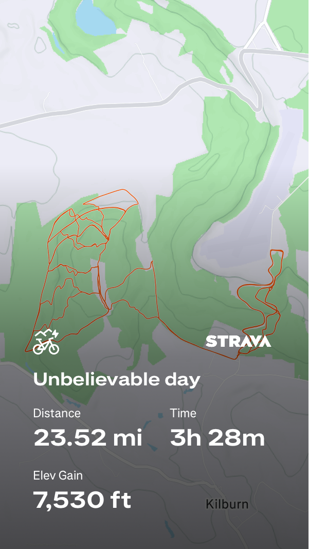

Managed a pretty big day off a full charge yesterday in -1 degrees. Used a slightly up tuned eco. Mate went through 2 630w shimano batteries in trail mode.
Defo buying a DJI 1000v2 and fast charger in the next month or so just for a lunchtime top up
Impressive stats and day out 👍 Must of been hard work with a detuned Eco climbing that much? It’s not the most efficient drive system with the idler and tight motor.
I did a similar ride in -1c conditions but stayed in a detuned Auto mode. 3% left once I got back to the van. Trails were running epic and finally happy with my suspension settings… for now.

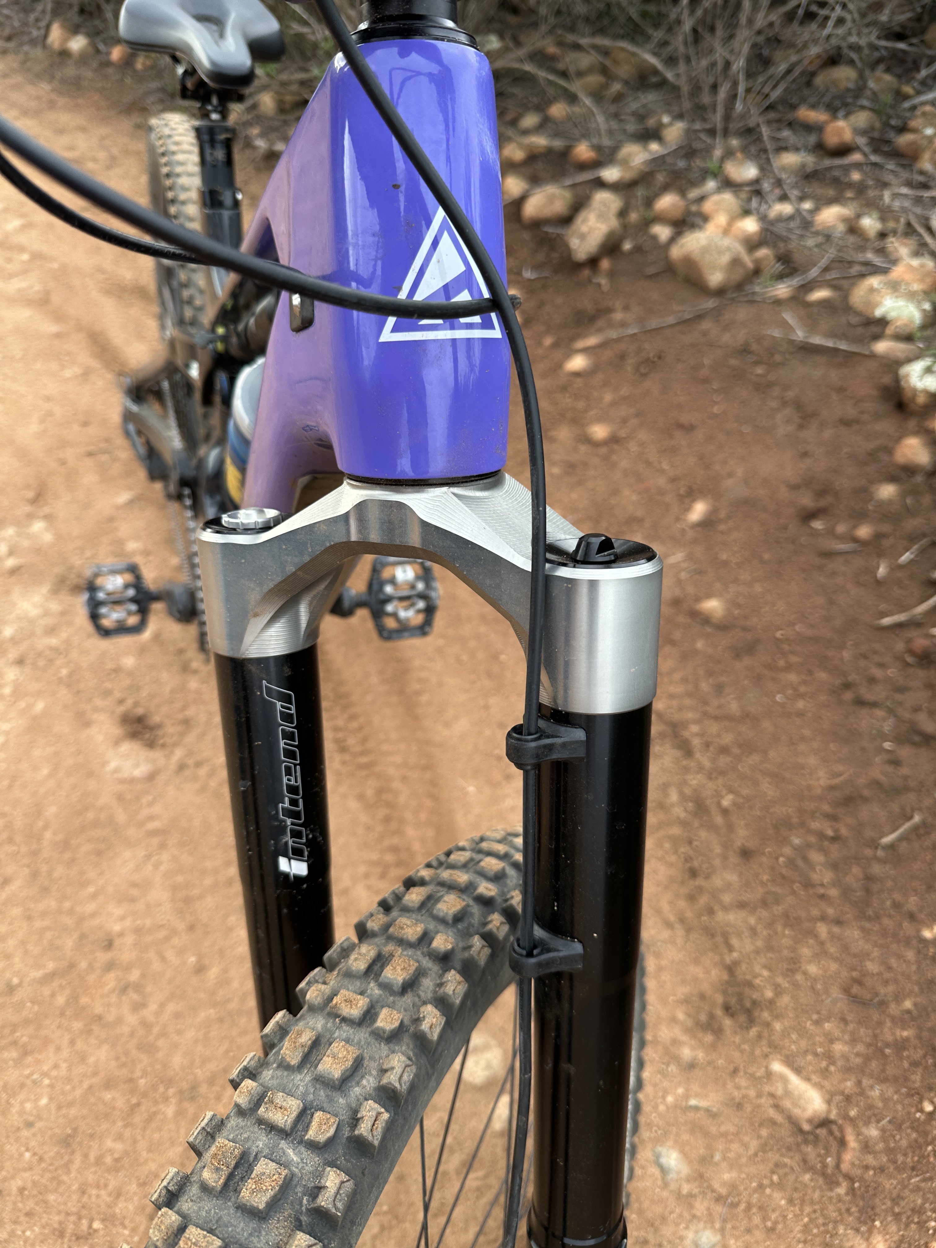

I’m still thinking about trying a 50mm riser bar… Did you drop any spacers to keep roughly at the same height or were you aiming for a higher position? Role the bars forward at all? Do you have the Zeb fully open on HSC & LSC? I ended up there but have just added 2 clicks back on LSC.
Bet Golfie was epic in these dry, wintery conditions? Been a while since I’ve been but yesterday booked a trip in May 😎
Took a 5mm spacer out so it's still higher than it was, I'd say the bars are pretty neutral roll, like got them setup for maximum rise on the vertical if that makes sense. Those PNW bars feel a lot more compliant as well
I think it's got 2 or 3 clicks of LSC and 1 click of HSC from fully open and fairly fast rebound. Felt mint today, first time I've had a ride and felt the forks just working and being nice and plush yet supportive.
The eco I’m running is slightly up tuned. Was a slog but not too bad I got back to the car on 3% as well haha
Assistance, 4
Max torque, 60
Max power, 400
Motor overrun, shortest
Then all the others set to middle

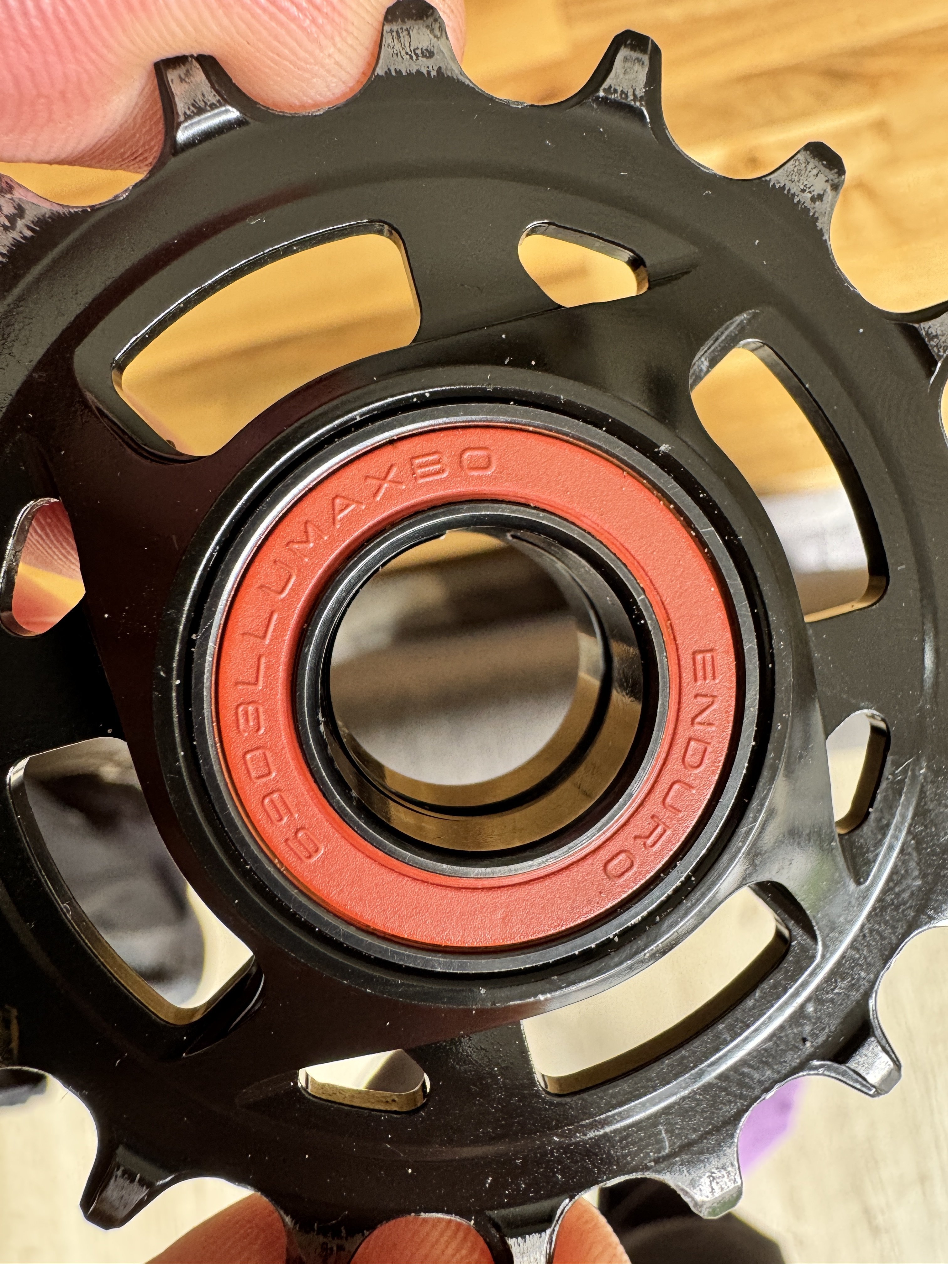

Idler pulley bearing drag
I absolutely love this bike but I do have one gripe !
The idler pulley bearing choice and seating is awful !
If you torque it up to spec the bearings feel pinched slightly and are unbelievably tight it’s like the brakes are on which will absolutely have an effect on the motor and battery.
I have tried re seating them but it makes no odds, the bearings are solid lube maxx and or tho I get they want longevity if you look as the enduro website they don’t recommend this type for something that spins constantly…..
If you slacken them off the pulley just spins on the bearing cases not actually spinning the bearing….
I’m going to replace them with a quality a
6903-2rs type that you would commonly find in a KTM enduro wheel bearing as surely if they can take the abuse an off road road motorcycle wheel gets over the winter in comparison it would be okay in the idler ? …….
You probably won’t notice it until you remove the chain and try and spin it , if it’s tightened to spec it feels partially seized
Yeah that makes sense, a decent replacement bearing isn't too much anyway so might be worth doing regardless. Do they pop out easy enough or is it in pretty tight

Hi,
We're doing some tests on the Italian group.
The problem isn't the bearings themselves, but the seat where they sit.
If you remove the bearings from the idler, you'll see that the Endura ones also slide quite well, but once inserted, they completely seize up, as you said!
You should try reaming the bearing seat to widen it a few microns and then put the original bearings back in.
A guy here in Italy installed some ceramic bearings to test, but once inserted, they seized up... they slide better than the originals, but not as well as when they're not installed.

Tool a 5mm spacer out so it's still higher than it was, I'd say the bars are pretty neutral roll, like got them setup for maximum rise on the vertical if that makes sense. Those PNW bars feel a lot more compliant as well

Sounds like you are settling into a setup very similar to mine
