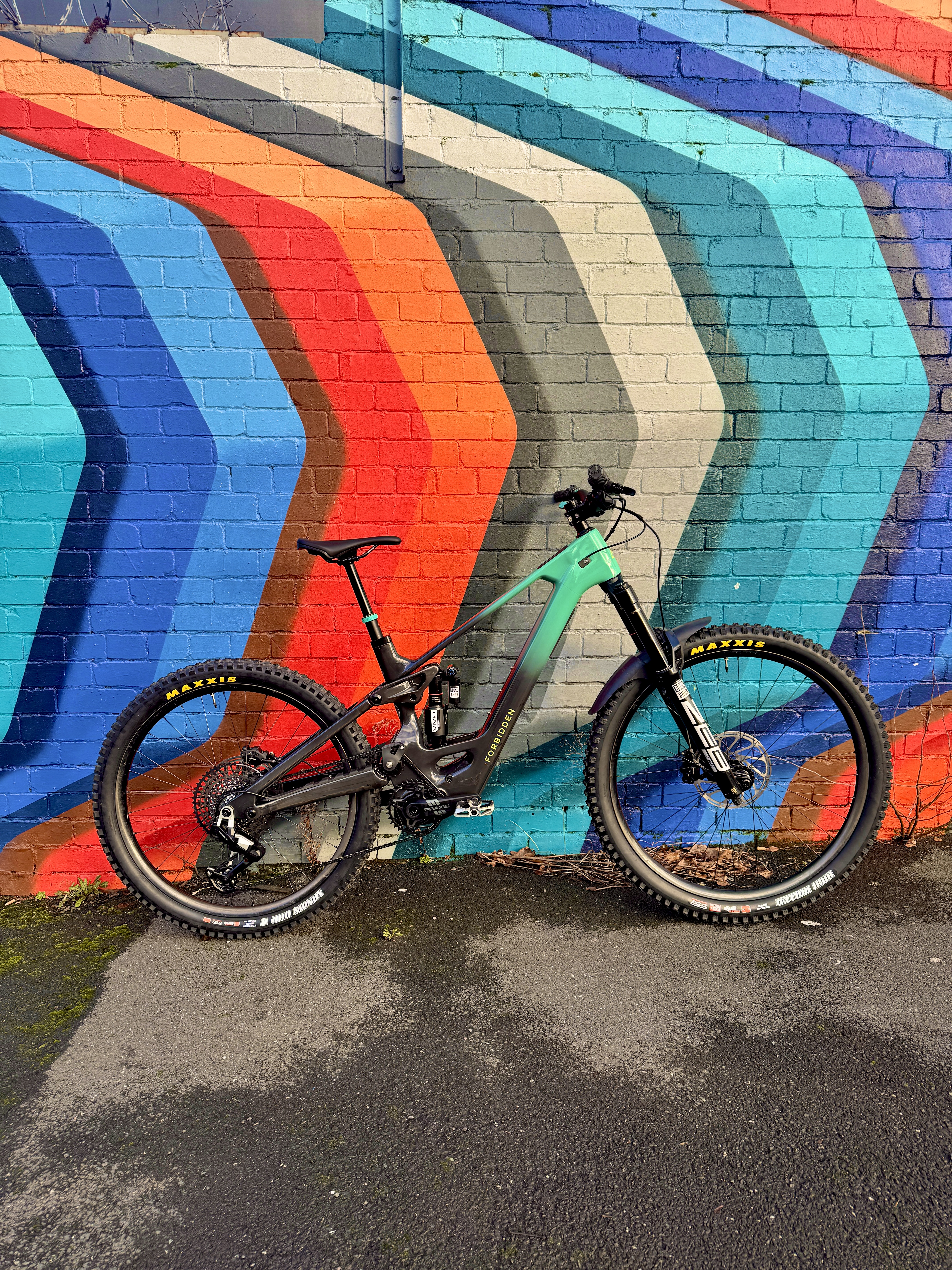

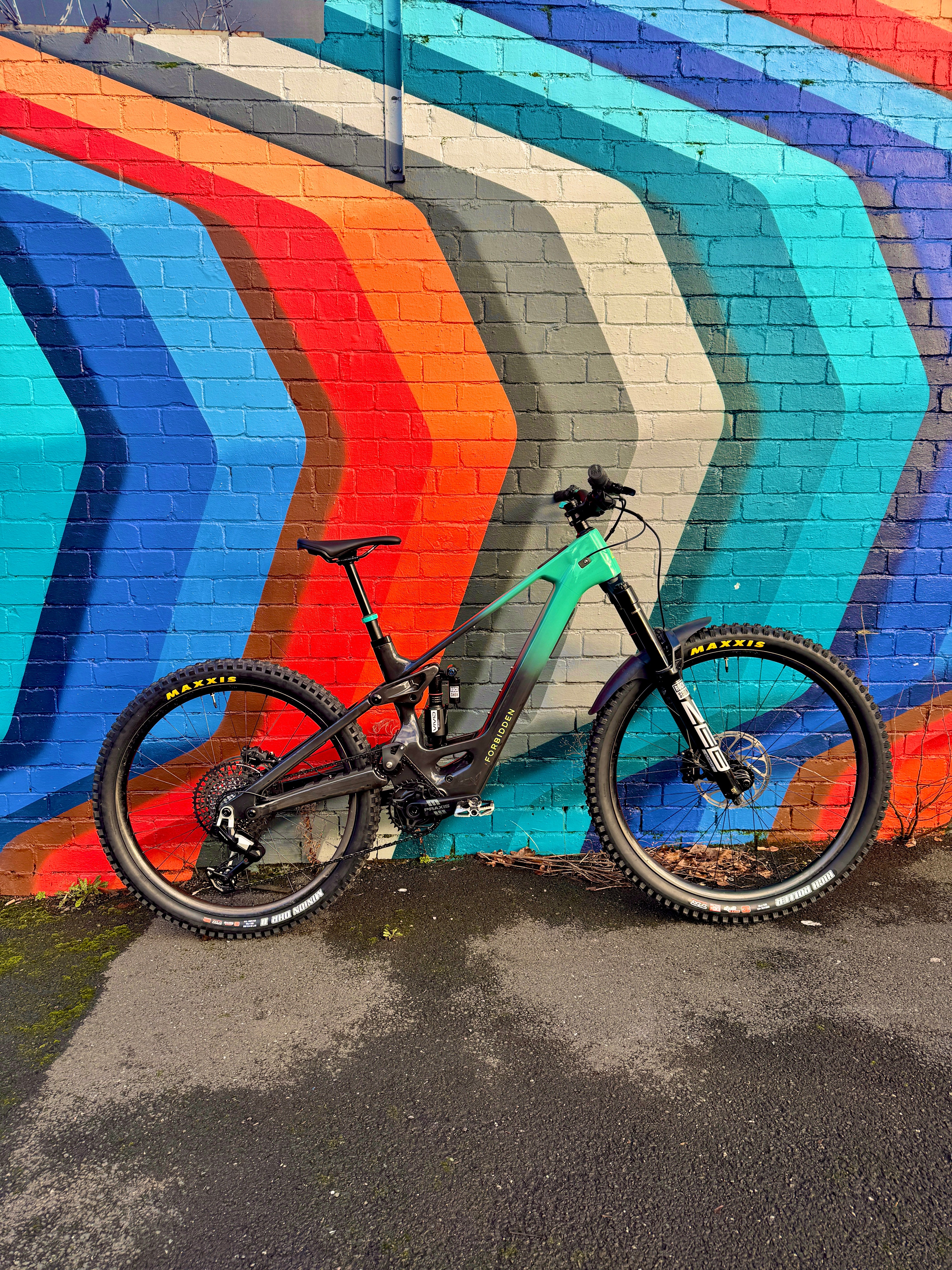

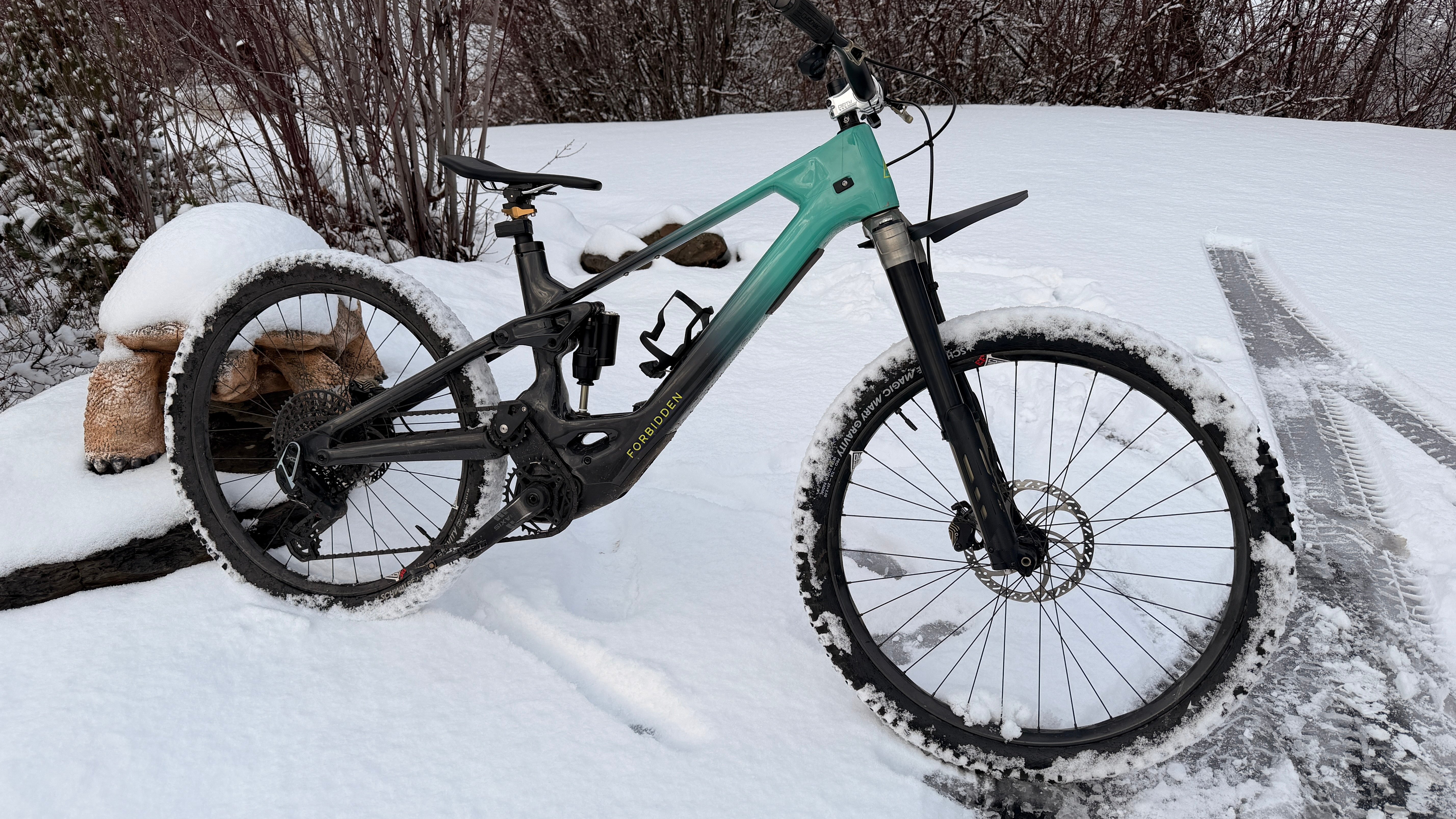

Finally got my intend hover in. Will need to travel somewhere to try it as there’s snow here now 😅 saved a whopping 1.65lb over the live valve Neo coil I had on previously.
View attachment 172890View attachment 172891View attachment 172892View attachment 172893

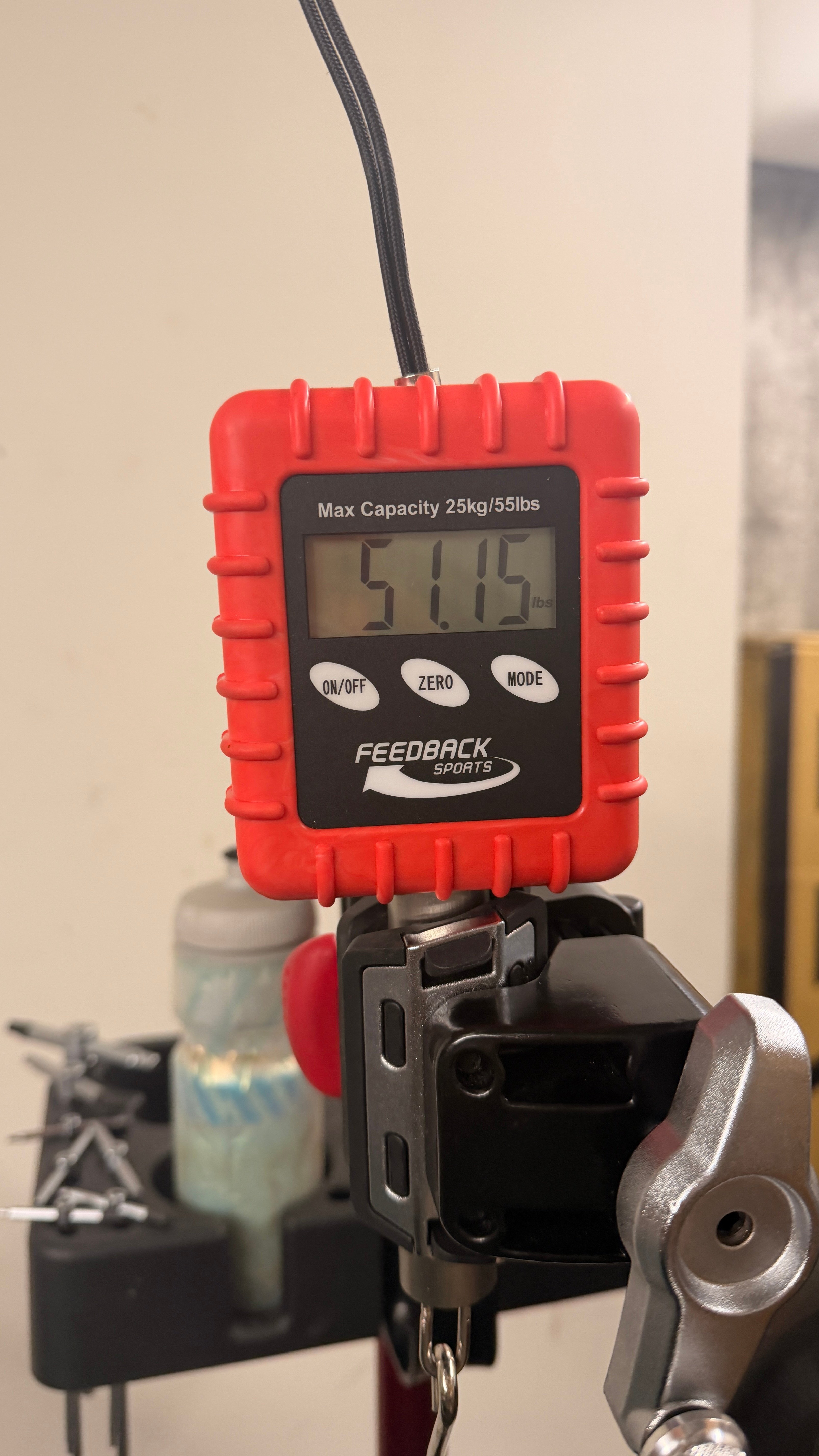

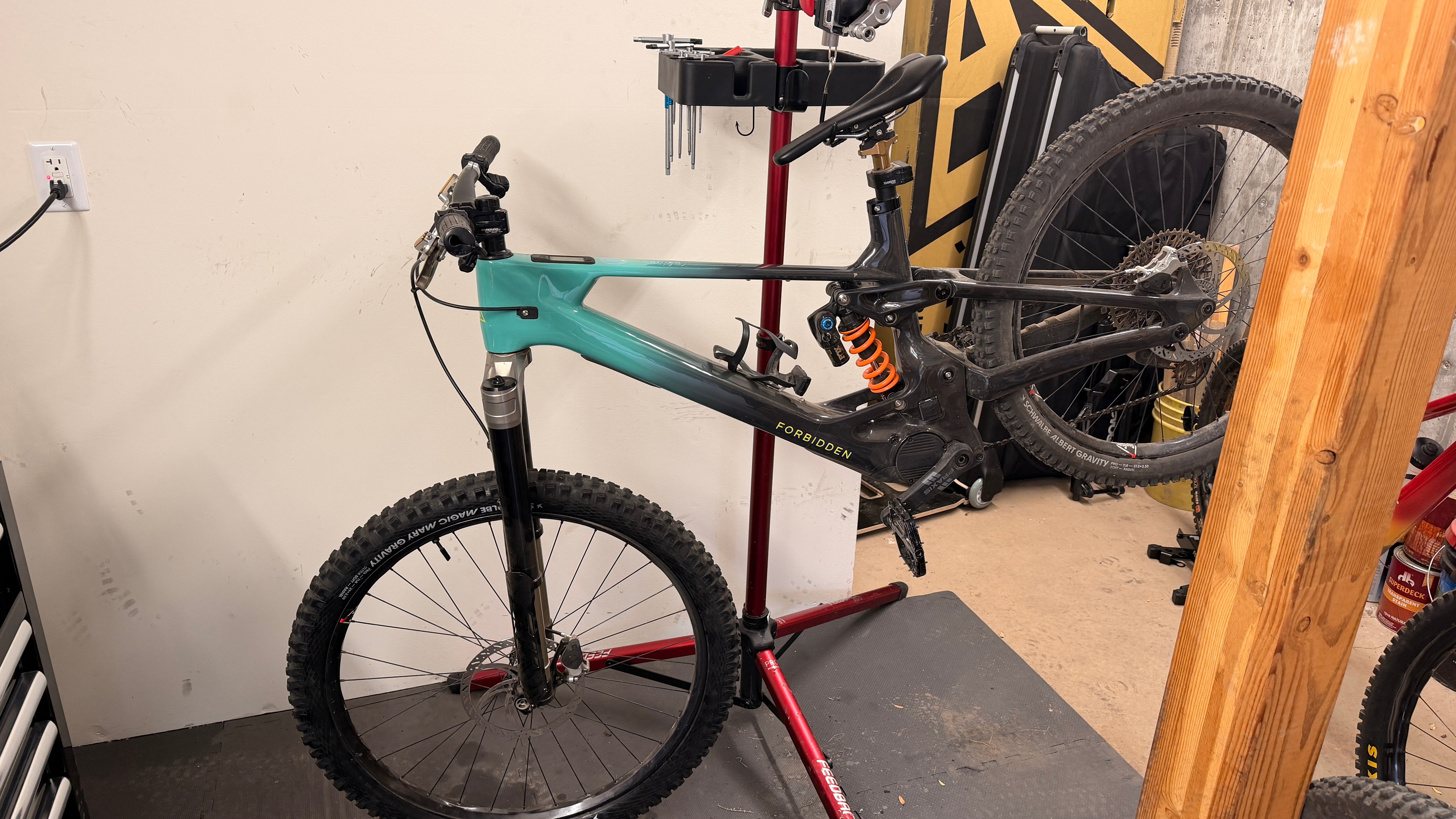

I have a EXT Storia shock from a previous bike. Currently it has a 575lb spring which the EXT spring calculator says should give me 30% sag. On the Vivid I’m liking a little less sag than that so I’m thinking I should try 600 or 625lb spring on the Storia. My lbs will lend me some prints to try if I ask nicely 😄
For a quick change over of shock, what hardware will I need to fit to the Storia? I’ve not had the Vivid out yet so just pre-empting what I need to get prior to Xmas shut down of stores.
I too like about 25% sag on the druid, feels good with a coil. You will want two sets of the bearings or just take them off the Vivid. You can use two adjustable wrenches (carefully) or use their socket tool.

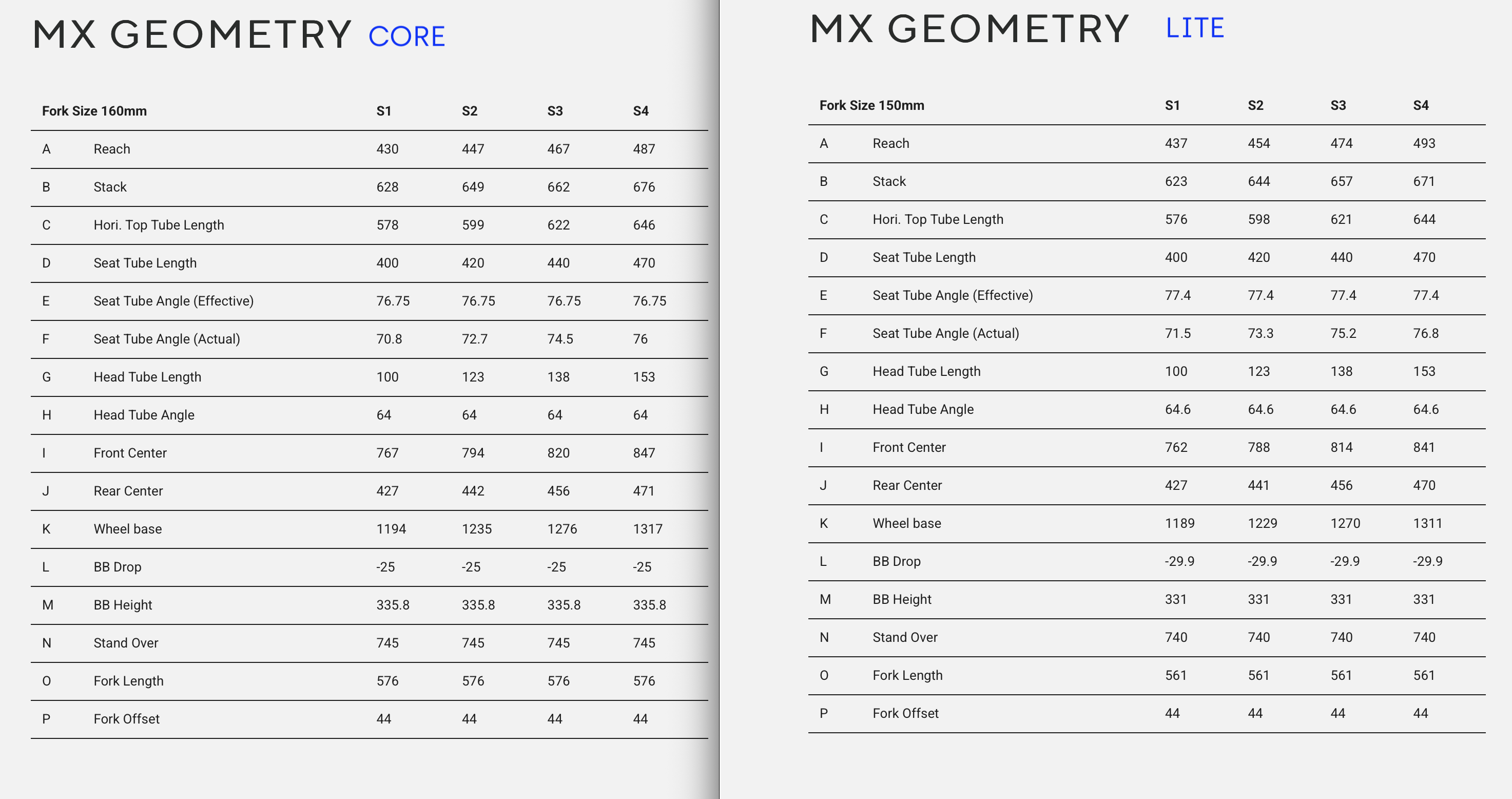

If any of you guys follow Brain Cahal, he rated all 40 of the bikes that he rode this past year.
He rated both the E-Druid and the E-Core very highly, however he did rate the E-Druid a tier higher because he said he found the E-Core a bit short, which I found a bit interesting.
The reach is 7mm shorter on the Core vs Lite. BB Drop is also 5mm more on the Lite vs Core. Think most of us would feel that if we did back to back runs. Slight weight advantage of the Lite also helping.
Gonna hazard a guess most would like the Lite feel more, but not enough to give up the 800 battery. That was my rationale, at least.
Personally I love the extra weight of the of the Core, good thing we live in a time with sooo many great options!

that usually happens when you increase fork length…
Can you achieve a similar set of numbers by using a higher rise bar but dropping it down a couple of spacers on the steerer? This way you maintain the Stack height but gain some Reach? I keep thinking about trying this with a 50mm rise bar instead of the 35mm one fitted.
I’m 6’2” on an S3. I’m using a 50mm stem and 40mm rise bars rolled fairly forward.
That's what I've done on my S4, havnt ridden it yet though as I'm on holiday in Spain til the new year now 🙄😂
