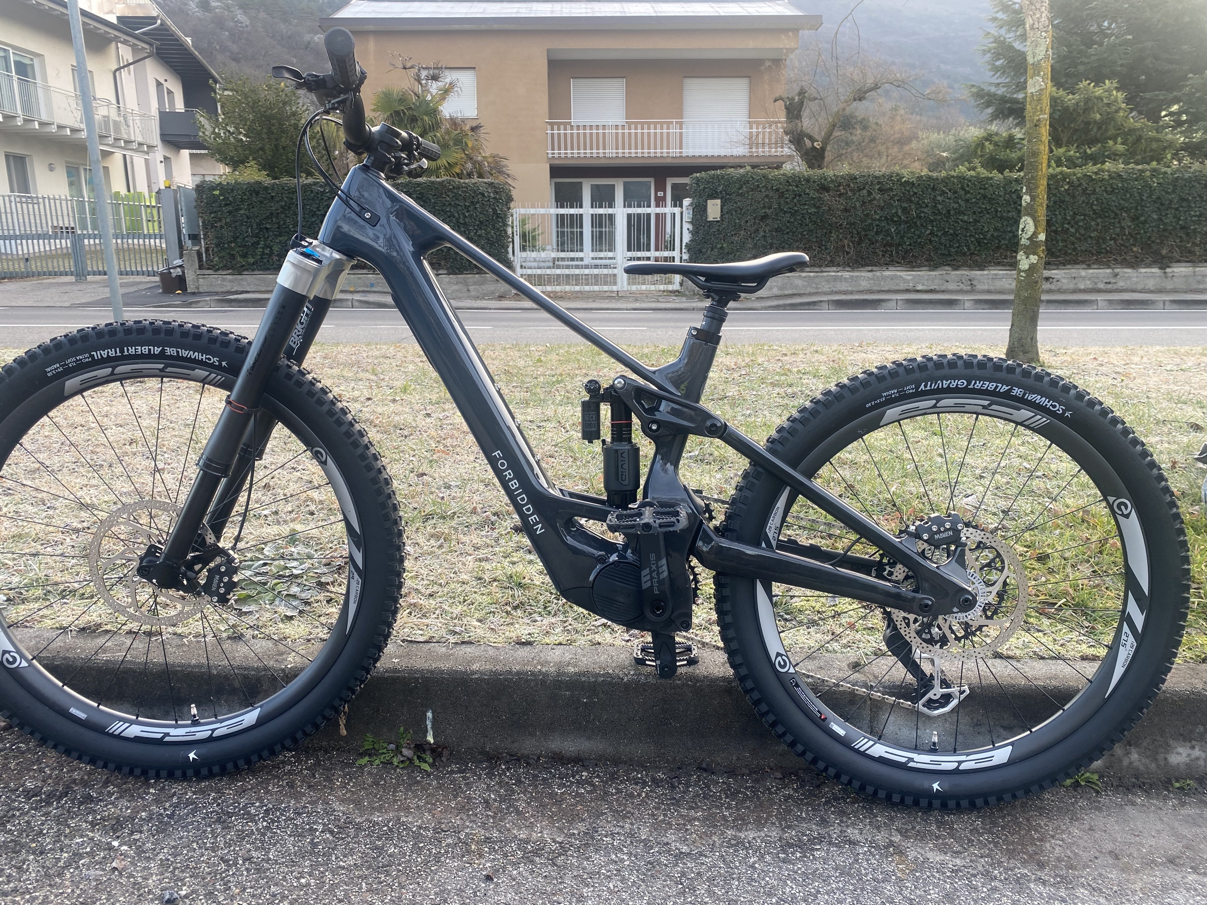

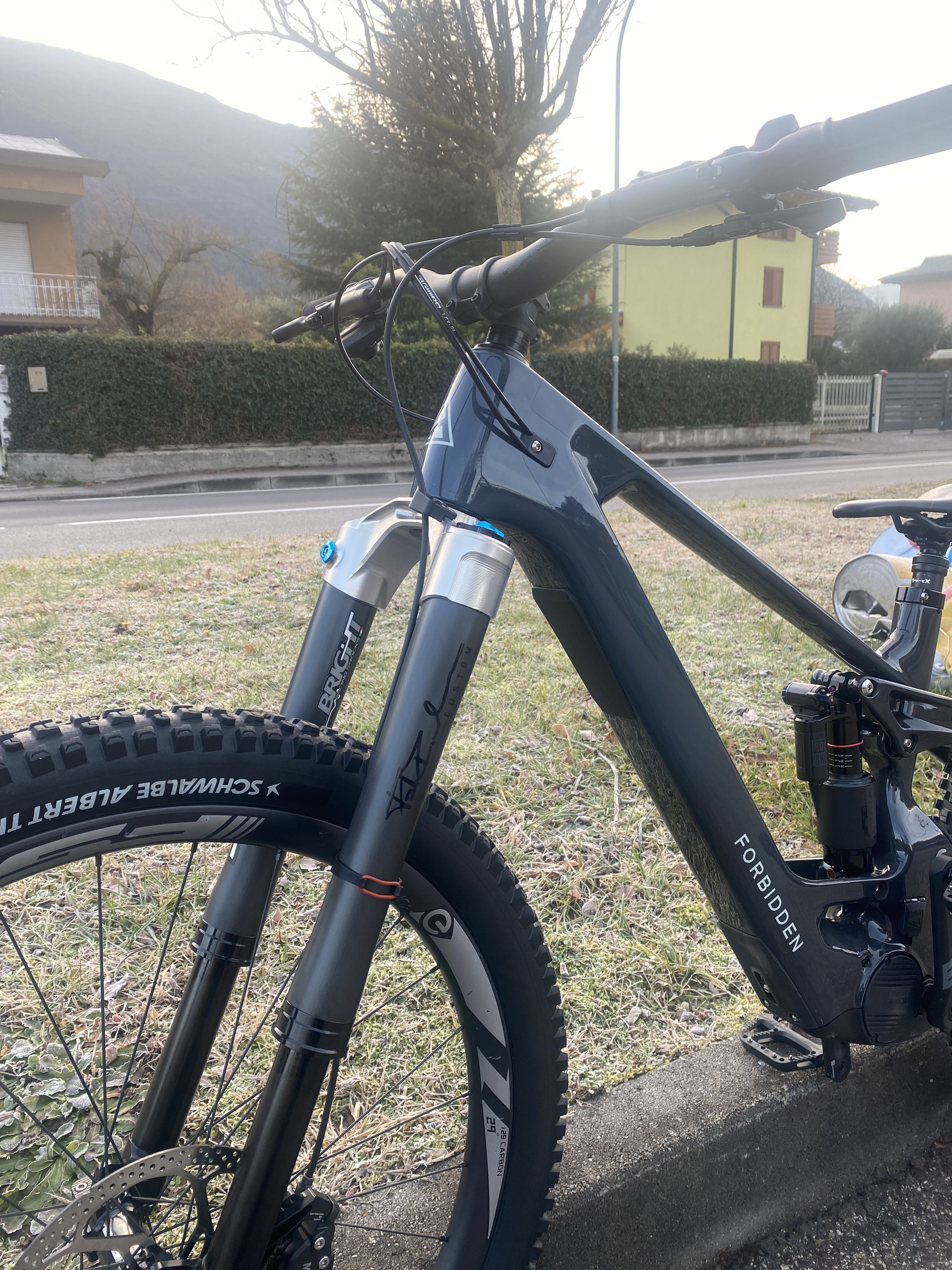

head angle looks steep, how much travel does this bright fork have?
Now setted @150mm of very very quality/capable travel… feel a LOT more maybe like a 160/170 commercial fork
Bright have a lot of antidive in her cartrige. You can set from 130 to 170 if needed

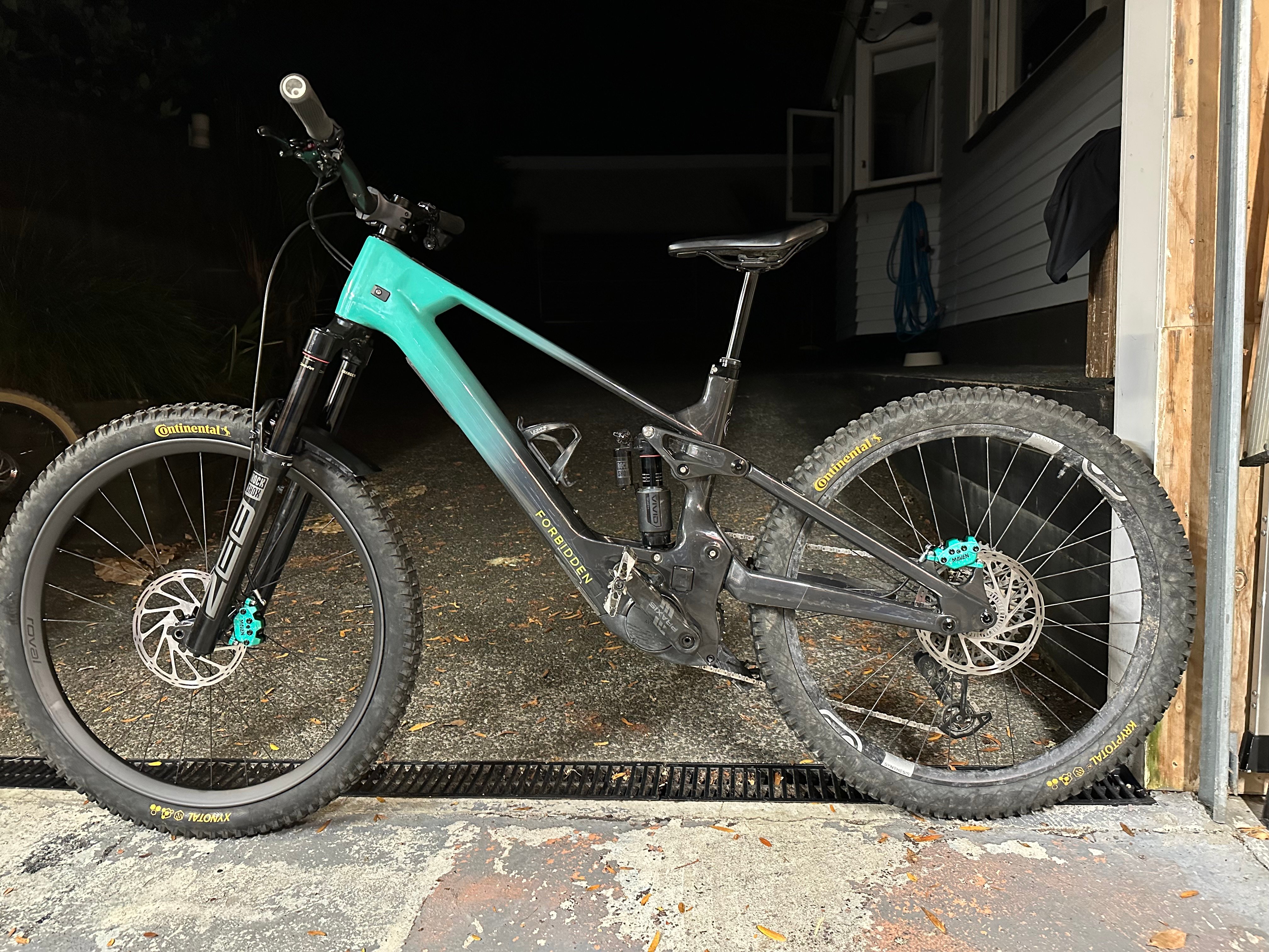

Thought I'd do an update photo for some new bits!
My friend works in a bike shop and got a set of Ultimates when they came out. They don't match his new bike so he sent them to me on 'long term loan' - it's like they're made for the CorE - he's not getting them back! He was also good enough to source me a set of Roval Traverse HD's. The front (on there) was half price on Black Friday, but they had no rears. Happily, he could build one up for me with a 32 hole DT Swiss 240. (should arrive tomorrow).
Absolutely loving the bike (still). So much fun and is encouraging me to ride faster and more gnarly stuff than I was on my V1 Druid.
How’s the hover (sorry if you posted thoughts before)? How does it compare to the vivid? I am still leaning telum coil, but going full intend is also interesting
I have just put a Hover Monocoque on mine and I really love it. I’ve tried the stock Vivid air Select+, a Vivid Ultimate coil and now the Hover, which is my definite preference. The weight reduction vs the coil is noticeable and there’s more midstroke support vs the Vivids.
On the Hover I’m running 485psi for my 95kg kitted weight. Works well for my style of riding. Big fan.
