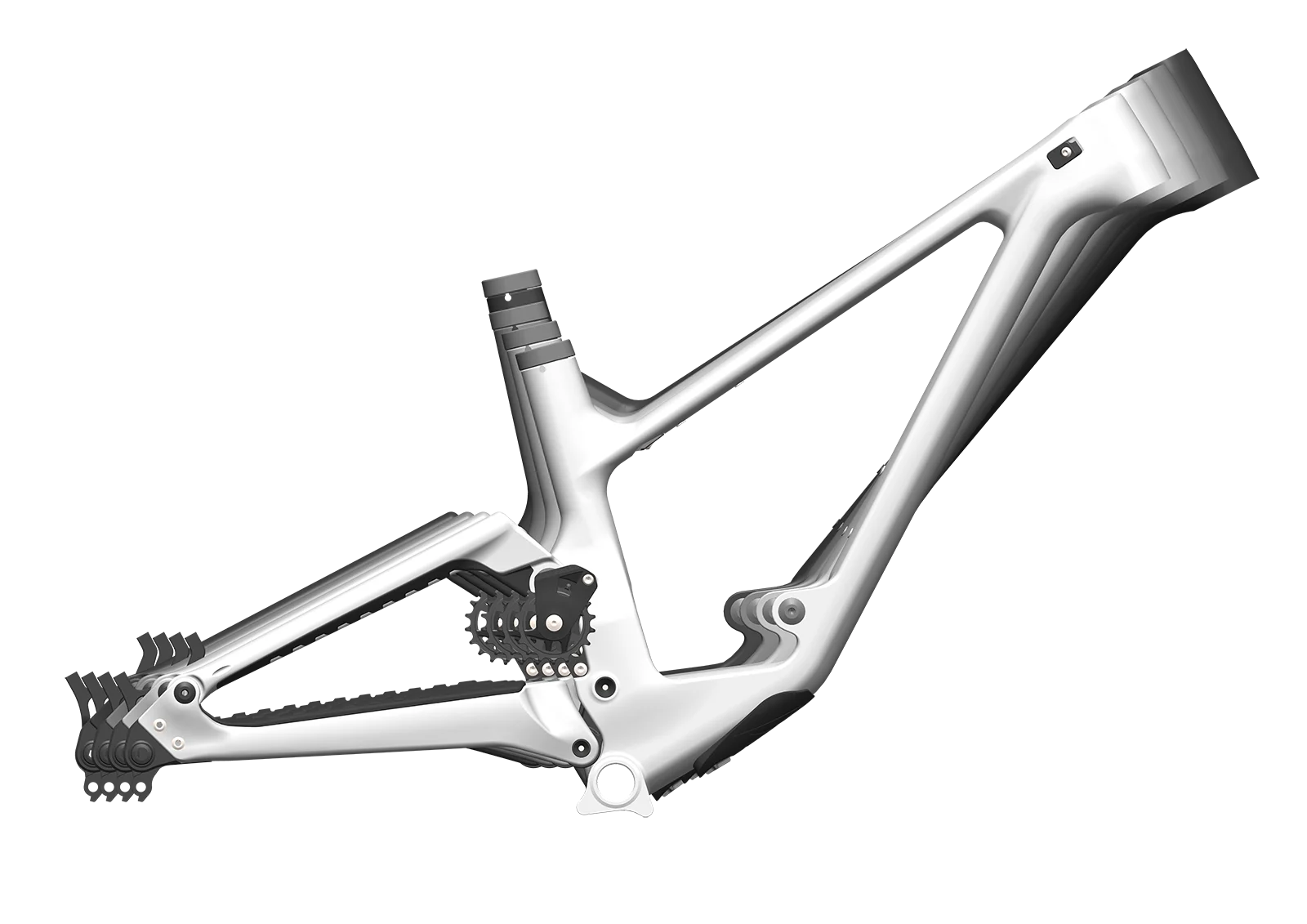

A S3 Dreadnaught E has a super-long wheelbase... 1298.2 mm; yet has a really short reach at only 461 mm. The rear center @ 463 mm is actually longer than even the longest setting on a Crestline 181.2 (adjustable 435-460 mm)! I wonder if this abnormally-long rear end is why Forbidden is hiding their chainstay length spec.

That's not even that crazy. I wouldn't ride a crestline in anything but the 460mm position.
Heck, the acoustic dreadnought has a 470mm chainstay, if desired.
They're not hiding anything, rear center is chainstay length...
And to address the long wheelbase comment, you'll find that bikes with more balanced f/r ratios feel shorter for a given wheelbase measurement. Particularly the forbidden e-bikes with their shorter reach and higher stack.

I'm saying that you'll be surprised that the only place you'll feel the wheelbase is with the additional stability it provides in a straight line.
Something like the levo 4 is vastly more clunky feeling in corners, due to the less balanced f/r ratio.

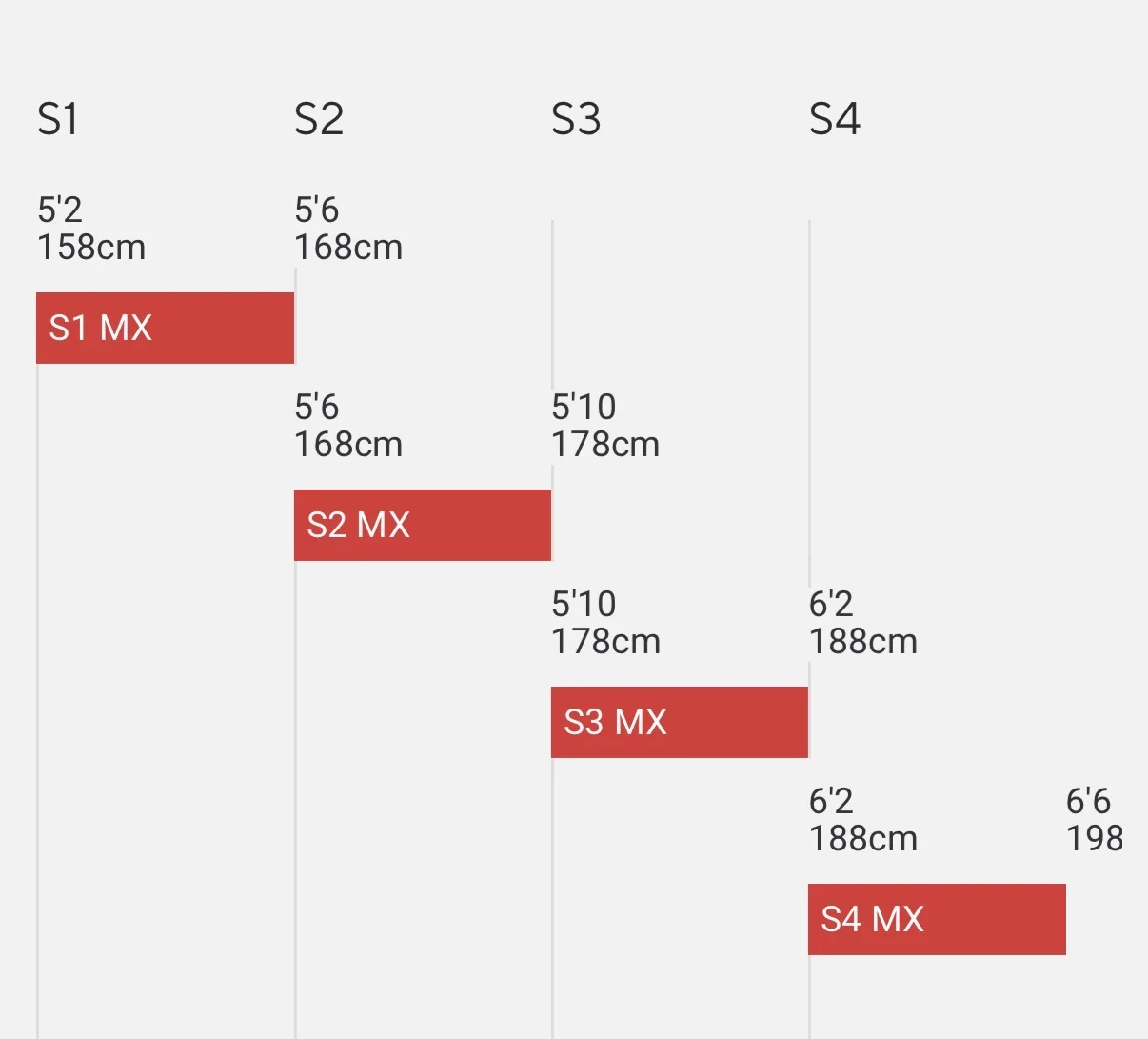

First, I'm comparing the bike size that's appropriate for me; regardless of the size nomenclature.
Not buying that the trailer truck wheelbase (and slack head angle) will only bring benefit. I'm interested enough to try it, but I'm highly skeptical. All evidence points to it being as nimble as a freight train. Never tried one, so maybe I'm mistaken.

If you’re shopping medium elsewhere, you want a sz2.
Ignore the reach numbers here, they are irrelevant due to the very high stack.

Yeah, 5’11” is solidly a sz3 forbidden.

Welcome to my world. Similarly, sit between S3 and S4. My LBS adamant that I should be a S4, but in the end based on all the feedback here ordered the S3. My 09 Santa Cruz nomad a XL but shorter reach than the Dreadie or Druid so I'm used to riding a smaller feeling bike.
no it's not. all forbidden have the same chainstay length, but different rear centers, because they move the pivot point with each size more to the rear. therefore, suspension kinematics stay the same over all sizes
That’s splitting hairs over terminology.
The insinuation was that they were attempting to hide something by giving a rc rather than a cs length.
The opposite is true, rc is a more accurate and useful measurement, as it is what actually matters for determining f/r ratio.
Many other brands use the terms interchangeably, unfortunately.

At 168cm would you go S1 or S2? I’m always right in the middle of small and medium. I’ve found 2 S2s in stock and can have either one delivered next week but won’t be able to get a S1 until late this year early next.
I'm a whopping 3cm taller than you and only just in the S2 bracket on their size guide. I'm coming from a S3 Kenevo SL (mullet) which was probably too long for me, technically speaking. I loved how stable it was and never had any problems getting it around the tight steep stuff around the naughty tracks in Llangollen and Grizedale. Those are steep & tight 180 degree switch backs into catch berms. Same with the tracks around the Wrekin. See you're in Scotland so you probably ride The Golfie? i get that large (for me) bike down all of those no problem. Size never held me back.
