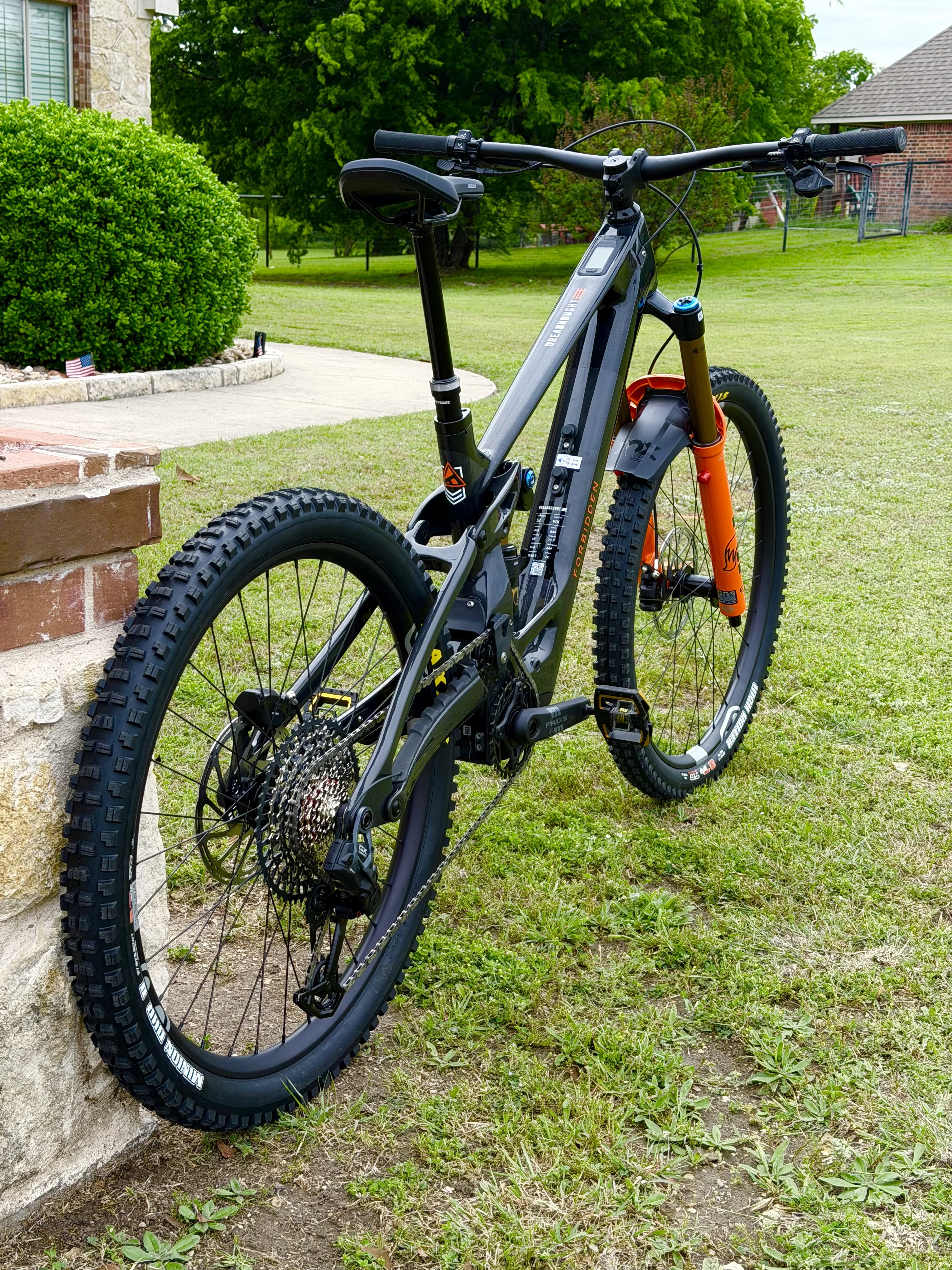

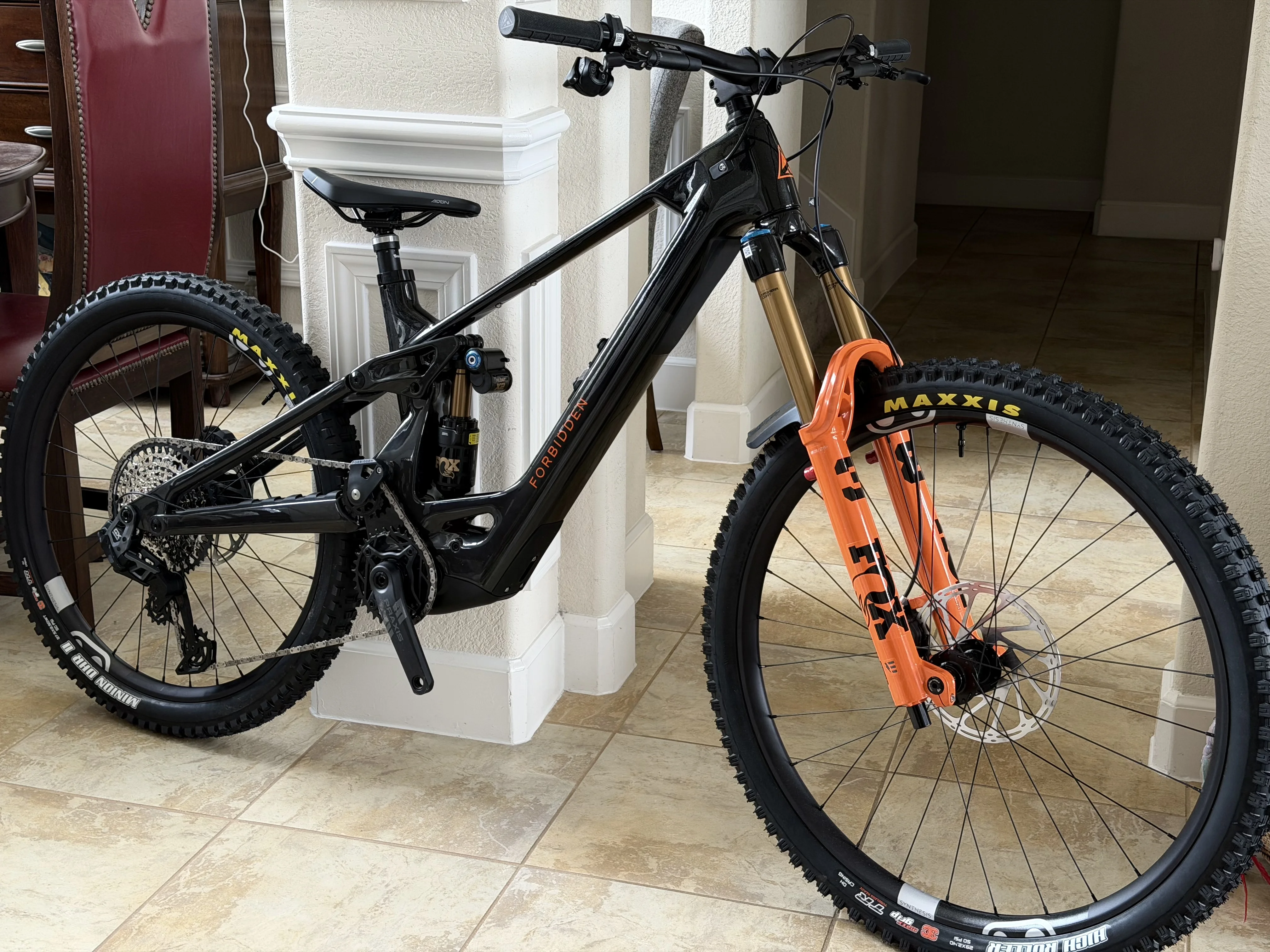

Looks great, can't wait to get mine. My OCD is kicking in hard though, that dropper post cable really needs to be shortened....lol
I have my Fox wireless dropper post going on my bike and I'm swapping that stock brakes for my Trickstuff Maxima's.
Even though I'm not using the stock dropper, it kind of annoys me a little that Forbidden cheaped out on the dropper post on the tier 2 build, IMO it should have the same OneUp dropper that the tier one comes with. I can't imagine it made that big of a deal to the bottle line on the profit scale if it had a OneUp.
Yeah, I'm ripping that manual dropper out and replacing it with the Rockshox Reverb ASX... can't justify the extra expense for the Fox.🤯

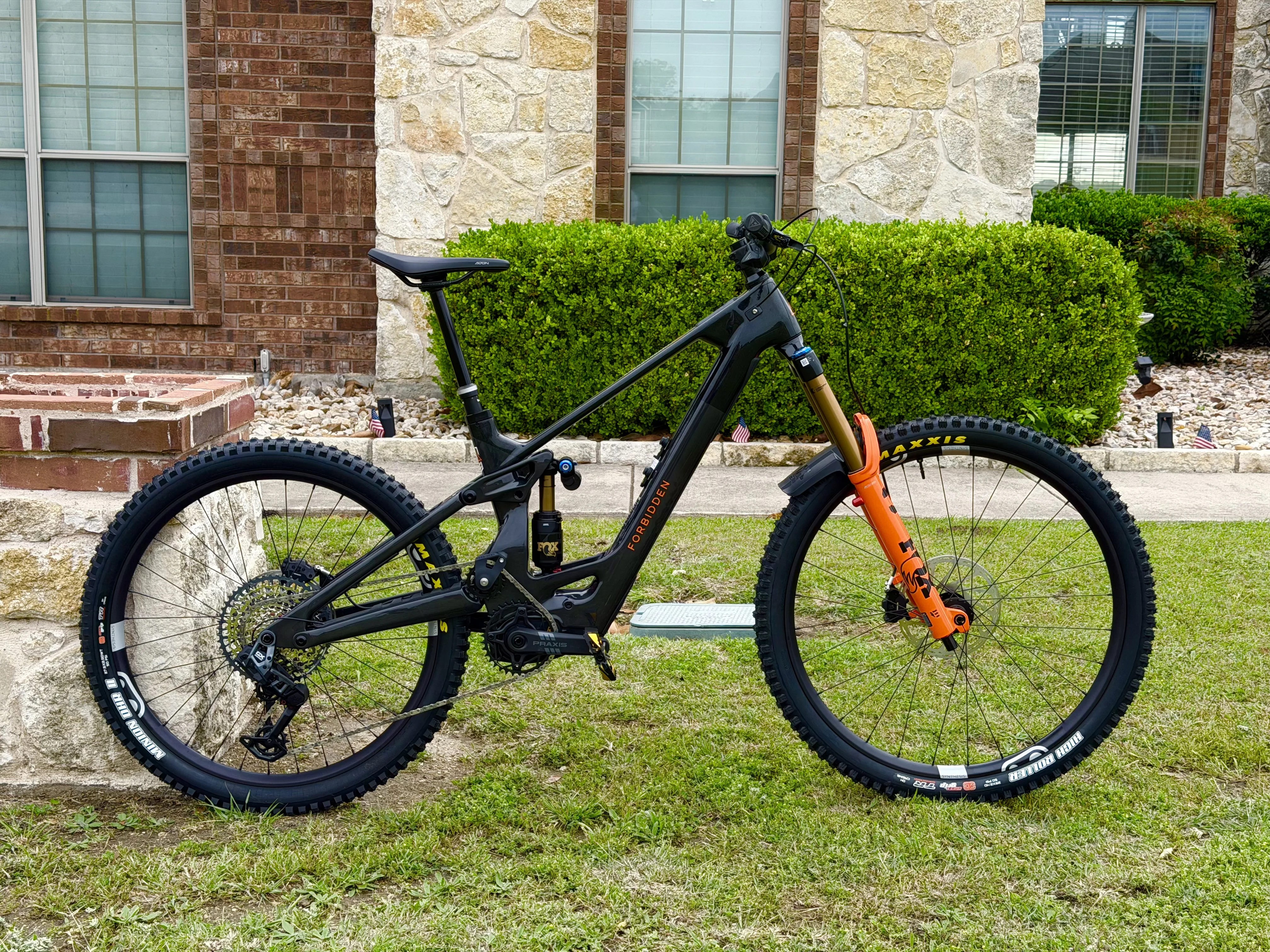

Forbidden doesn't appear to share a chainstay length spec. Am I missing something?
Also, doesn't that leverage ratio look a bit aggressive; especially for an air shock?
They focus more on the Ratio between RC and FC and I would probably use that RC more so than chainstay. during compression, max extension of RC is about 18mm at around 120mm of compression then shortens again.
27% progression on a 170mm travel bike would be fine with a large volume air shock and no volume reducers. The truth is that coil shocks are really tough to get just right, so I understand why manufacturers rarely provide them as the spring rate would likely always be off.
I'm stoked that my Wild has a 39% rate of progression, it's very ideal with a coil shock.
