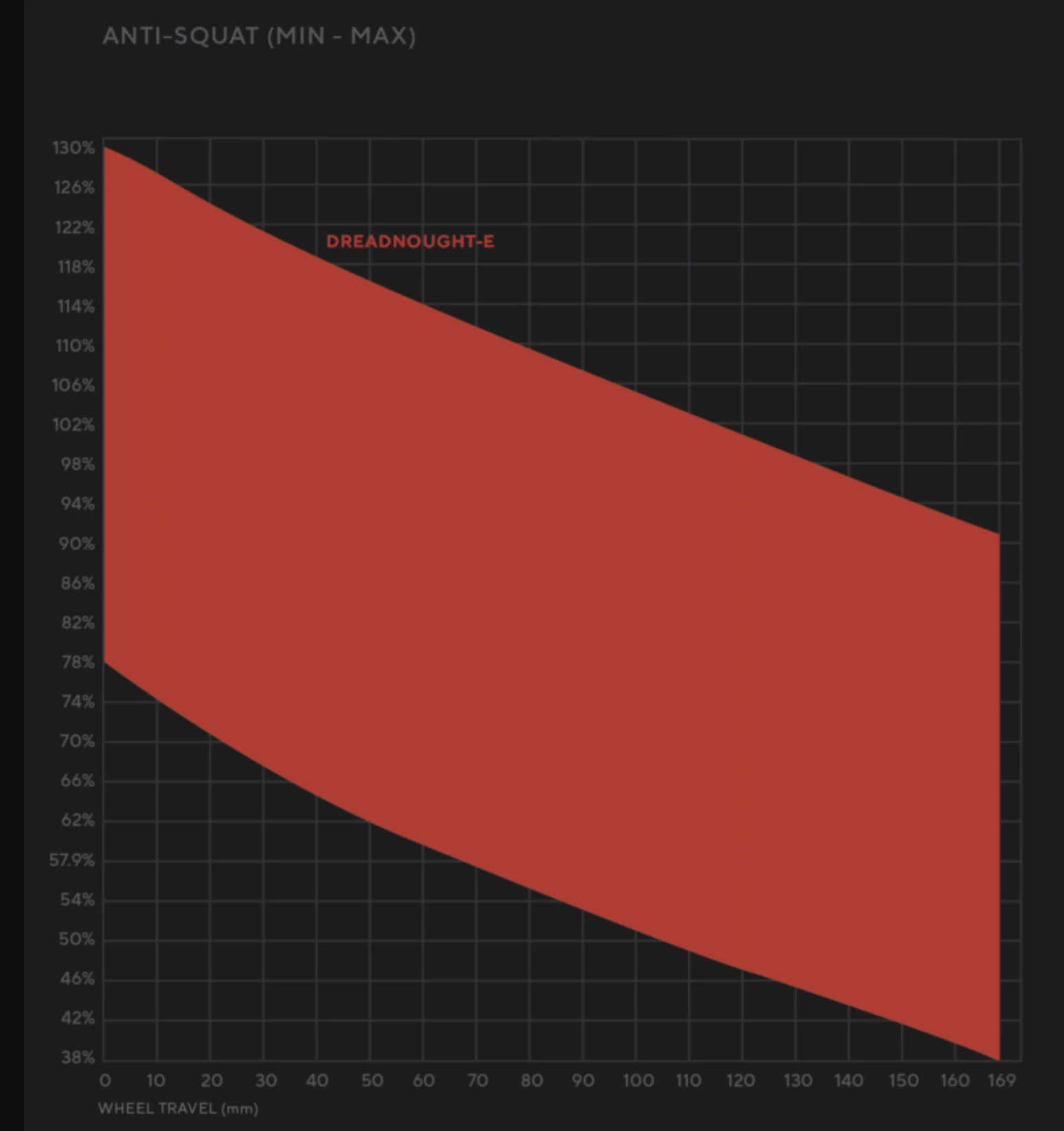

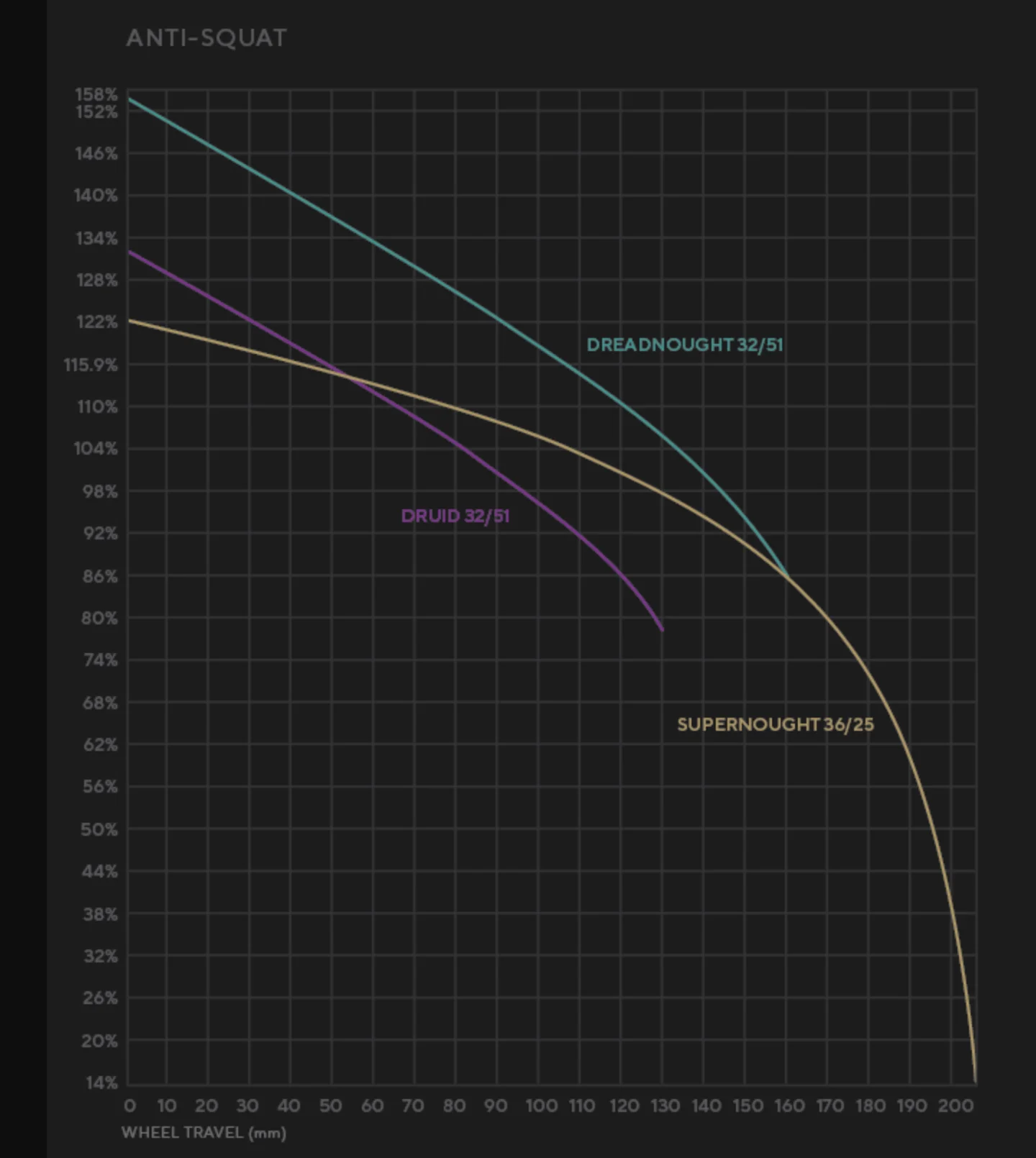

Those are some supernought geos and graphs.. will definitely need to get some ride review to see what’s going on.

Anti Squat

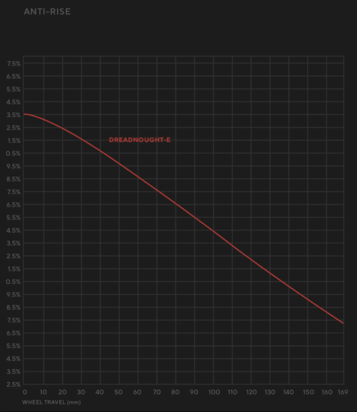

Anti Rise

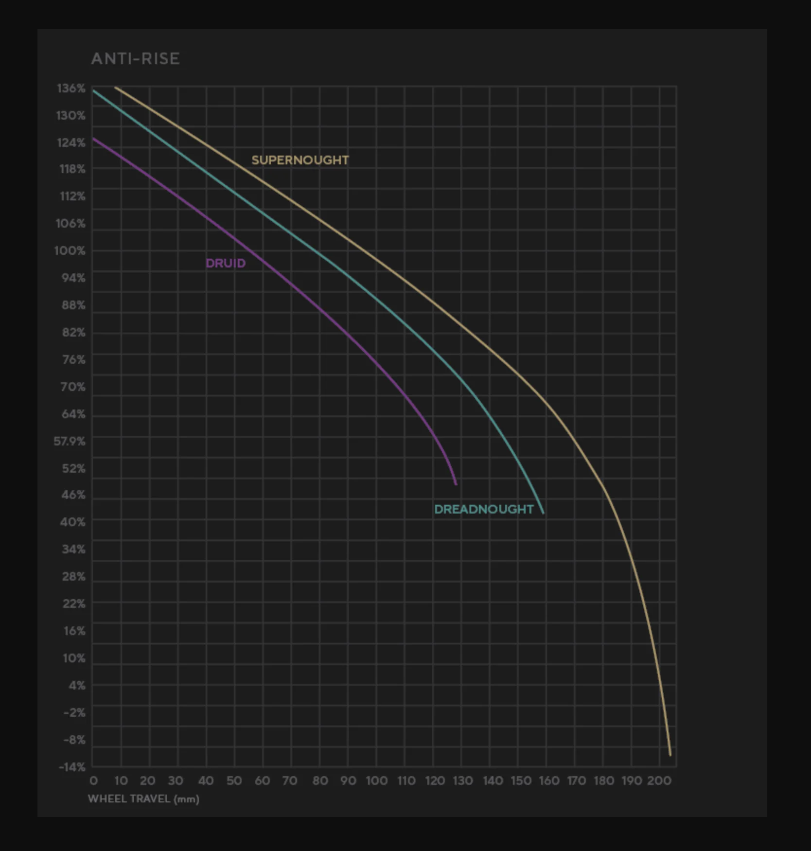

The anti rise chart looks a bit suspect, lol.
That's the behaviour I'm most interested in, as any artifacts from using the druid front triangle will likely show up there.
yeah their charts are definitely not consistent between all bikes.
I am more interested in their anti squat....seeing what the Yeti LTE has provided + their ride characteristic, that's what I am after, but I want more than 160mm of travel.

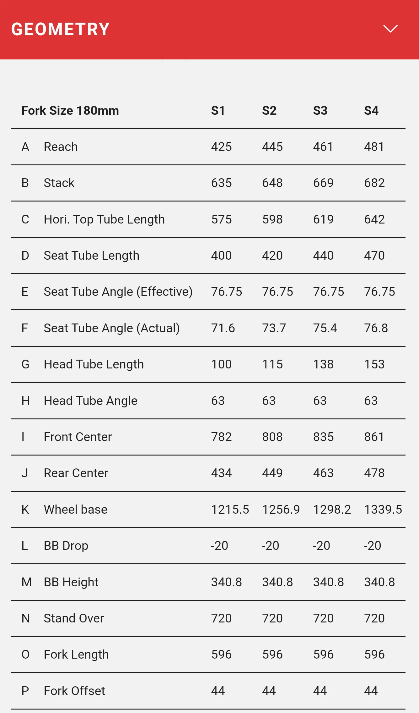

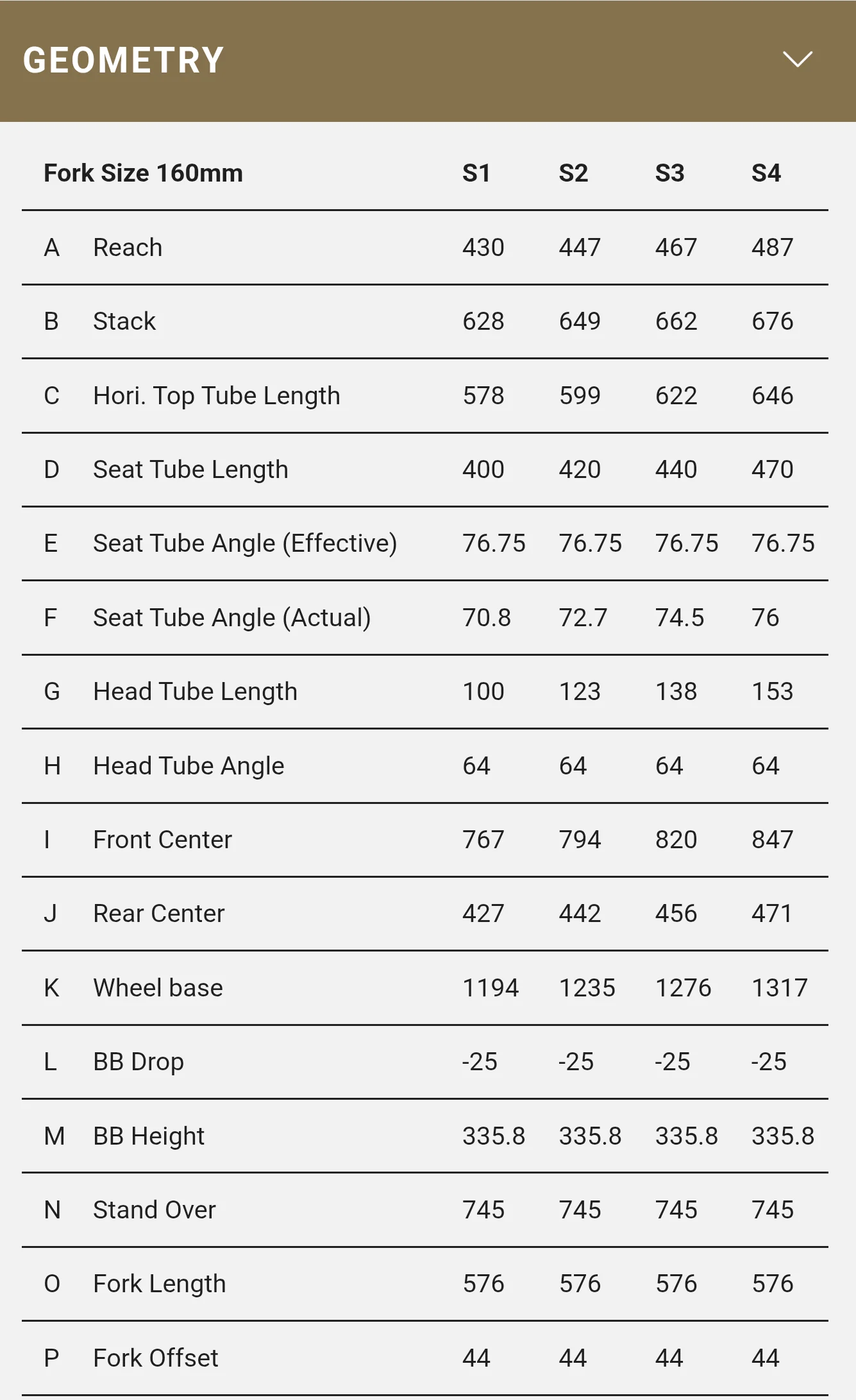

Looking at the geo charts I don't think they are the same front triangles but could be wrong.
Have emailed Forbidden to get a breakdown of the actual differences between the two frames 😅
Yeah I was looking at S3 vs S4 at first 🙄
The extra 20mm fork length would get you the same H/A as well right?
