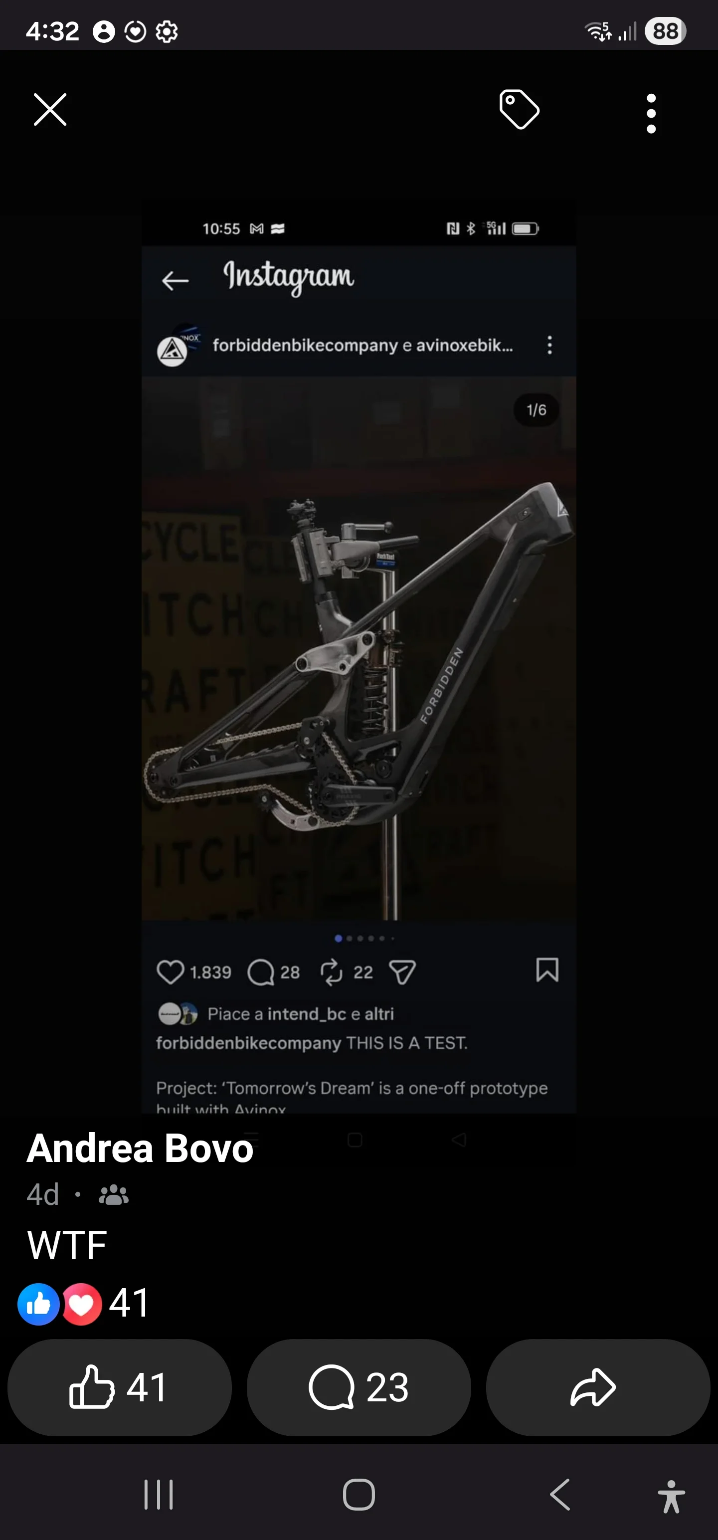

@ntm95 Avinox just announced a new bike with external battery attachment of 480wh @ 2.49kg thats another 380g / 0.8 lbs of weight savings. Dimensions are the same as the 600/800, just shorter, however connectors are different. For me this would be the ideal setup and I'm sure it would be for you too if there's way to retrofit that in there
