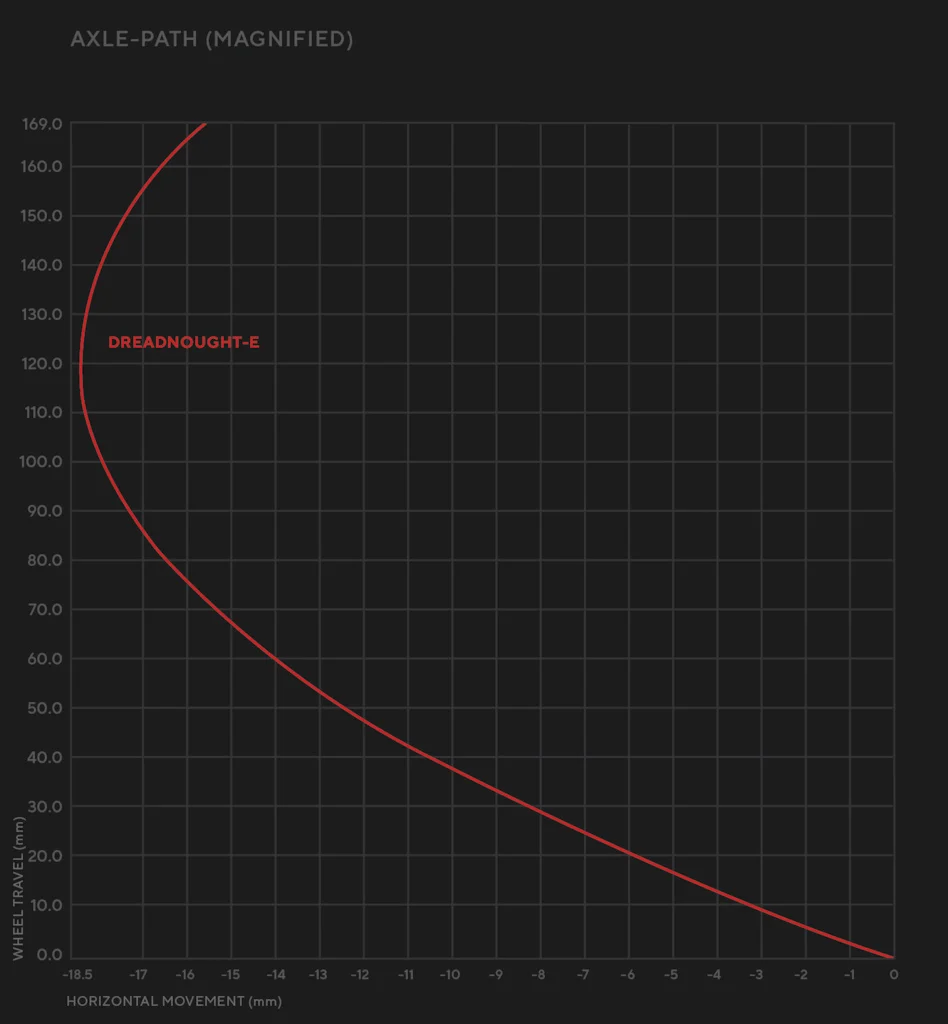

I understand the frustration but to me it's just an unavoidable part of the design. T-Type 12 speed spacing is super tight, and adding a bunch of chainstay growth for the high pivot adds more complexity.
in my experience, if the derailleur is setup at sag, then the shifting is good. to me that's what matters and stand-shifting-perfection isn't so important.

hmmm I would expect best results at whatever sag you are running. I forget their suggestion, usually it's high around 35%
the lower part of the travel has a lot of rearward growth, so being at 10 vs 35% could make a significant difference

The chainstay growth on the e- dreadnought isn't very dramatic. It's less than the dreadnought v2, and a lot less than the supernought.

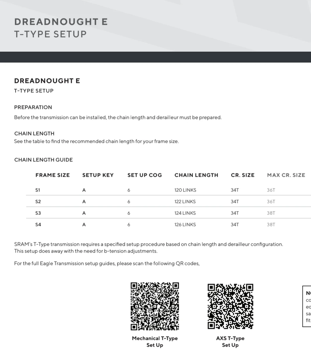

Visually no. I have 3 other bikes + Forbidden which all have T-type Transmission. XO, XX AND GX. I compared them visually and they it looked normal. Also, not sure if I mentioned but when I was at the shop dropping off the bike, there was another Forbidden Dreadnought T1 build on the floor. Before I left, I also took a test ride on that bike to see if it had same issue and guess what, it did. That NEW Forbidden bike on the floor also had issue on gear 7th to 8th and also 10th to 11th shift. Mine also had 7th to 8th gear issue initially along with 10th to 11th. After re aligning the derailleur to sram/forbidden specs, 7th to 8th issue disappeared but 10th to 11th shift also remains.

I also tried to set but no luck. Tried it many times using specs and no luck. I installed t type on my 3 other bikes before and never had this issue.
Yes. 122. Also tried 124, both have issues.
