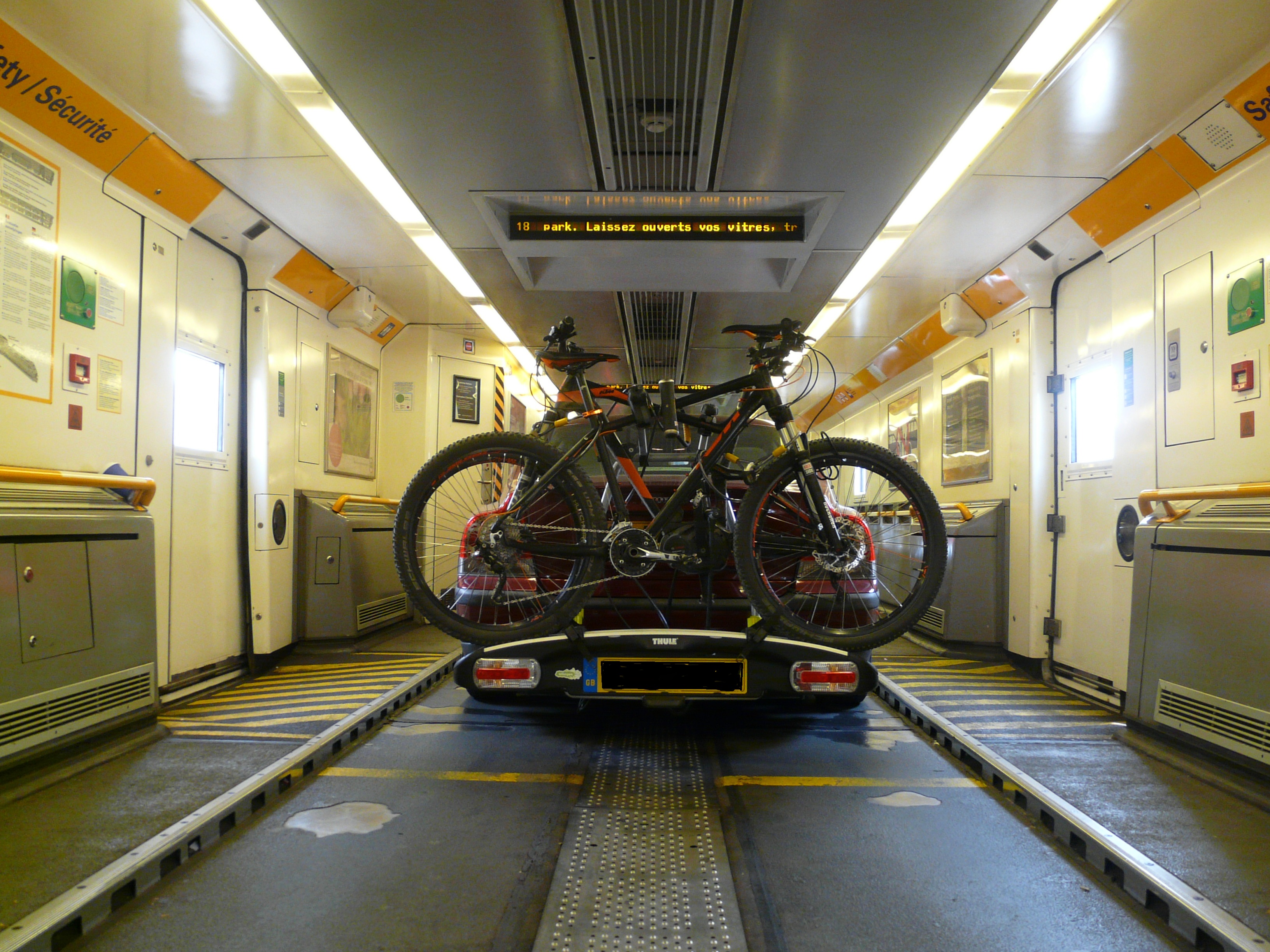

Really sorry, but I'm afraid that I can't advise you about this one.
We always drive.
We stop at the same Ibis hotel on the way down, and the manager always lets me park in staff carpark, and then on the way back we stay in another Ibis, which allows the bikes to be stored within the hotel.
I'm not sure what will happen this year though, as the plan is a week visiting relatives in Nuremberg, then head down to Switzerland for the second week. We are going to have an overnight stop on the way to Germany, and as of yet, that is all an unknown detail both in respect of hotel and bike security. The bikes are insured with LV as an extra to the house insurance, but that isn't the point.
