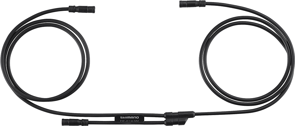

is there a junction box with multiple port compatible with drive unit ?!
There is a junction box for the sd50 connectors, it's a JC41E, has four connections, it's tiny , appoximately 12mm wide, 6mm thick and sbout 25mm long, it's buried in the frame so a bit hard to measure exactly.
ok , 1st solution , you sure is working ?!
is there another solution ?! like a smaller Y cables ?!
Yes it works it is just a dumb four way connector, no electronics etc in it.
It is used just to connect up to four cables.
I have used it to connect the derailleur to the display on the handlebars, I didn't really need to, I could have run one cable all the way from the display to the derailleur but it would have been a long run.
