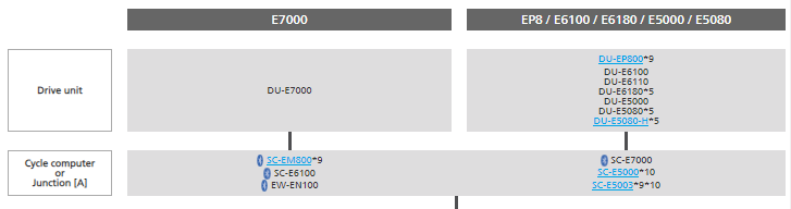

Yep it makes you wonder, since the SC-E5000 is both display and switch! Although it made me check the compatibility, and they are both listed in the same box, so I think it will only let you use one or the other:
Probably yes for number (2) - I'd agree with your thinking, but don't know for sure :)

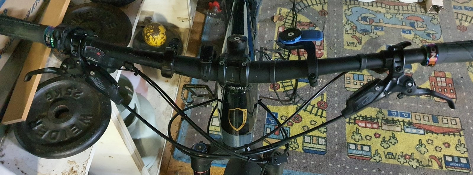

I recently got one of these but my motor cable enters the frame on the left side and the controller is on the left side. Anyone set up theirs like this?
No matter how I route it I can't get it to look good and stop the cable from rubbing on the frame. I've now moved the controller to the right side above my shifter but it just doesn't feel right but it gives the neatest install.

How are you routing the cable from the assist mode switch to the EW-EN100 to the frame? E.g. along the bars or along a brake hose?
In the UK we have rear brake on the left, so that also enters the frame, so it's easy to route the electric cable along the brake hose. Do you have a dropper lever and cable on the left, can you follow that?
At the moment its running along the gear shift cable. I tried running along the brake hose and the dropper lever on the left hand side but it folds back on itself and rubs along the frame.
You could maybe run it along the left brake hose or dropper cable and then switch it to follow the gear shift cable (where those meet), so the junction box stays where it is currently.
Or have the electric cable to the EW-EN100 come out the right side of the frame if there is space - and follow the other cables all the way up to the left side of the bars.

Yeah ideally it would come out the right but can't change it as no room or access.
I tried swapping from a left hand side cable run to the right but the gap widens too much when I turn the bars. I'll keep playing around and see what I can do.
If anyone sees this post and has a pic of left side to left side please post it up

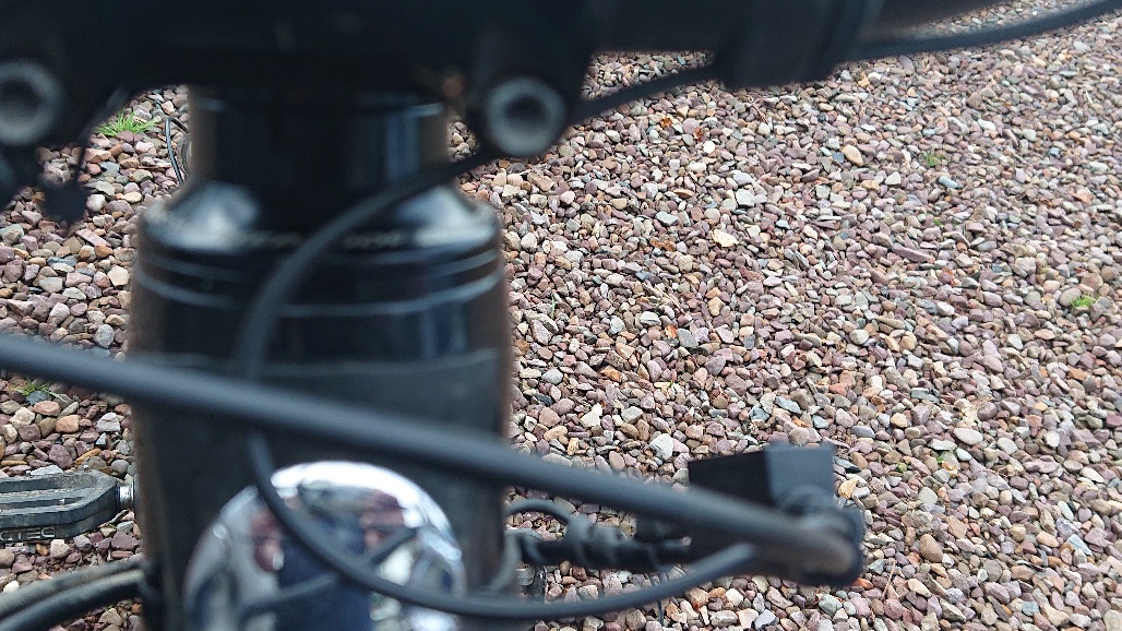

Here you go.
You don't need to run the steps cable along your shifter outer or brake hose. The rubber routing bands are to run it neatly along the bar.
The actual junction unit shouldn't rotate on the hose/cable if you also use the clips one either side of it.
TBH I'm not sure why you'd be bothered about aesthetics with all the accessories you have attached to your bars.

Forgot to ask I looked at the specs it says e7000 e8000 but nothing about ep8??
This page says SC-E5000 display uses the SD50 cable: SHIMANO STEPS Cycle Computer with Assist Switch | SHIMANO BIKE-US
And the EW-EN100 also uses the SD50 cable: SHIMANO STEPS Junction A for E-BIKE | SHIMANO BIKE-US
So you can just unplug the cable from the SC-E5000 and plug it into an EW-EN100.
- The EW-EN100 is compatible with the EP8 motor
