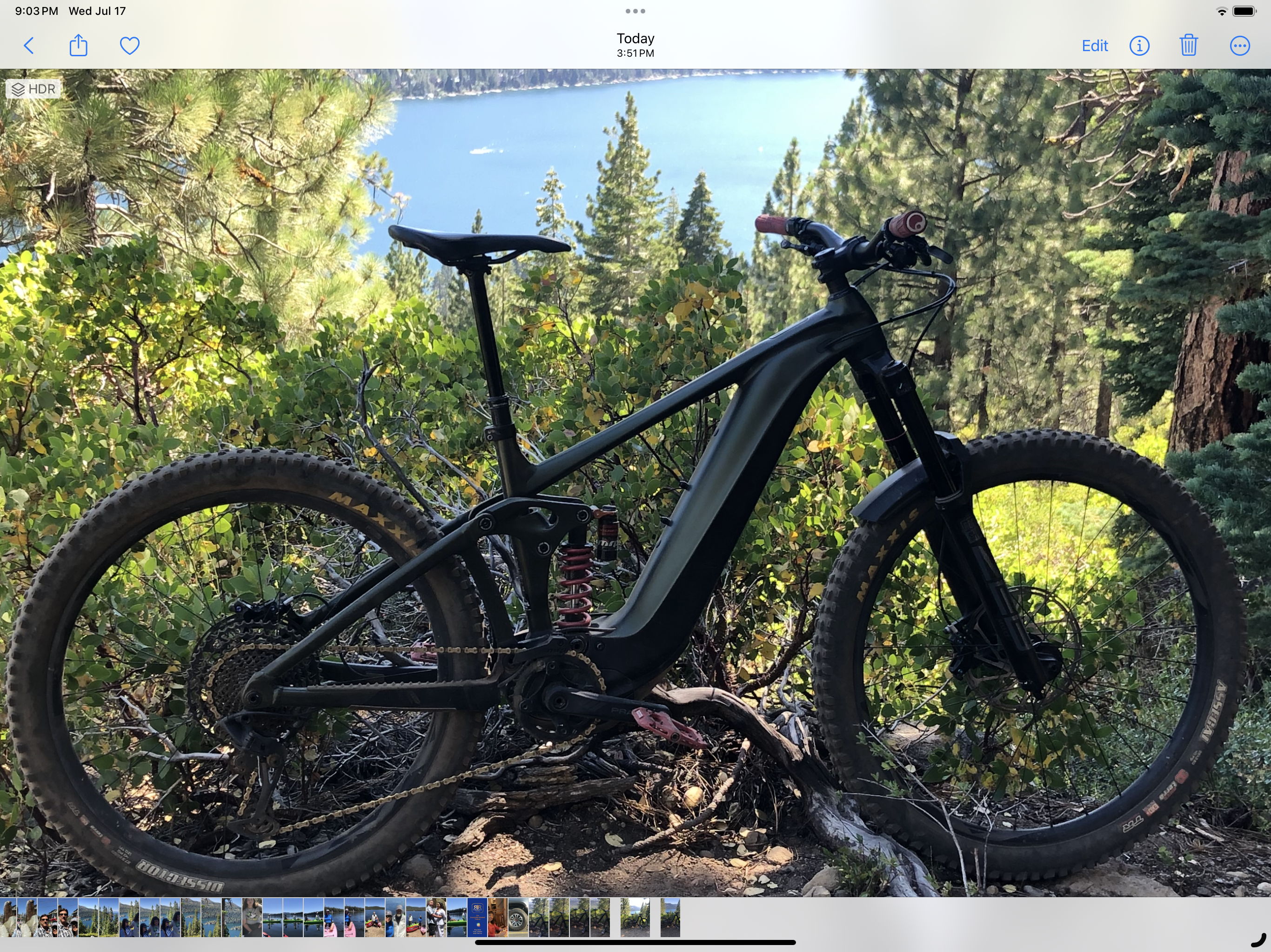

I run a MRP Hazzard with a progressive coil riding weight is 175-180lbs with a 400 spring. Love it I played with it a bit to get it right. I have not touched the settings since.
I ride enduro tracks mostly and still have the OEM wheels with cushcore fr and back I’m getting a set of carbon wheels I’ll ride for more flow/trail riding at the end of season here in Lake Tahoe Ca.
