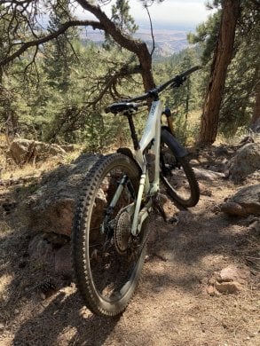

Has anyone else noticed a clicking noise while pedaling, when you just start riding? It seems to go away after a few miles, maybe as the motor gets warmed up. I stopped a couple of times and pulled the left crank at the clamp area, (where it attaches to the crankshaft). I noticed quite a bit of end play. It’s strange, after I pull the crankshaft back and forth, (as you would, to check for end play) the noise goes away even though the motor isn’t warmed up.
My bike is a Rise M10, with approximately 2600 miles on it. A17C1522-DFFA-427B-A2FB-24FCF1320A17.jpeg
