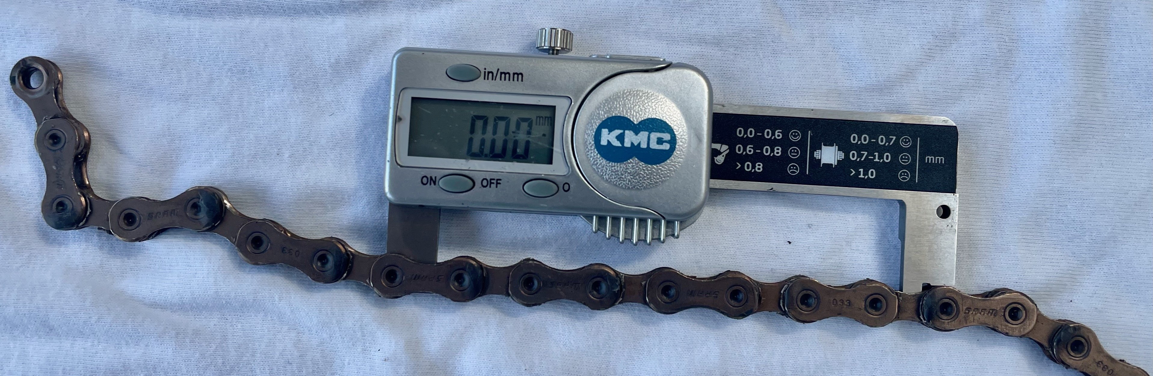

I ride a Cube Stereo HP 140 with similar riding conditions as yourself. Muddy winter, 400kms a month. 62% on eMTB, 13% on Turbo, 22% on Tour+.
My best XX1 chain measured today still 0.0 wear at 1000 km.
In this post I keep things documented if you're interested (I'm running 4 chains on rotation, 2x XX1, XT and Deore.
Total close to 2500km with 3 chains at 0,1% wear, and 1 at 0% wear.
Regarding cost/km, at similar wear level, the XX1 (although more expensive to purchase) is half the cost of the XT or Deore chain per km. But it's still too soon to draw hard conclusions, needs more kms of pedaling to complete the experiment.
