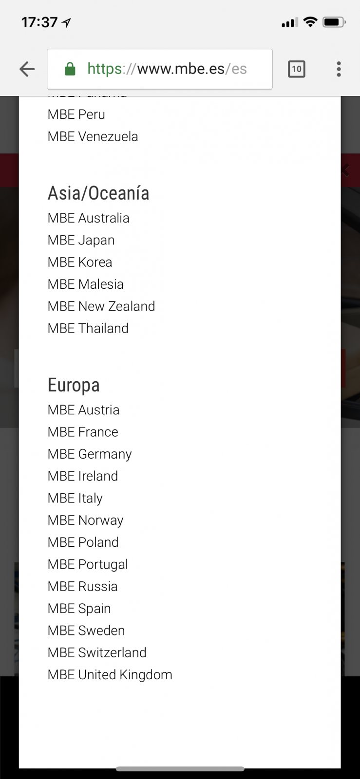

Last trip I did I used MBE to do the shipping dropped the battery at one of their locations and picked it up 3 days later in germany, total cost 119€ mbe.es or mbe.co.uk

Mbe is a step in the right direction, looks like its limited to only 2 countries though?Something through ups would be awesome
actually it’s most of Europe, south America and plenty of Asian countries, no offices in NA thou

Sounds awesome. Can i send .y battery from Bucharest to Oslo easily? I just looked at mbe.co.uk and only listed uk locations.
No RO.. sorry but as they are owned by UPS... ring ups RO? And ship to MBE Oslo?
