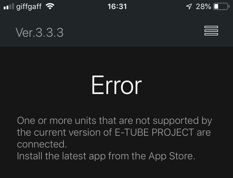

Hi all. Have managed to bag myself a new Vitus Sommet VR ;) Just finished putting it all together and reading all the useful info on the Vitus E-Sommet thread so getting excited to ride once the weather and current injuries permit!
Have managed to work out how to pair my iPhone/iPad but not managing to get any further than that ?. I get the ‘The application was unaltered to detect the bike type.Select the bike type from Di2 (road, MTB or urban) or Steps (MTB) so I select the Steps option and then the blue uploading bar progresses slightly and then stops with “Error - one or more units that are not supported by the current version of E-TUBE PROJECT was connected. Install the latest app from the App Store”.
I’m using version 3.3.3 which appears to be the latest on both iPhone and iPad.
Any suggestions please?
Many thanks

Yep, 3.3.3 looks to be the latest from May 30, 2018.

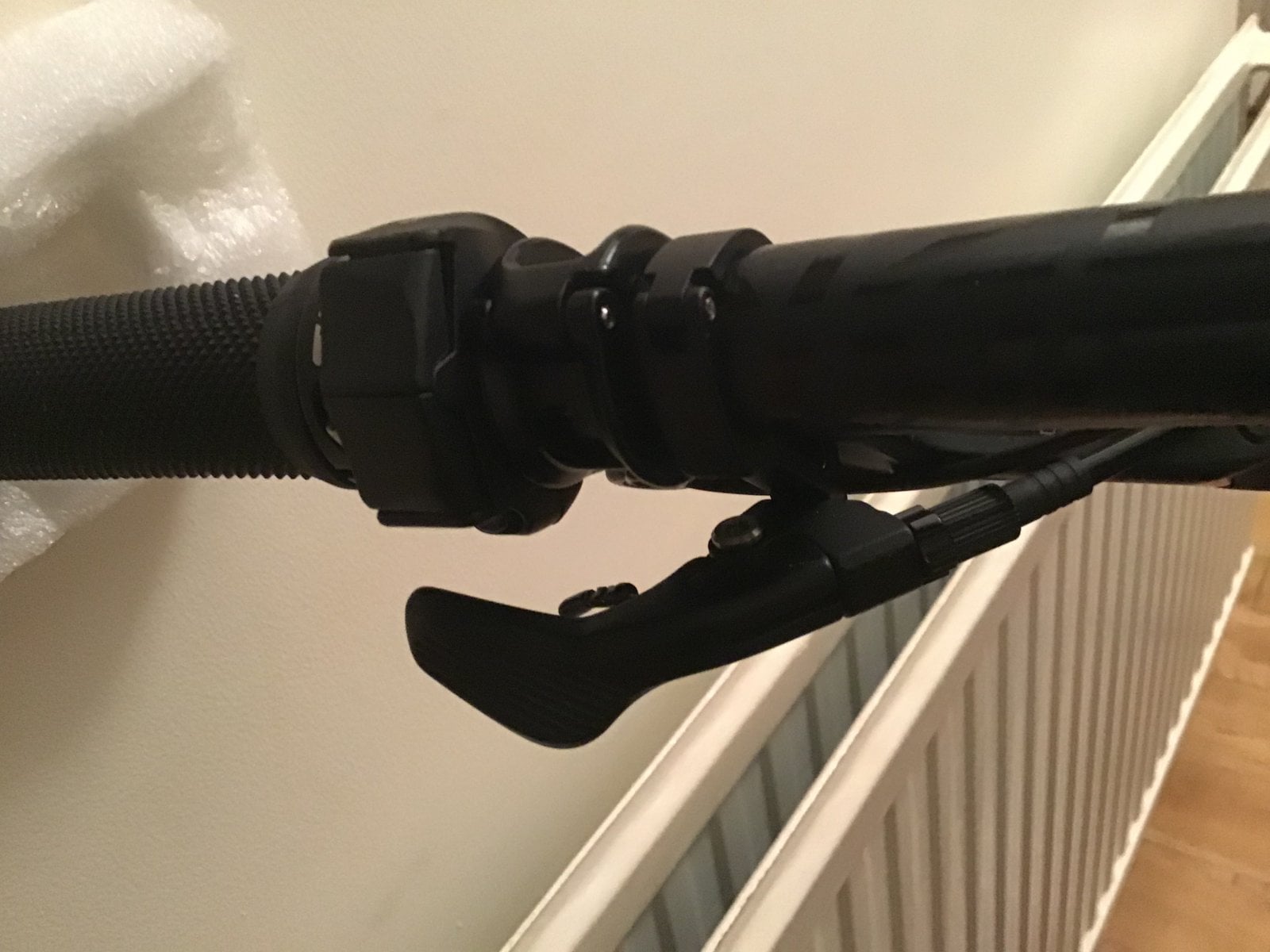

Does the new Vitus have that cool E7000 assist mode switcher on it? Wondering if that could be so new it is not supported yet on that app. So maybe Shimano need to release a newer version?

@mark.ai - yes it does - photo attached

@mark.ai wins the prize I think!
Shimano have confirmed that the E7000shifter is not compatible with version 3.3.3. This will be implemented into the next version with the release date TBC.
So bike set in default ‘dynamic’ assist at moment (Boost = high sub-mode assist and Trail = low sub-level)

You know what might work ... if you disconnect the E7000 shifter from the display and then run the app it may connect. Then change the assist settings, disconnect the app and reconnect the E7000 shifter.
But! There is a possibility this could stop the E7000 shifter from working - I can't test it here, so it's up to you if you want to try it ... Definitely don't update the firmware without the shifter connected, just in case.
Maybe you could check with your Shimano contact if the above procedure is safe to do before trying it.

So I just updated mine to latest software, and In order to do it I had to plug back in the old controller otherwise I got an error message. So I plugged in an e6000 controller, did the update which took about 10 minutes, then disconnected the app, unplugged the E600, plugged back in the e700 and all works.
It would seem they have not sorted the app compatibility with the e7000 controller yet

I have the 2019 VR with the e7000 switches. I downloaded version 3.3.3 of the E-TUBE app. When I started it it told me that a new firmware level was available. I connected to the e8000 but I get this message.
I have an iPhone 8 with iOS 12.1.2. I don't have an any other switches to use in place of the e7000 switches. Any ideas what I can do?
9,185
Thats the same message I got.
I have now figured out and tested a workaround.
If you unplug the e7000 controller, you can access the app, and change all the settings etc.
Now the bright sparks amongst you will have figured out that you need the controller plugged in to activate the bluetooth connection!
So what you have to do, is activate the bluetooth connection on the bike, then unplug the e7000 controller, they connect with the app. App connects fine, but instead of the usual 3 items its shows up (controller, motor, battery) it just has motor and battery - you can access the motor customisation etc etc.
I also tried plugging in the e7000 once the app had connected, and this didn't disconnect it or do anything weird, but the controller didn't show up on the app.
Bare in mind I have already paired my bike with the app some time ago, so dont know how this would affect a first time connection.
When you have finished just disconnect via the app, and then plug the controller back in
Voila!
