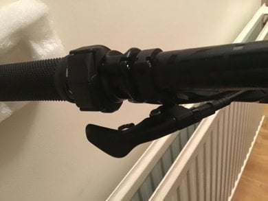

Does the new Vitus have that cool E7000 assist mode switcher on it? Wondering if that could be so new it is not supported yet on that app. So maybe Shimano need to release a newer version?
Its should be supported on the app, updated mine yesterday, though this was done via the PC software at a bike shop

@mark.ai - yes it does - photo attached
