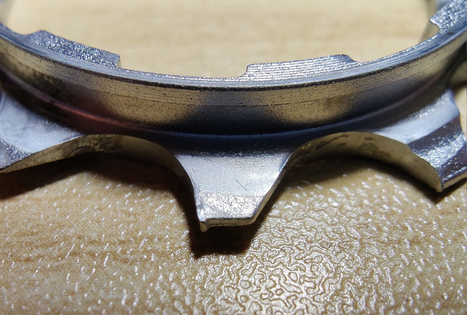

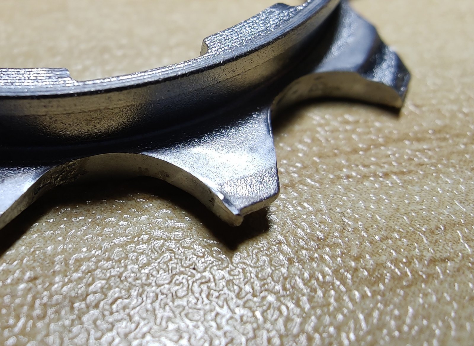

Saying I can easily wear out 11T, 13T cogs with E-bike under 500 miles. The average speed is 30mph of every 50 miles. Is it fast?
Also, by the time the cog is done, the chain isn't even stretched beyond 0.5mm, but the chain is changed somehow. So it means another new chain and new cogs.
Just don't have durable drivetrain. Anybody feels the same way (at high average speed of course)?

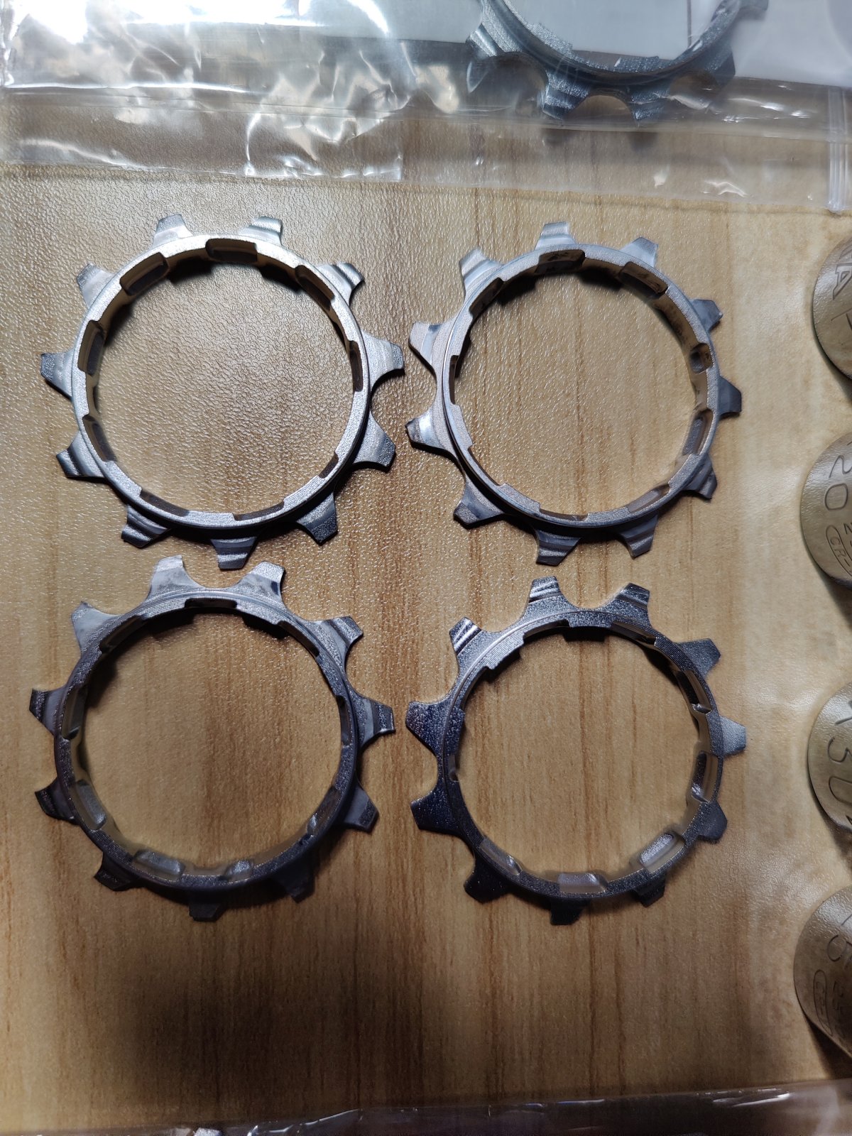

Not even need to be round. A slightly scratch of 0.2mm wear on the tip of teeth will cause skip during high-torque. They should've use tungsten on the tip of 11T, but nowadays small traditional cycling manufactures like Shimano always prefer trendy light stuff.

Sort of a mute point until you persuade a manufacturer to make tungsten cassette sprockets.
But even if you do...
11t cassette sprockets skip when worn because there are only 5 teeth in contact with the chain in the first place. Add to that the shifting profiles designed into the sprockets and it stands to reason when your chain wears it will slip under high load.
Under the sort of torque you seem to like using you'd be far better spreading the chain load over more sprocket teeth. And at the speeds you say you ride at this would require a much larger chainring of 50t+
