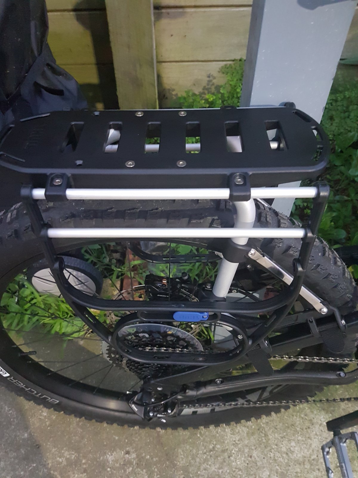

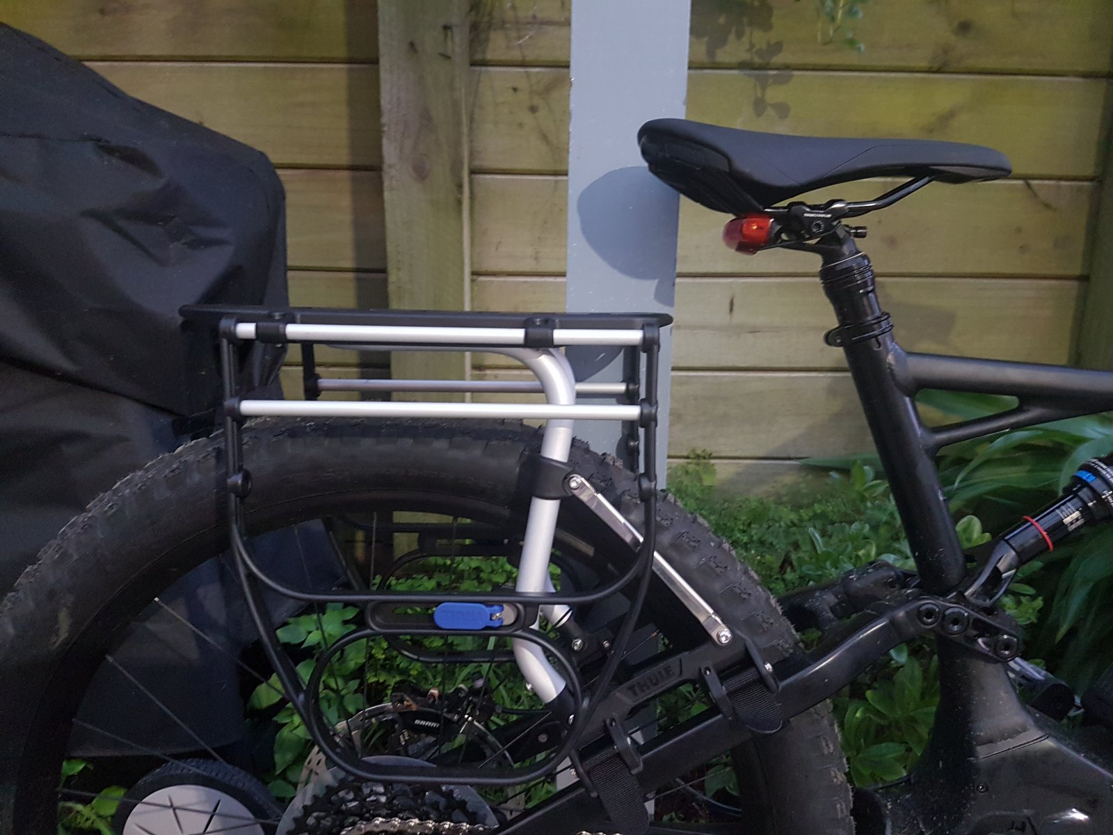

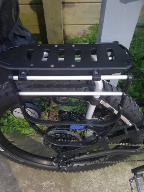

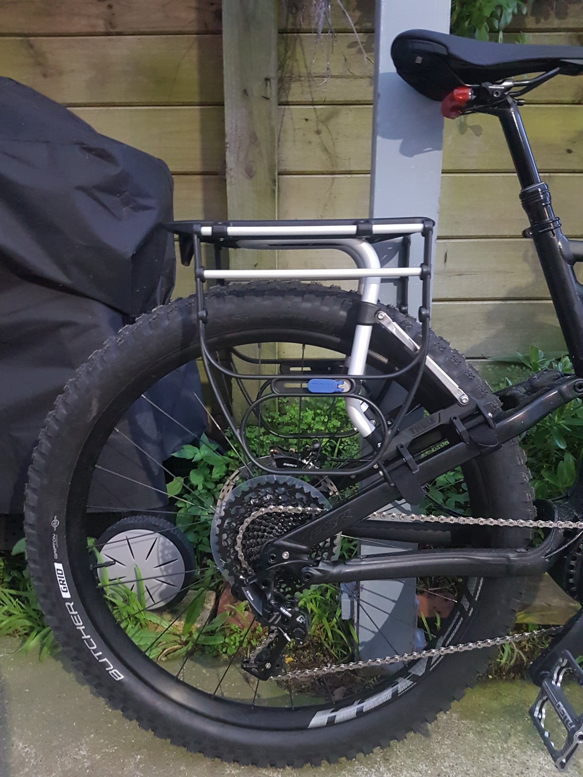

Some more pictures of the rack and bike are below. The only thing that you need to be aware of is that with the dropper fully down if you bottom out the shock you'll also bottom out the back of the seat on the top of the rack. I don't do any jumps on my commute so don't worry about it. Plus if the seat is left just a bit higher then it doesn't clash at all.

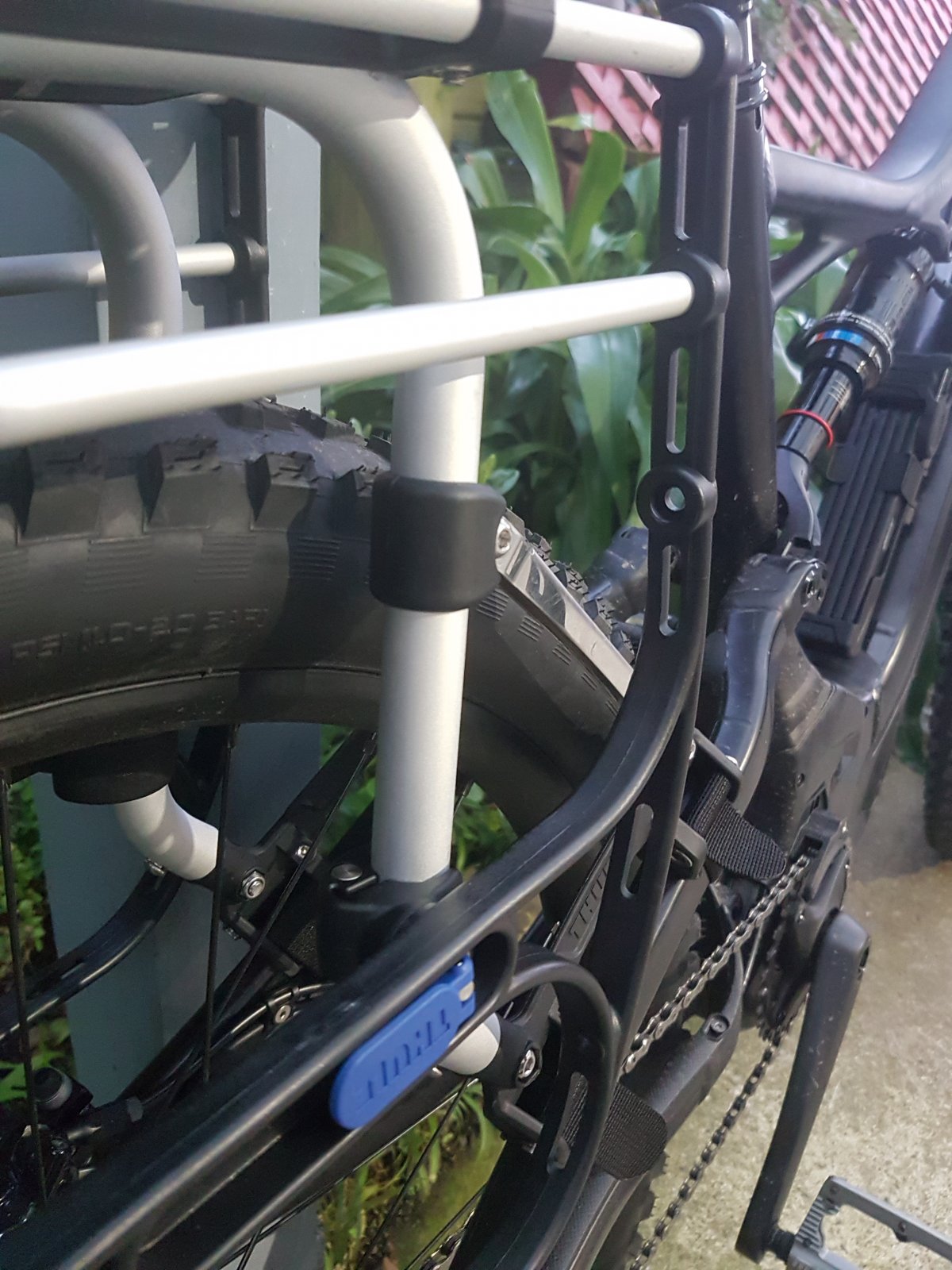

The blue tab is the location of the retention clip which attaches to the rack's vertical upstand.
You can see the side frame clip attached to the rack's vertical upstand.
Another shot of the clip.

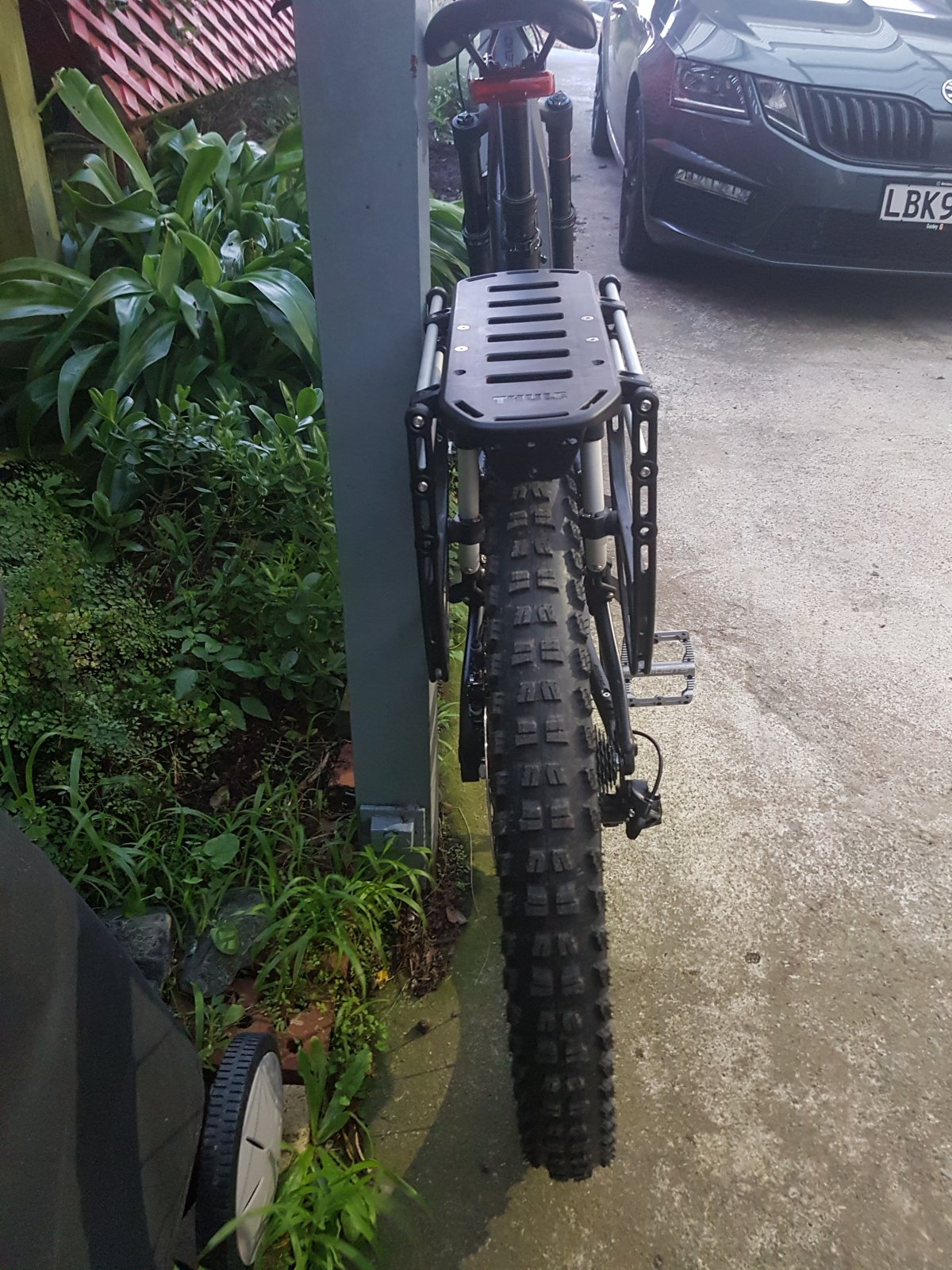

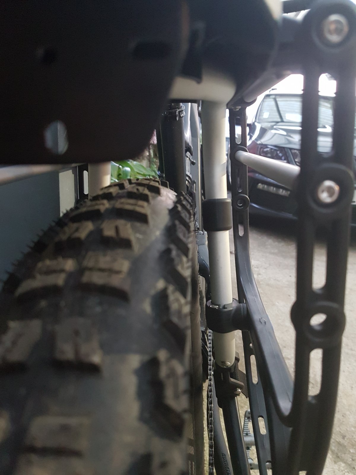

The clearances on either side aren't generous, but it works.
I haven't measured the space on each side between the tyres (Butcher Grid 2.8") but it's about 5-8mm I guess.
Seat bottomed out with no load on the bike.
Removing the rack and side frames involves unlocking the retention straps on the rack which go around the seat stays. There are two on each side and the removal process takes as little as a couple of minutes.
To put the rack and frames back on there is a bit of fiddling to get the straps back around the seat stay, but once they're lined up (I put some alignment marks on the frame) then it's as easy as threading the strap through a slot and using an allen key to tighten them up.
