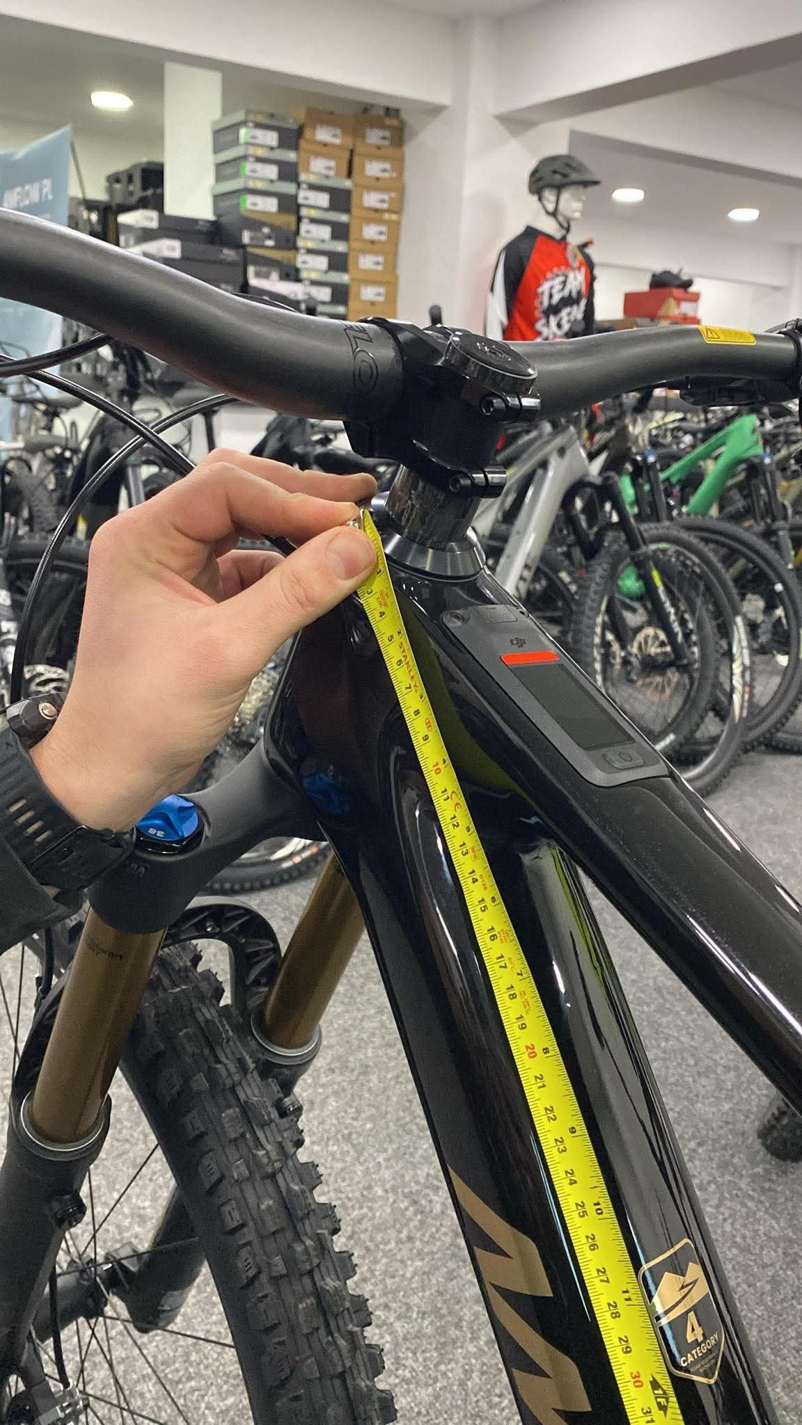

The Vala, on paper is 'slightly' bigger, and I've measured my Large Amflow and what I get is exactly as published
Reach and top tube length are 2mm longer on the large Vala on the charts but get a tape out and sit on both and the Amflow comes up shorter by 17mm shorter on the top tube length and 10mm shorter reach.
The XL Amflow measures 10mm longer in reach and the same top tube length as the large Vala.
Again it’s not a problem obviously if the bike fits you but as I keep saying imo if your on the edge of sizing then you need to 100% try it as large is definitely small in reality.
There so many posts on it on the Amflow Community Official FB page. loads of people who tried a large felt it was to small.
Ian Richards who had a fair few bikes and uses YouTube said the same , smallest large he had ever had, Sam Sams Ebikes also saying it. I have tried both and would also agree. Nothing worst than buying a bike and finding it’s slightly to small so hopefully people will do there homework and try both if they’re on the edge. 👍

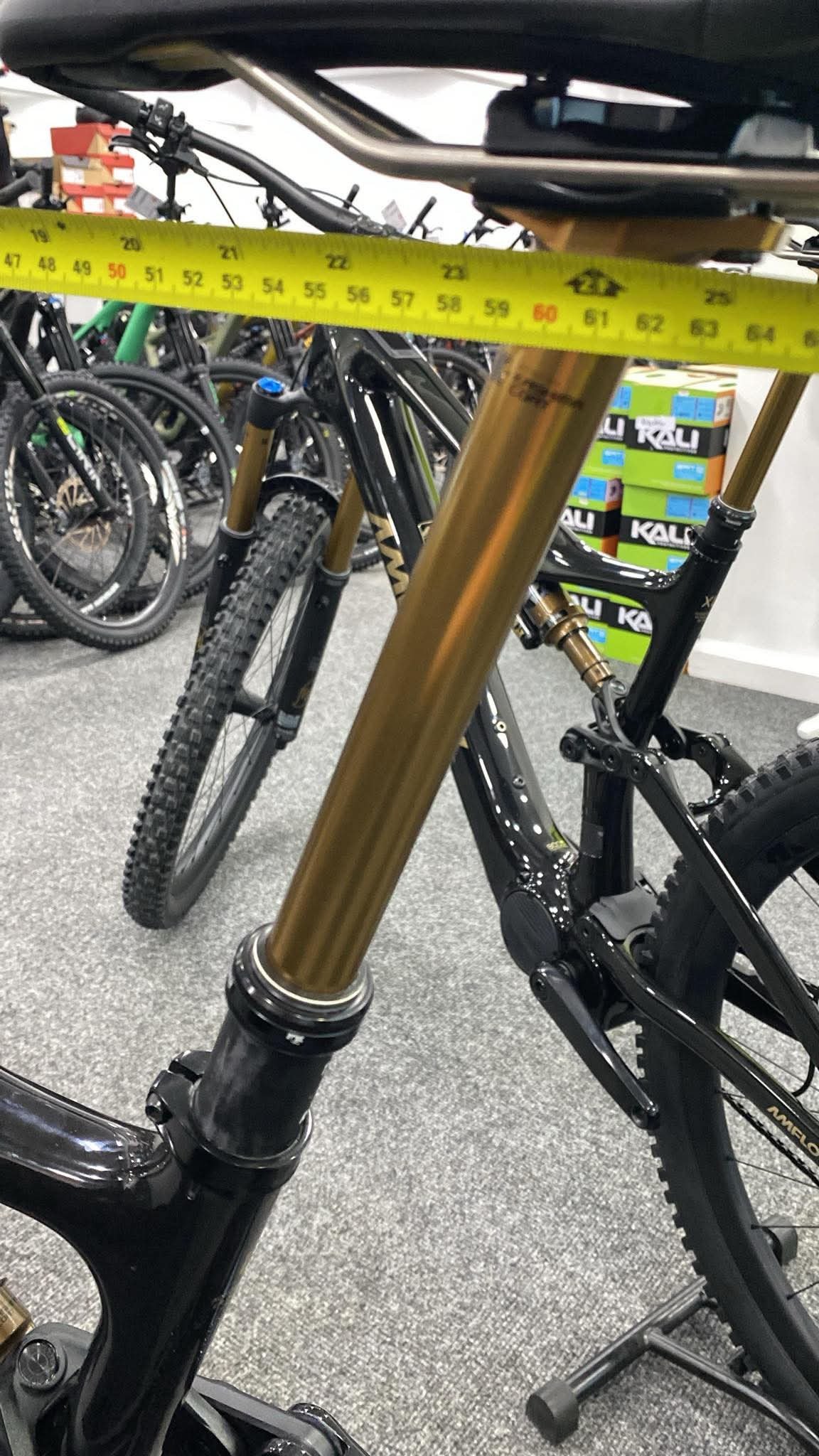

You can crudely but if you have a reasonably good eye measure the top tube length with a tape , from the middle of the steerer tube as it meets the top of the frame across to the centre of the seat post with it up and the tape level on the Large Vala measured exactly what the charts say 622mm , large on the Amflow measures 605mm and XL Amflow measures ironically 622mm
Also if you measure from the same centre spot on the steerer down to the centre of the crank bolt the large Vala measures 805mm and the Large Amflow 795mm with the XL at 815mm

Also reach or effective reach or tho showing the same as the rise and Vala may also be shorter than shown in the charts , going of the SC Vala with 477mm reach that seems to measure the same as its geo chart the effective reach number taken from the centre of the steerer to the centre of the crank bolt is 10mm shorter on the large Amflow than the Vala.
(Obviously this is not how the geo charts measure the reach but you can get a decent comparison measuring this way)

For me the Vala was my point of reference as the rise is for you. Despite what the charts show the reach on the Amflow is 10mm shorter than the Vala and the top tube measurement with both seats at the same height was 17mm shorter making it not an option for me.
You need to know what saddle height manufacturers are using to create the effective seat angle as that's how the effective top tube is measured.
That's why you can't use the real seat angle (centre of the seat post measurement) to compare bikes.
This was with the seat on the Vala at the same height as on the Amflow 👍
To the centre of the seat post with the tape horizontal and flat as per the charts the same as John_A did
