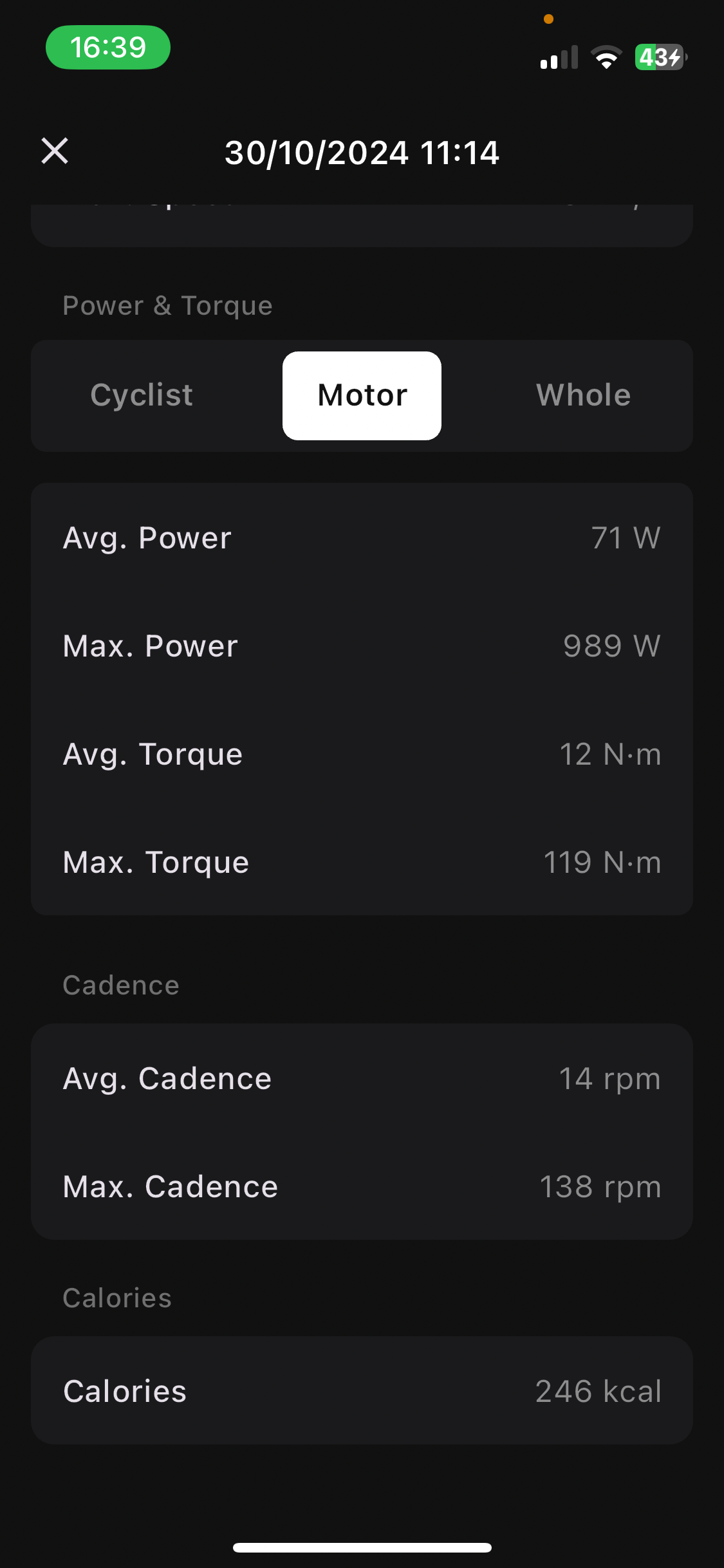

Altho I have ridden my Levo SL on most trails at the Whistler Bike Park, I would not recommend taking a trail bike on most trails there let alone an emtb.
