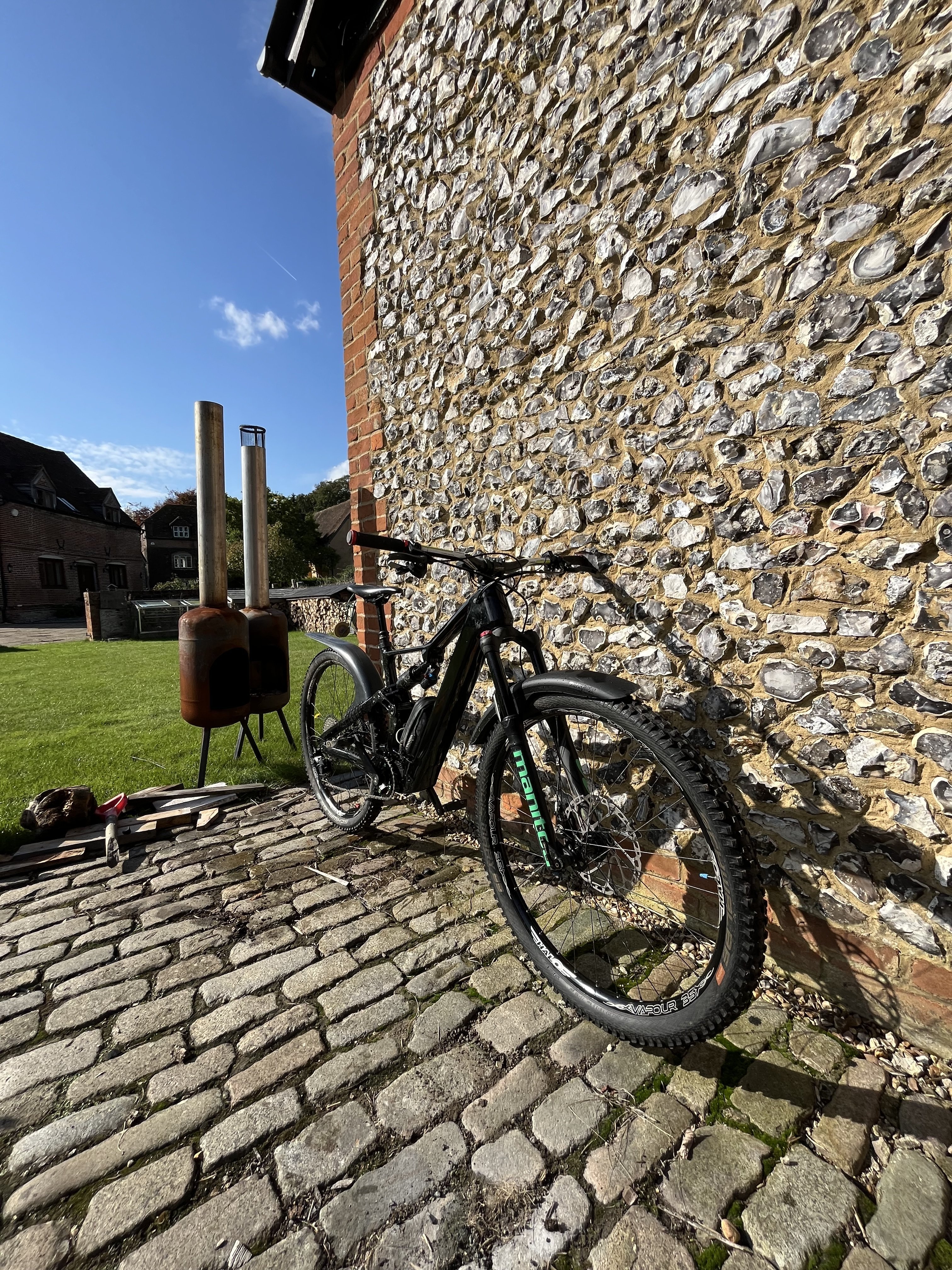

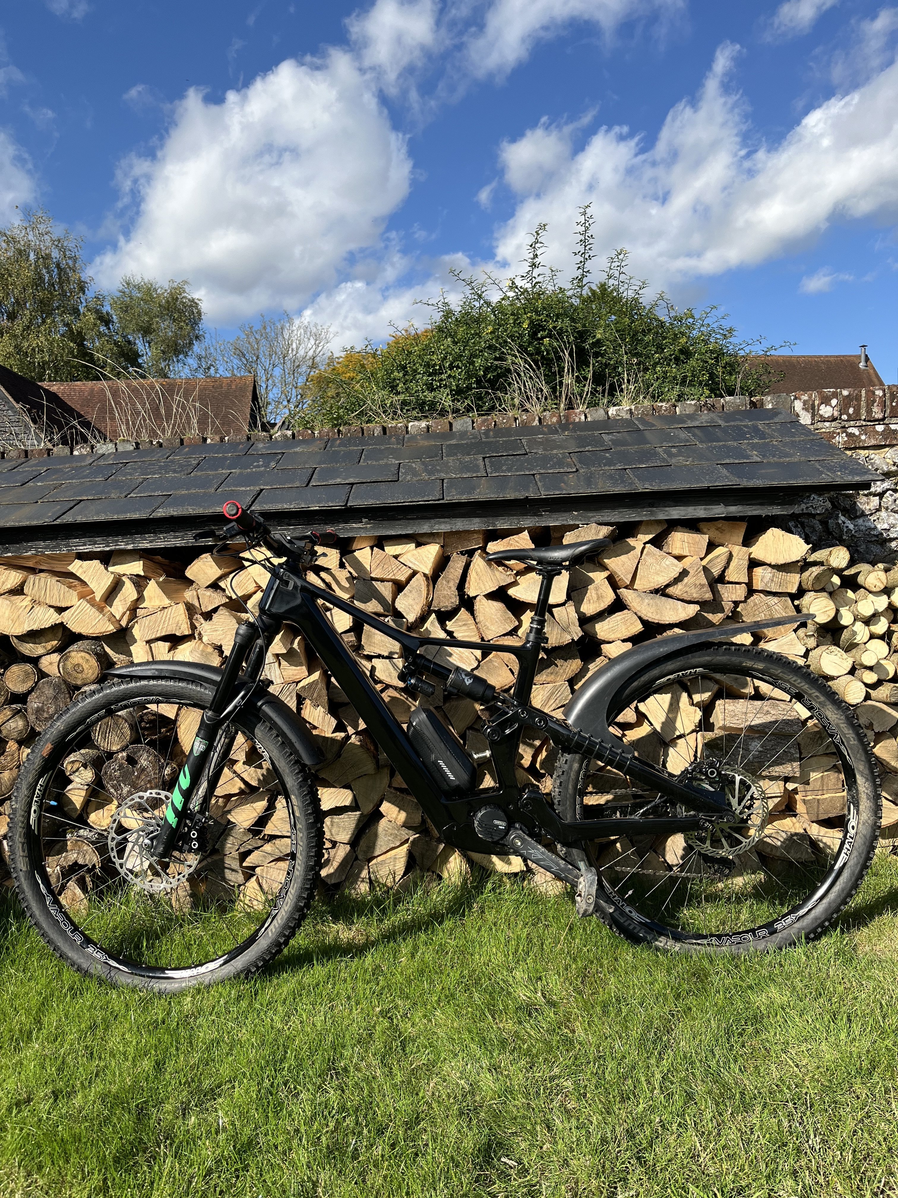

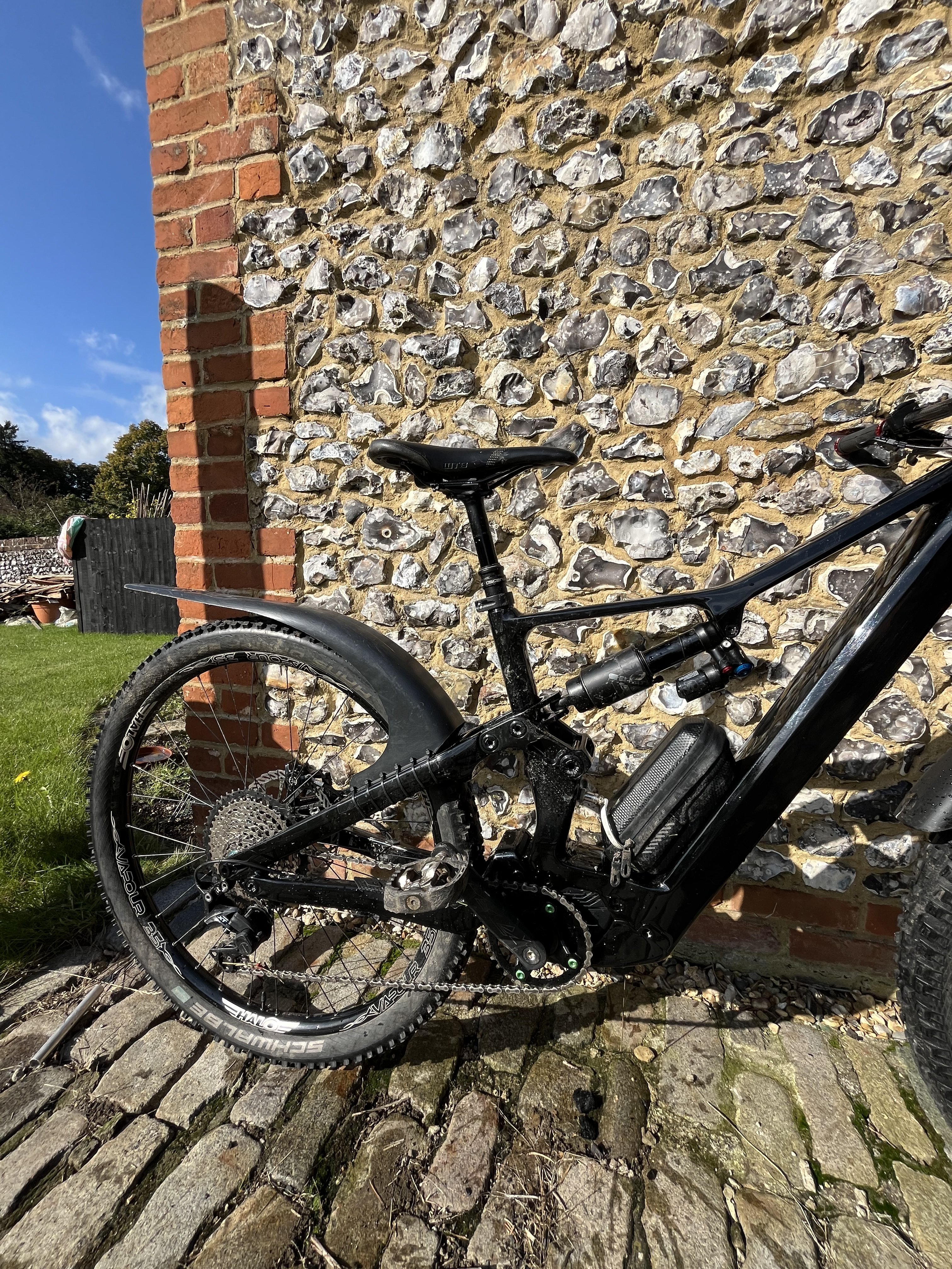

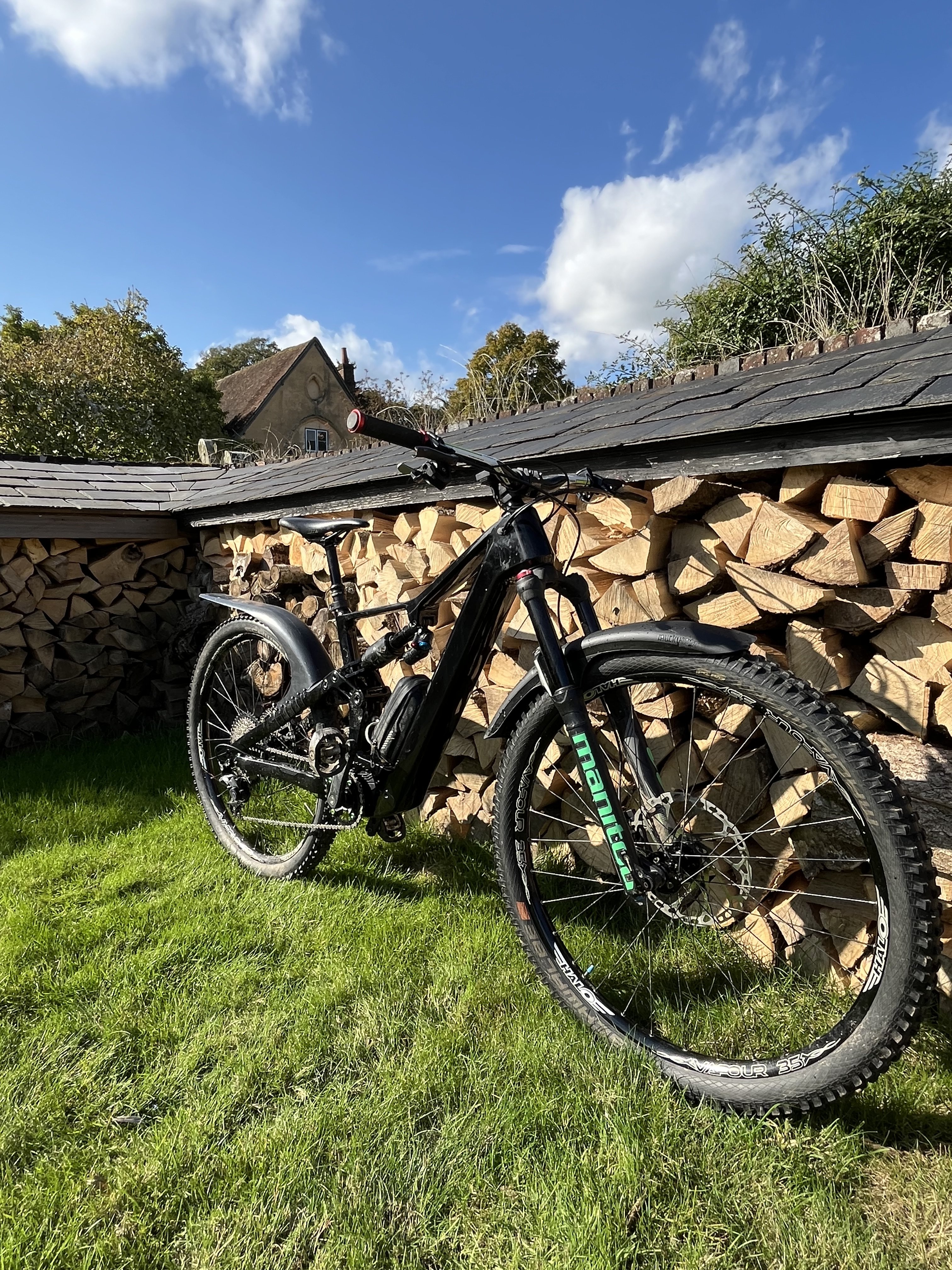

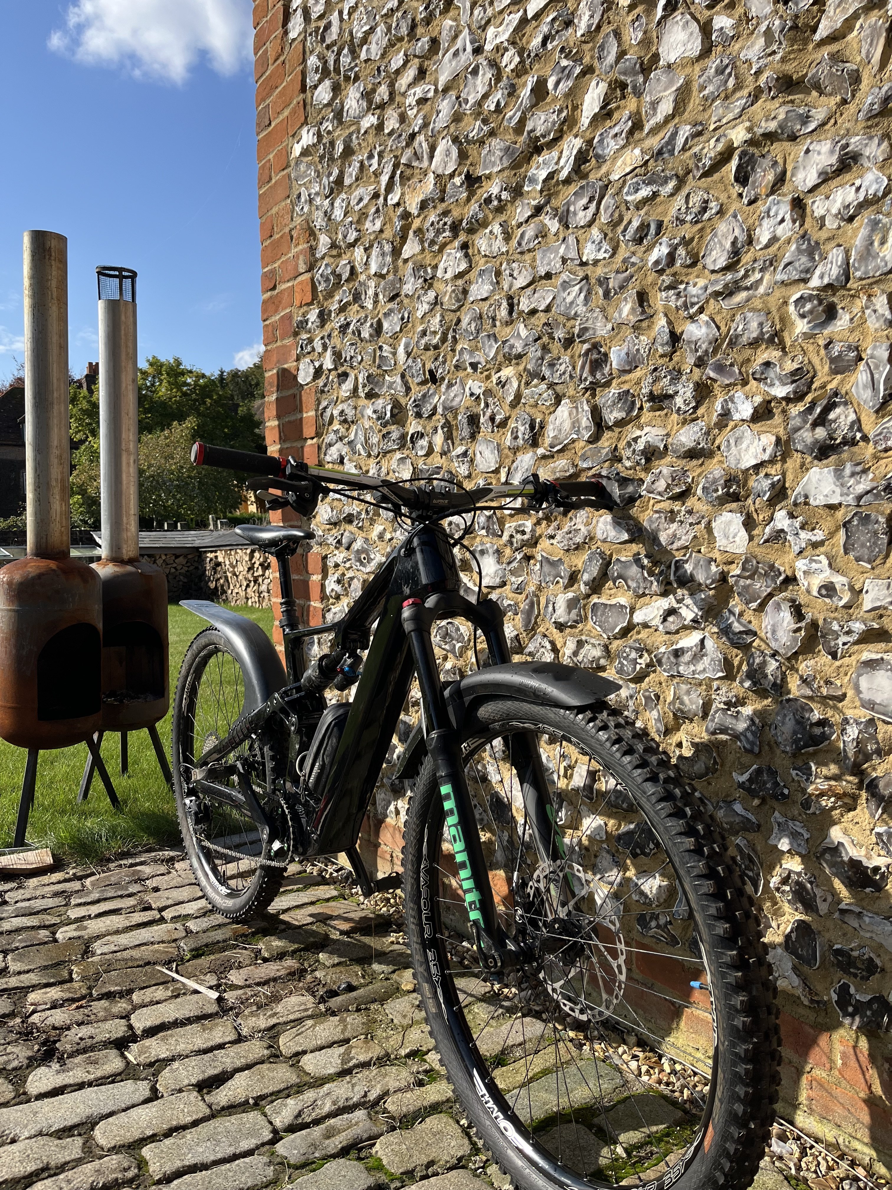

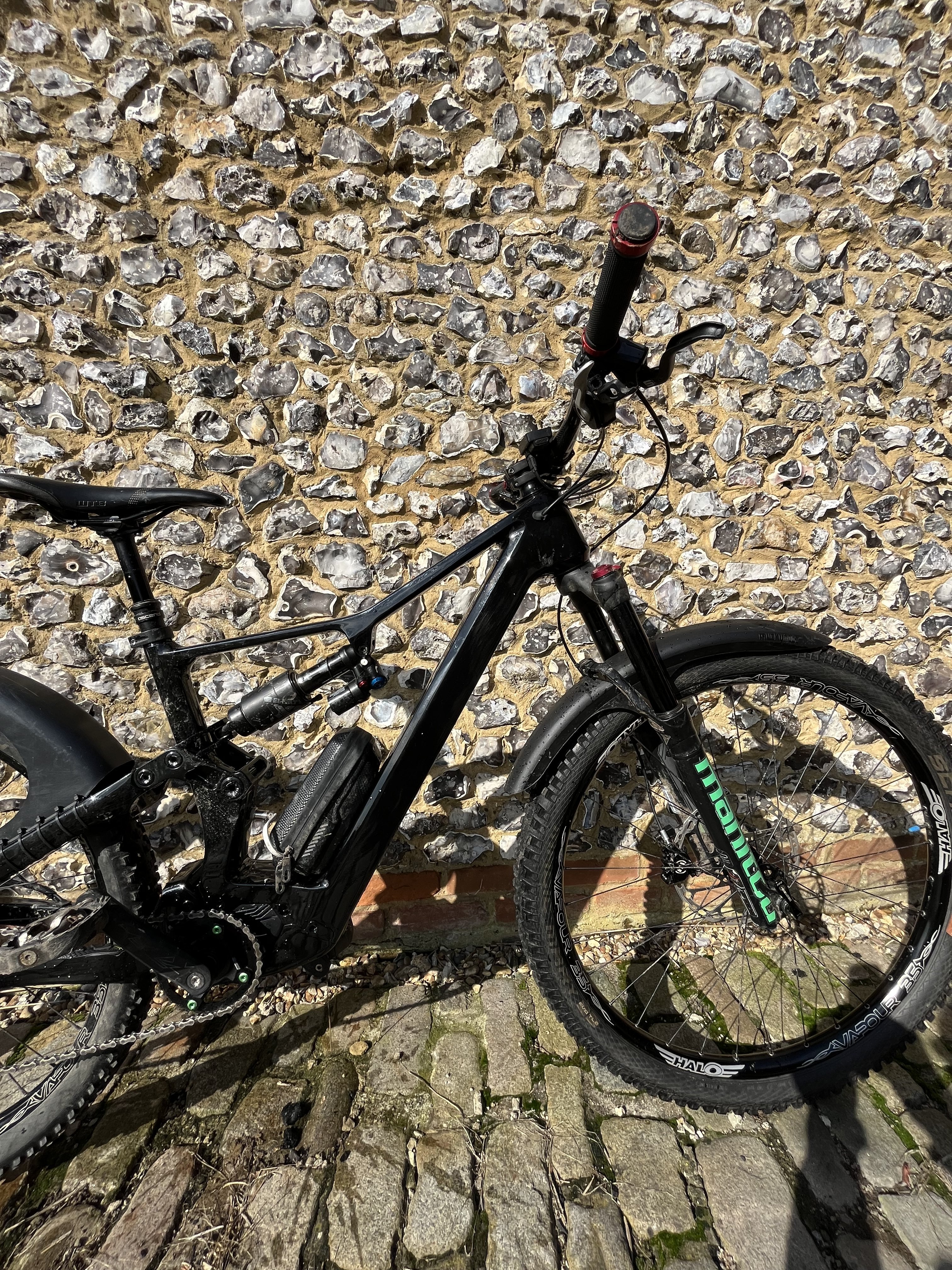

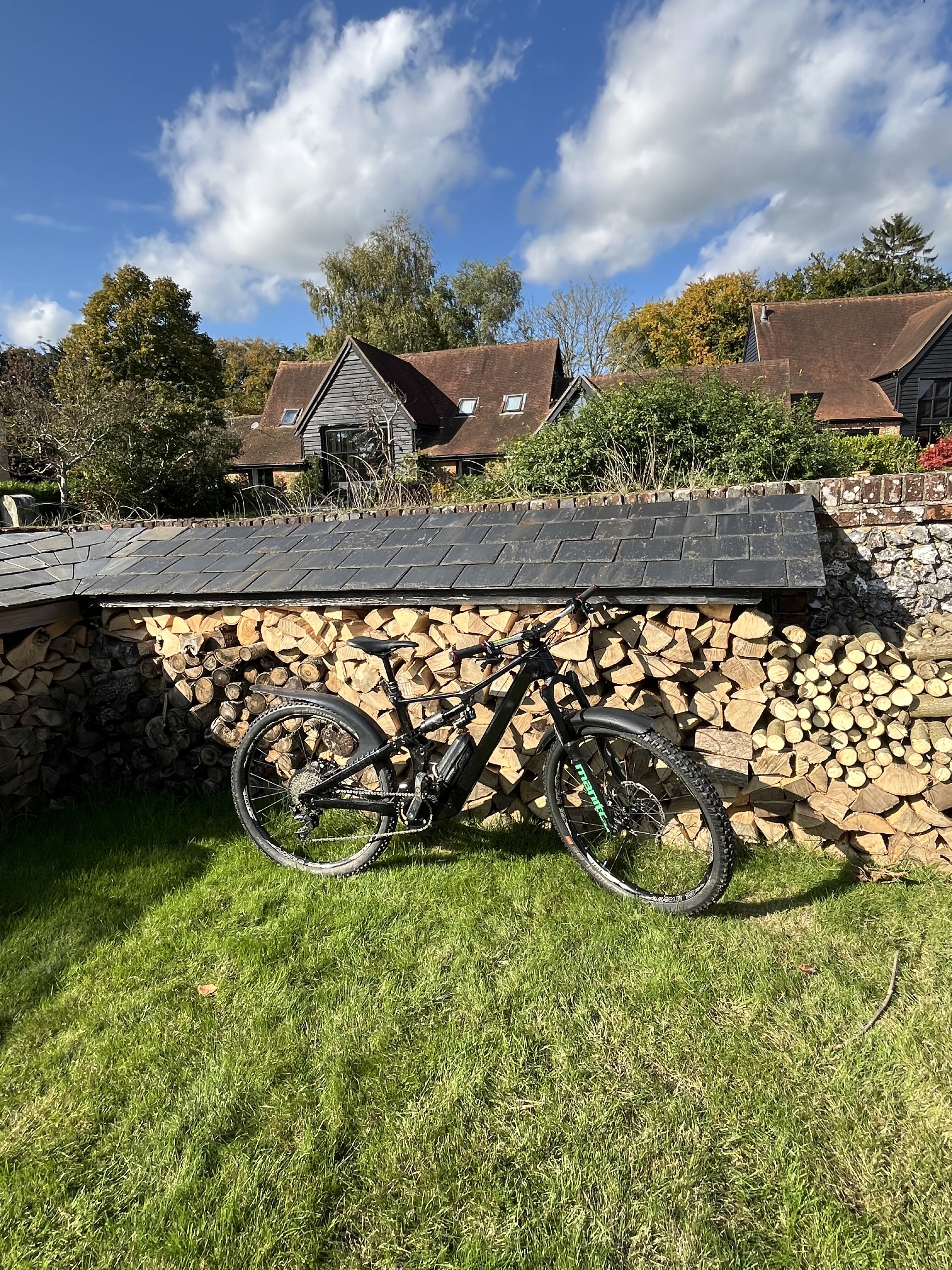

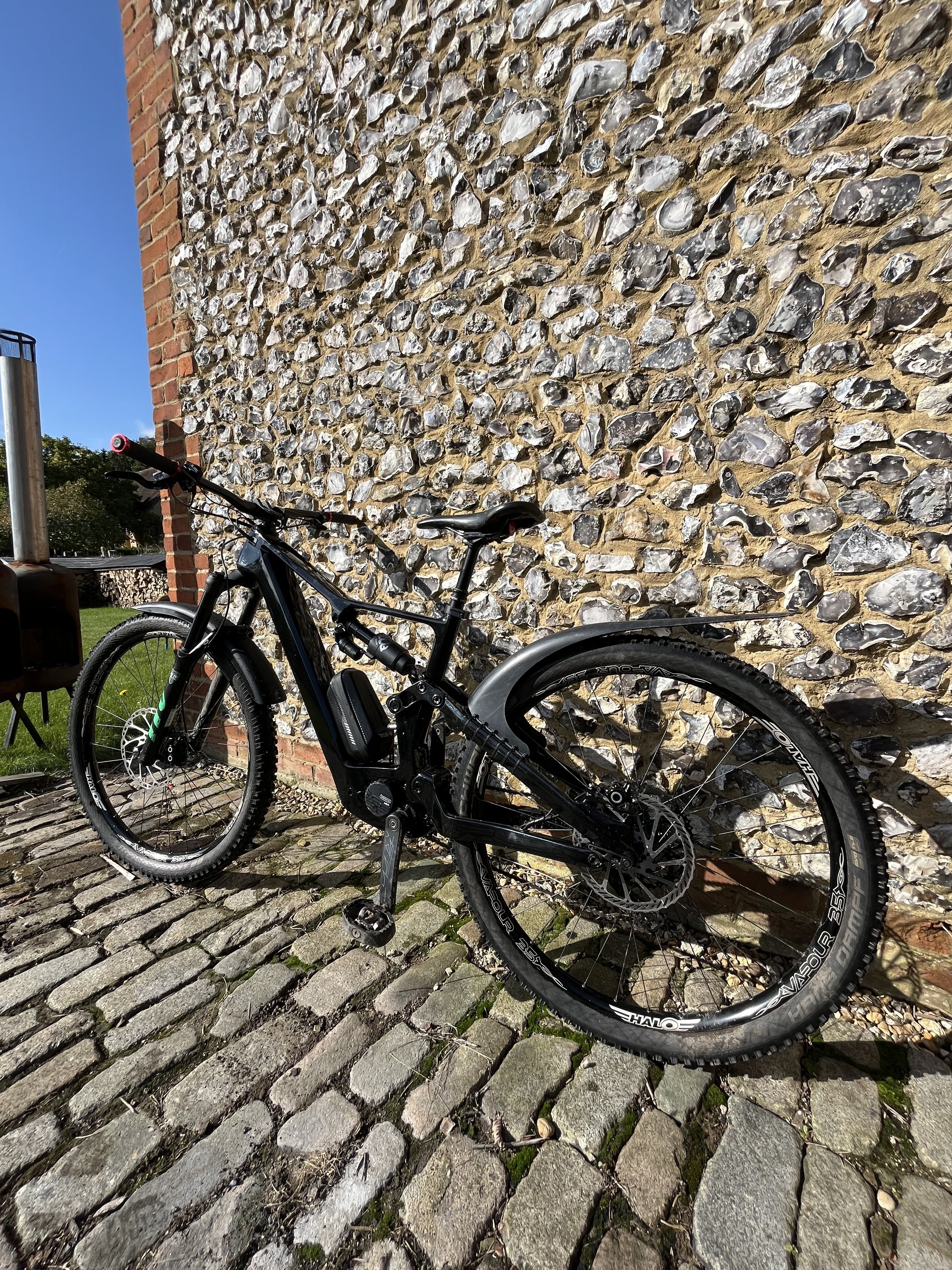

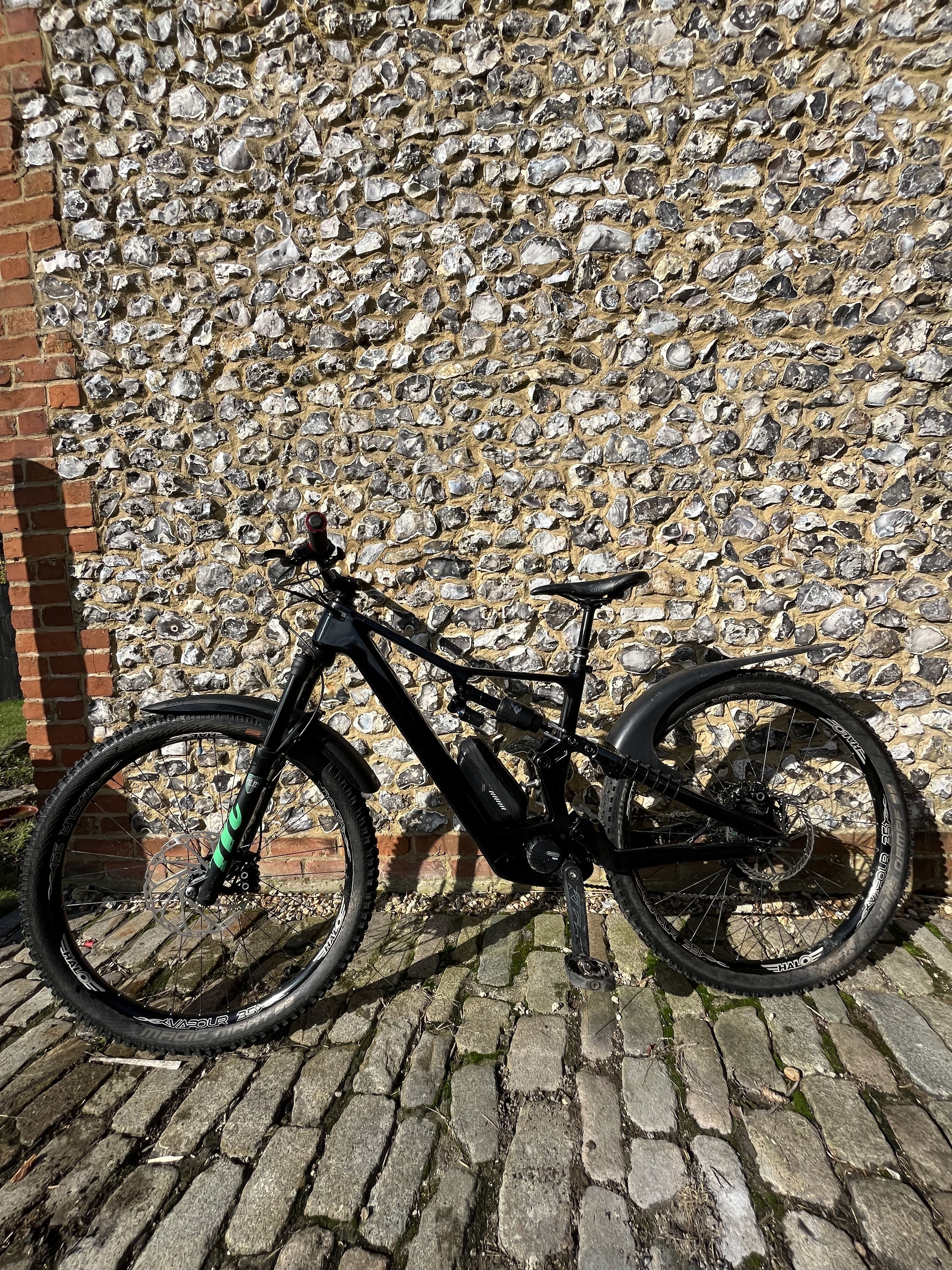

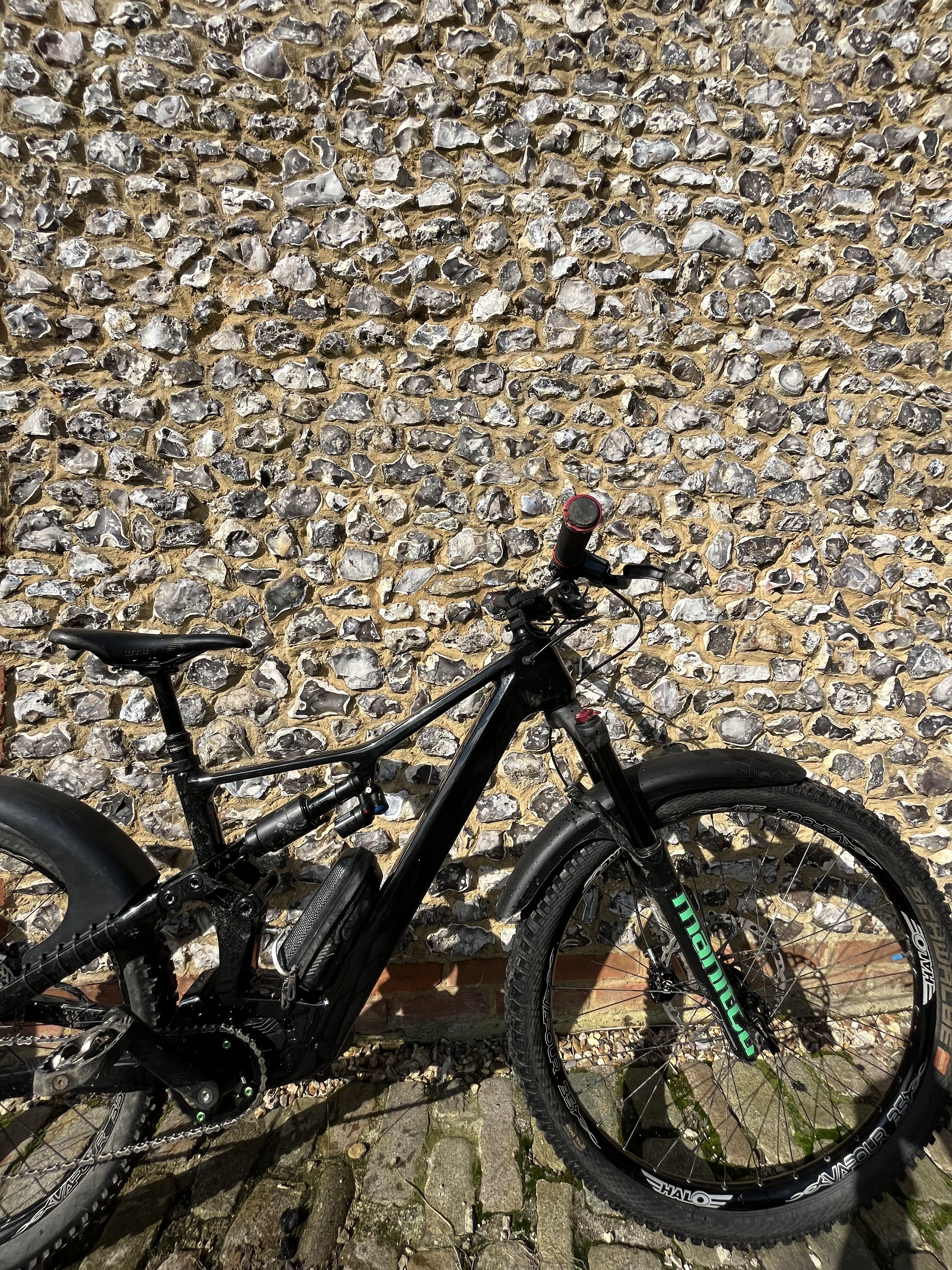

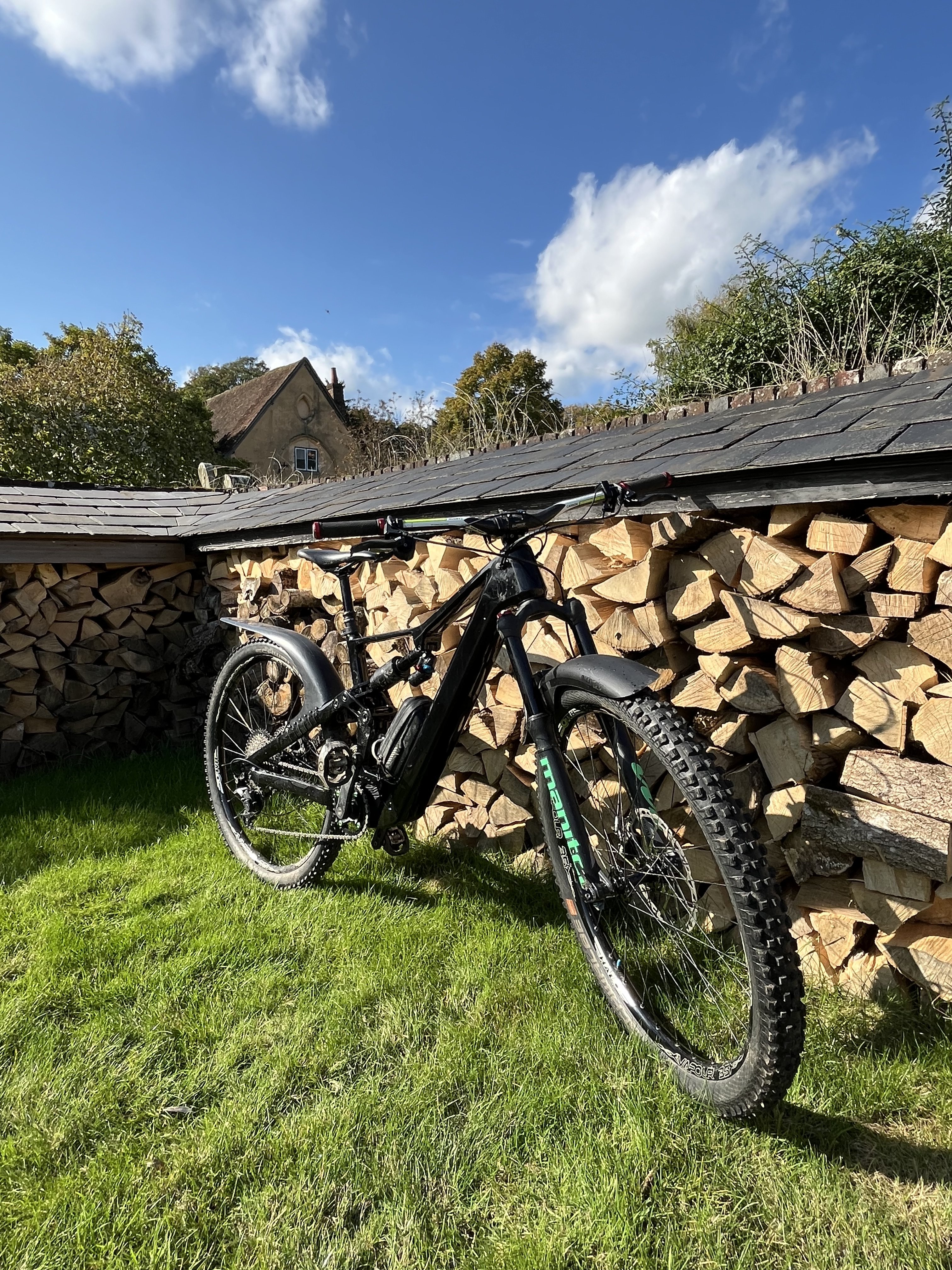

Here's some piccies for you guys.
E69-1.jpg E69-2.jpg E69-3.jpg E69-4.jpg E69-5.jpg E69-6.jpg E69-7.jpg E69-8.jpg E69-9.jpg E69-10.jpg E69-11.jpg E69-12.jpg
You will have to excuse the mudguards, we are now into UK autumn / winter mud and slime trails. Last night was the first long ride as such. I need to sort out the suspension a bit, not much actually as the bike climbs really well in muddy conditions and doesn't seem to mind the downhill ( I need to get used to the much more foward seat tube compared to the E10, its much more upright almost like mtb's of the past but with 160mm of suspension ) motor seems to juuuuusssst be able to keep up with the full fats, feels very light on the trail, seems pretty economical on the battery, lots to like.

The battery is removeable but not easy like say the Trek where simply with a key you can remove and fit another battery in minutes. You don't need to remove the motor but you do need to remove 4 bolts from the lower cover, remove the cover, remove 2 further bolts to slide the battery down out of the tube. In my view that is not an easy change.
In some ways I predicted this in my tick list of reasons to buy the frame, countering this with the ease of where to put an additional battery in the quite large void area above the motor. Thats seems to be the case and having gone down the route of a 500Wh internal battery and almost any size of external battery, that seems to have worked out.
I think with my 62.5 stroke 230mm length shock there is approx. 160mm rear travel. I say approx. as its quite hard to fully measure the movement whilst on a bike stand.
