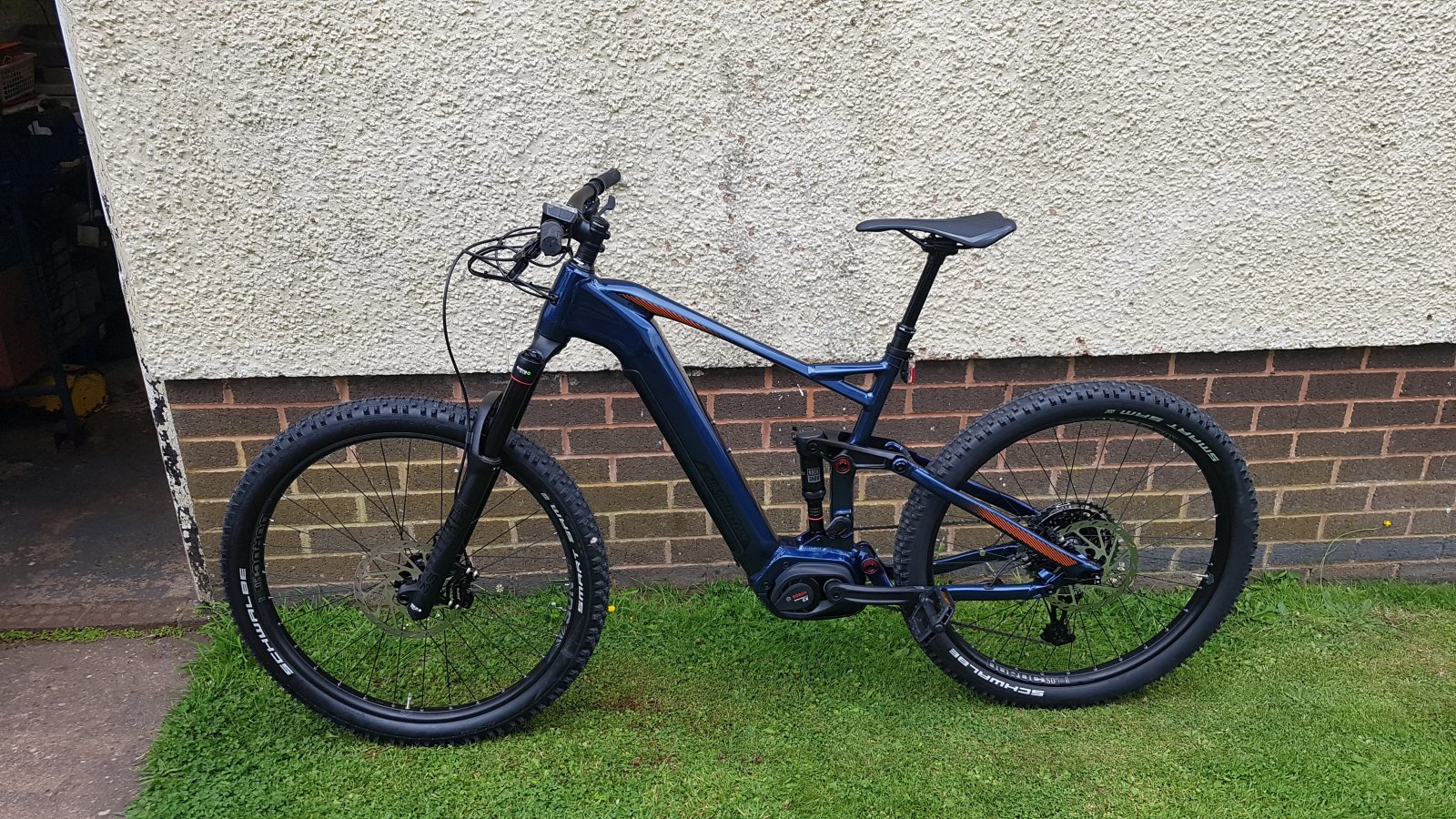

Well it arrived on friday evening :)
spent a little bit of time yesterday fettling.
brakes exercised,bled and calipers centered they are bang on now :)
gear change tweaked and all good now
quick 5 mile bimble and it is a hoot :)
dmr v8's ordered
suspension pump ordered
tubeless valves and fluid ordered
booked in for first week of august for firmware update (first available slot) at local bosch agent currently on du 1.0.2.0
just need to sort mudguards,saddle and grips next.
